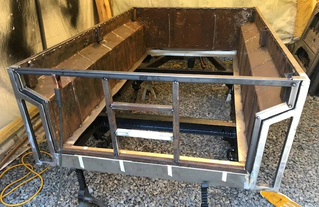

So we have cut off the top round tube frame (mostly because it looked like a tree fell on it and it was pushed down on one side) and replaced it with 1" square tubing. We also framed in new side supports that will hold the tail light panels and are now working on a flush mount tailgate (since our tailgate was un-savable).

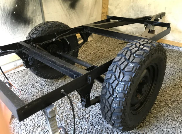

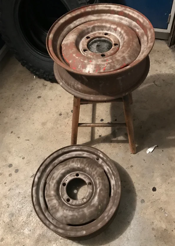

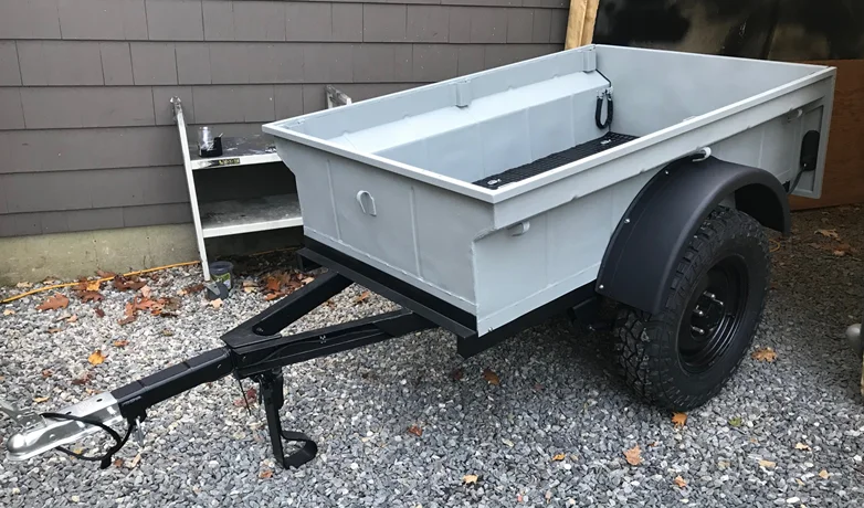

wheels refinished, tires mounted (Cooper SST PRO in 205/85-16):

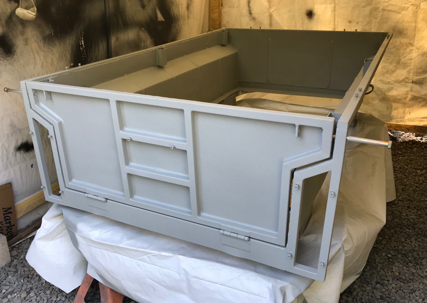

And the tub is back onto the frame:
