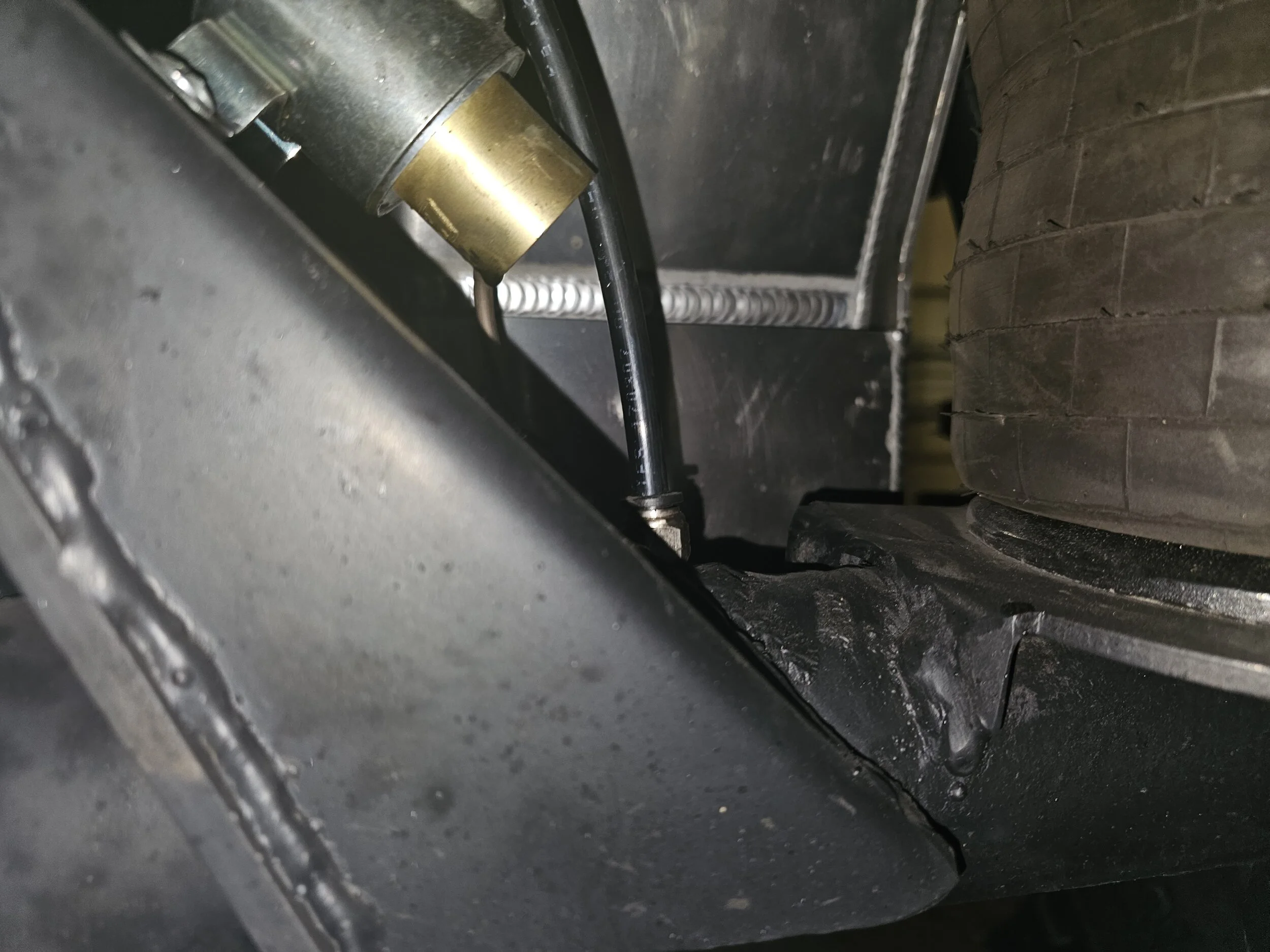

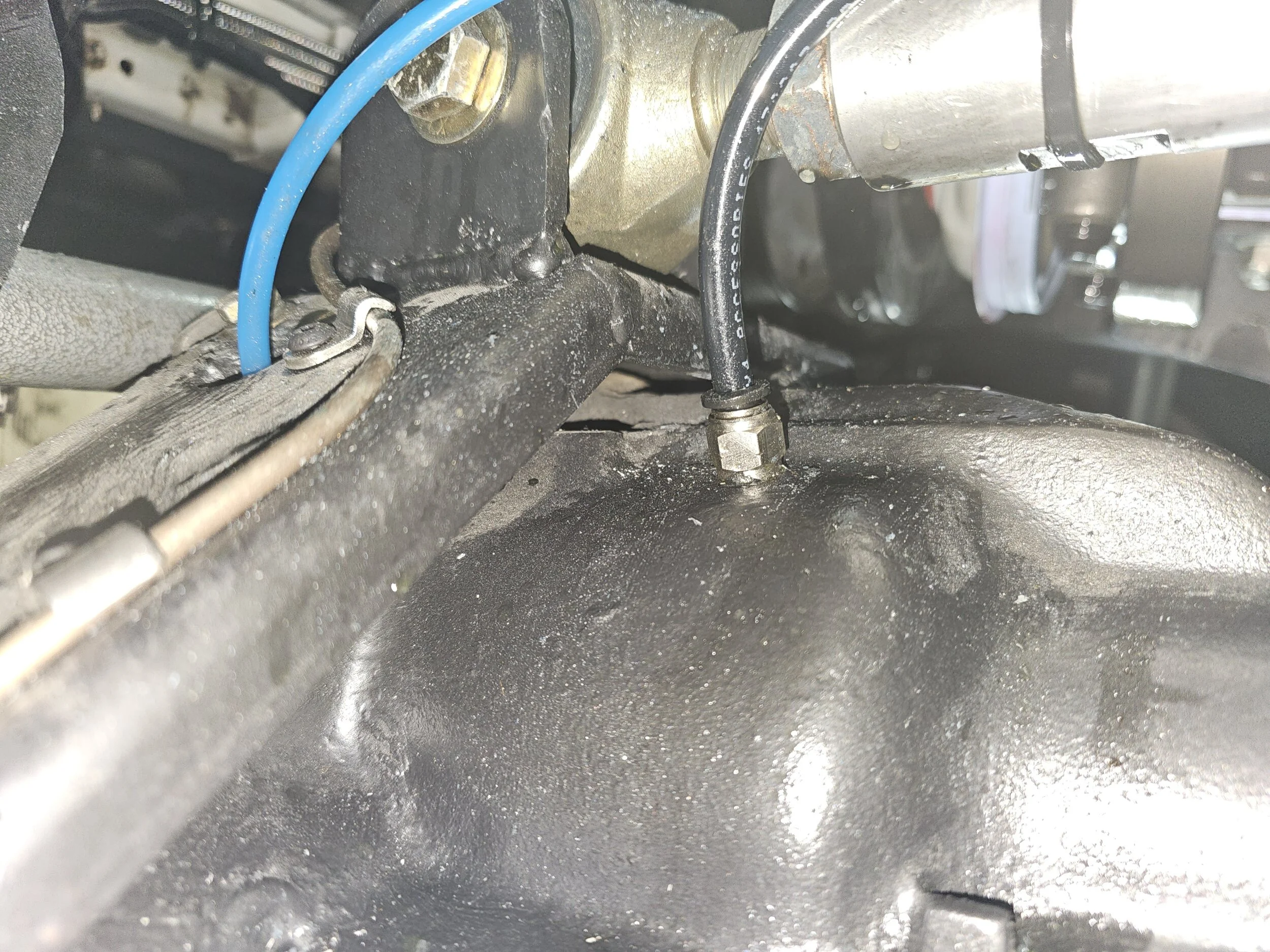

Here's my breather on the front axle.
And on the rear axle

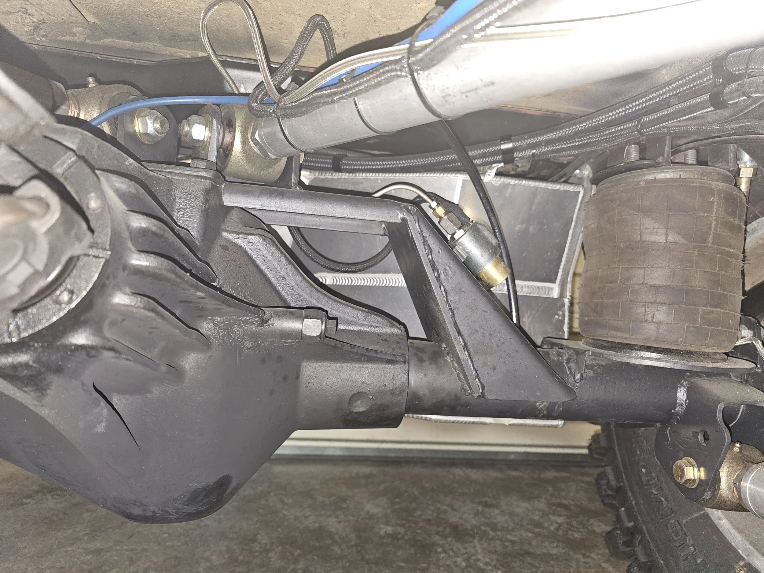

I'm gathering parts to put I high pinion ford axle in the front of my LJ. I looked at the TNT truss, and the New venture truss. At this point I'm leaning toward Artec's jk front spring / shock brackets for the axle side. Just need to figure out a "bridge" over the center section to mount the 3rd link. this will gain about a 2" front stretch.
