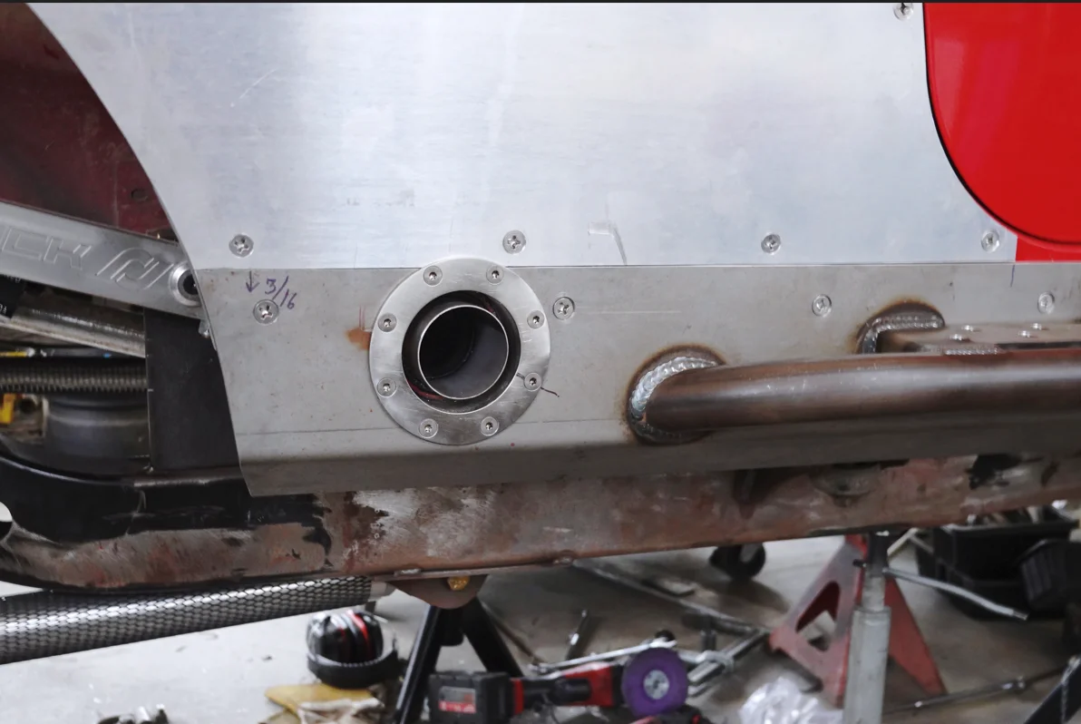

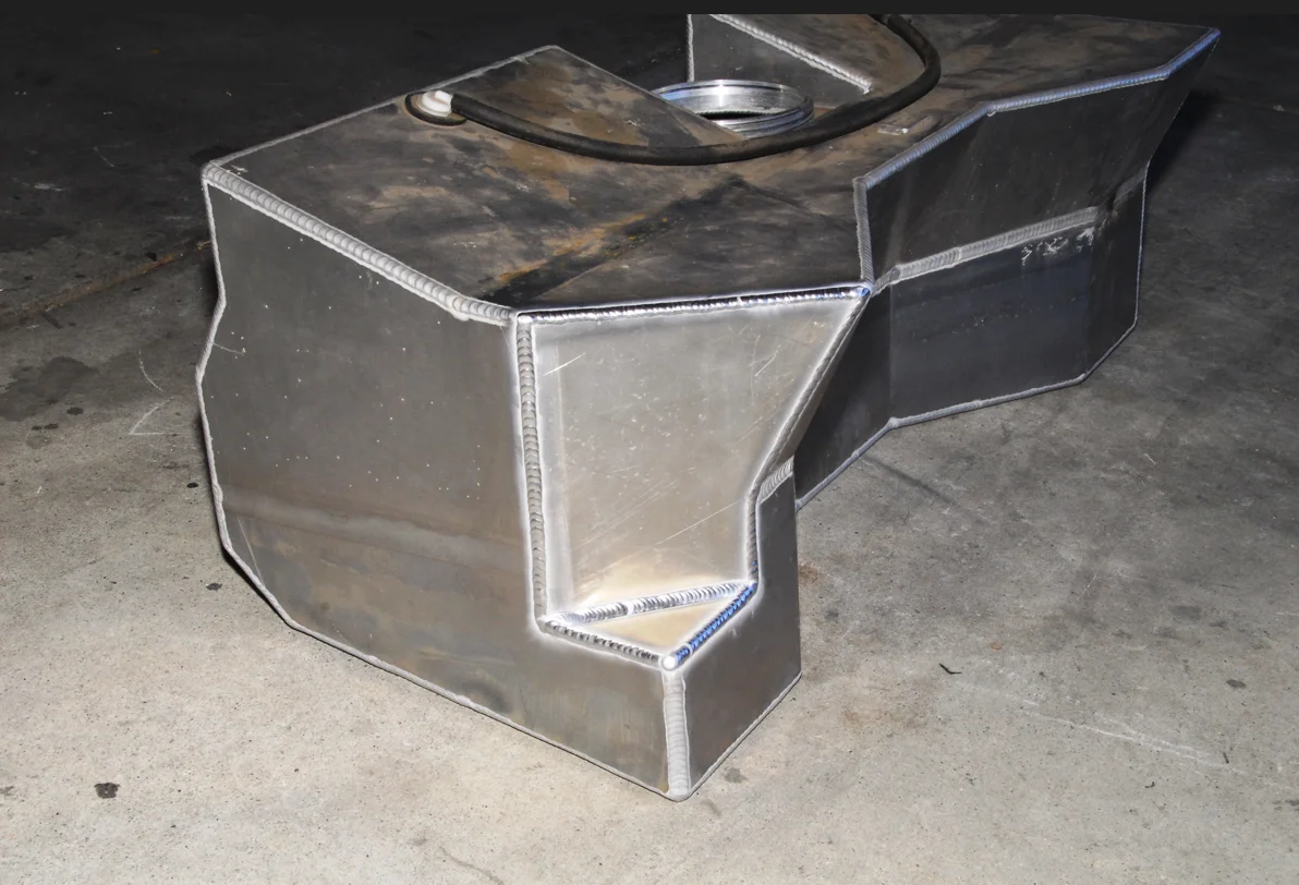

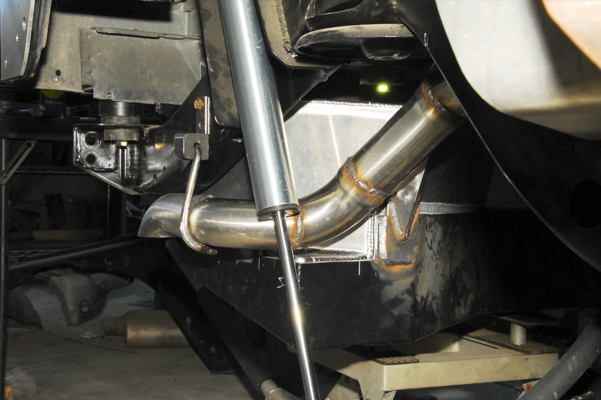

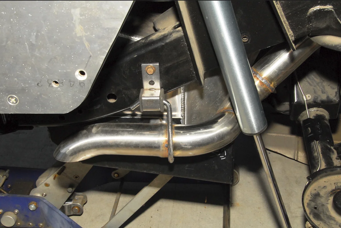

It's the 23 gallon tank and yeah I know exhaust will be annoying to figure out. Probably just dump it out the side not sure yet.
Out the side is not easy or even possible with a stretched TJ. If you had an Unlimited, then you could do this.
  • Love
Reactions: PNW_LJ and psrivats
That looks good!, unfortunately sound like I wouldn't be able to do that. Would you know if out of there rear is even a possibility for that tank or if just has to turn down somewhere before the rear axle. A good amount of information on this tank except exhaust methods. At least when I've searched through forums and Facebook groups.
It is possible but most won't cut up a perfectly good tank to pull it off.
