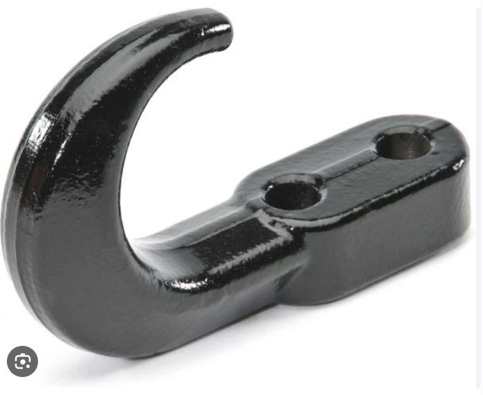

I'd get something similar to the below for both front and rear. The OEM hook is not rated for as much as this type is. Other similar hooks can have three holes which also work great, all like this will have higher load ratings than the factory hook does. Nearly any 4x4 store will have hooks like you need.
If you want to install a rear hook like below, one of the two holes is already present so you only need to drill one more hole. And don't drill through both sides of the frame, just drill through one side. The washers and nuts can be inserted inside the frame through a small opening that's present underneath the frame there. Through-drilling the frame on both sides can cause the frame to collapse as the bolts are tightened. They'll stay tight for a while then they'll loosen up as time goes by as the two sides move in towards each other in a never ending repeating cycle.

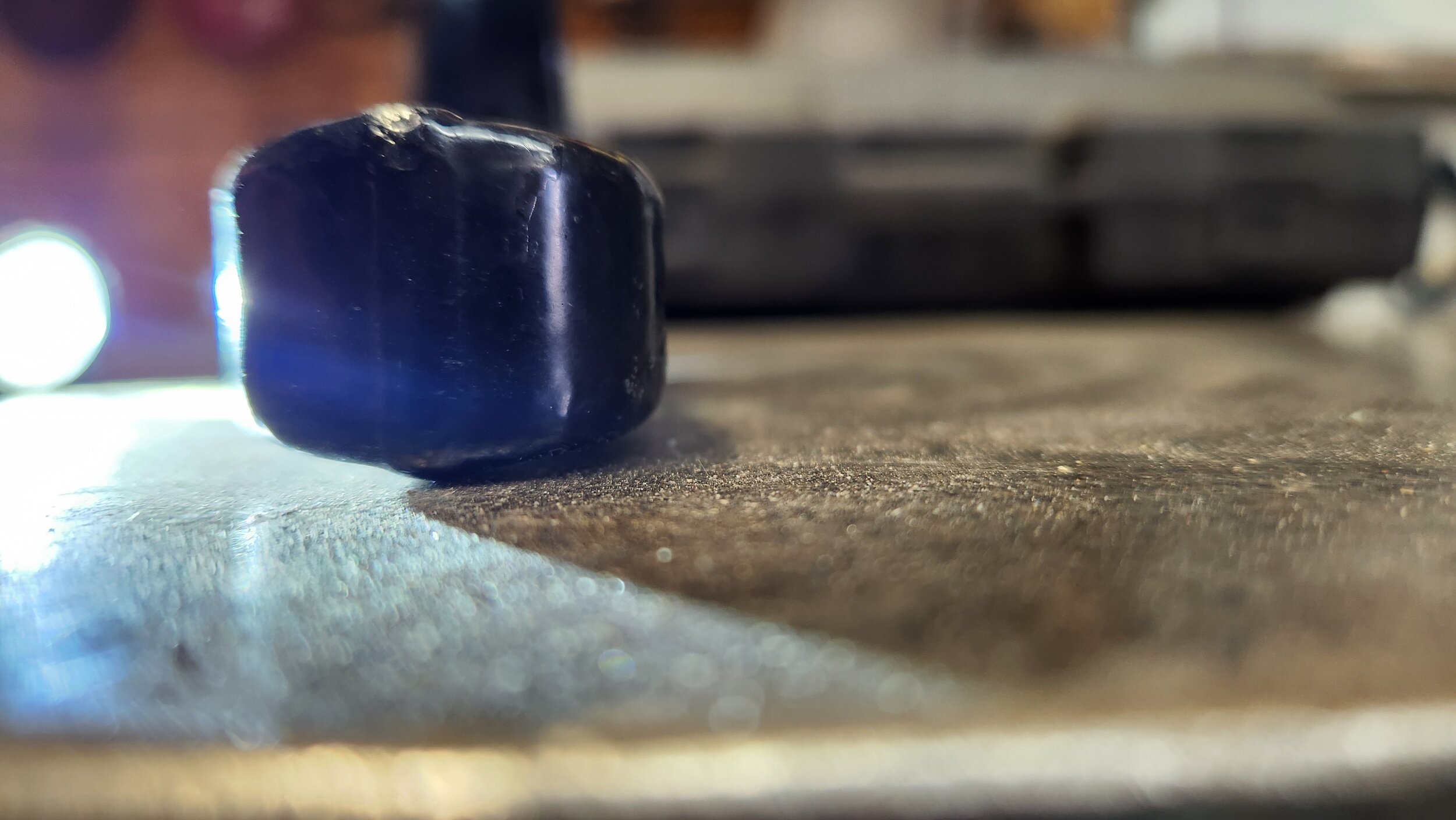

Pay close attention to the ones that Jerry recommended if you pick that option. The latest batch of them for sale at the common places is very flawed. The bottom face which needs to sit flat on the bumper is rounded more than the top of this one pictured below. They need to be flat to work correctly. We had to return several of them and finally pay top dollar for the Warn versions to get some that were flat.

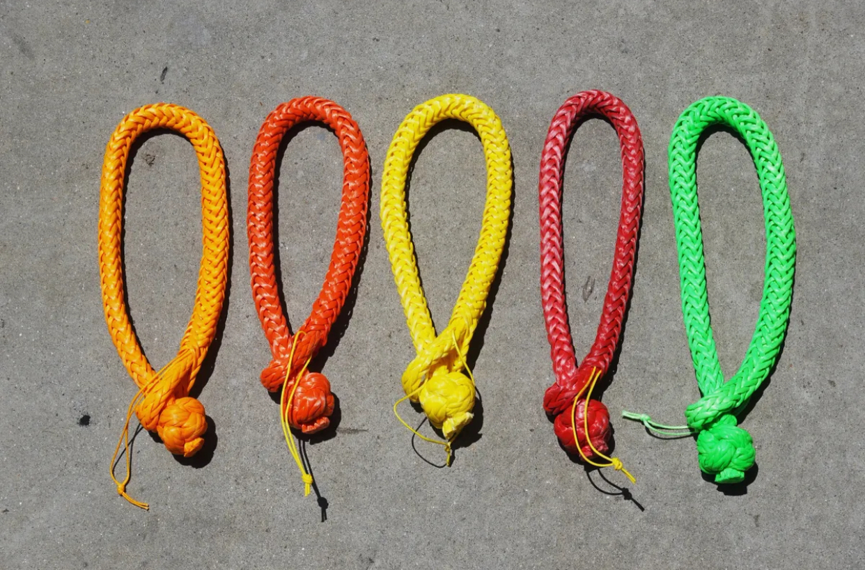

Another cheaper option (less desirable) is to buy some soft-shackles and just keep them in the Jeep.
They're versatile enough to pretty much connect to any part of the frame, to be used as a recovery point.

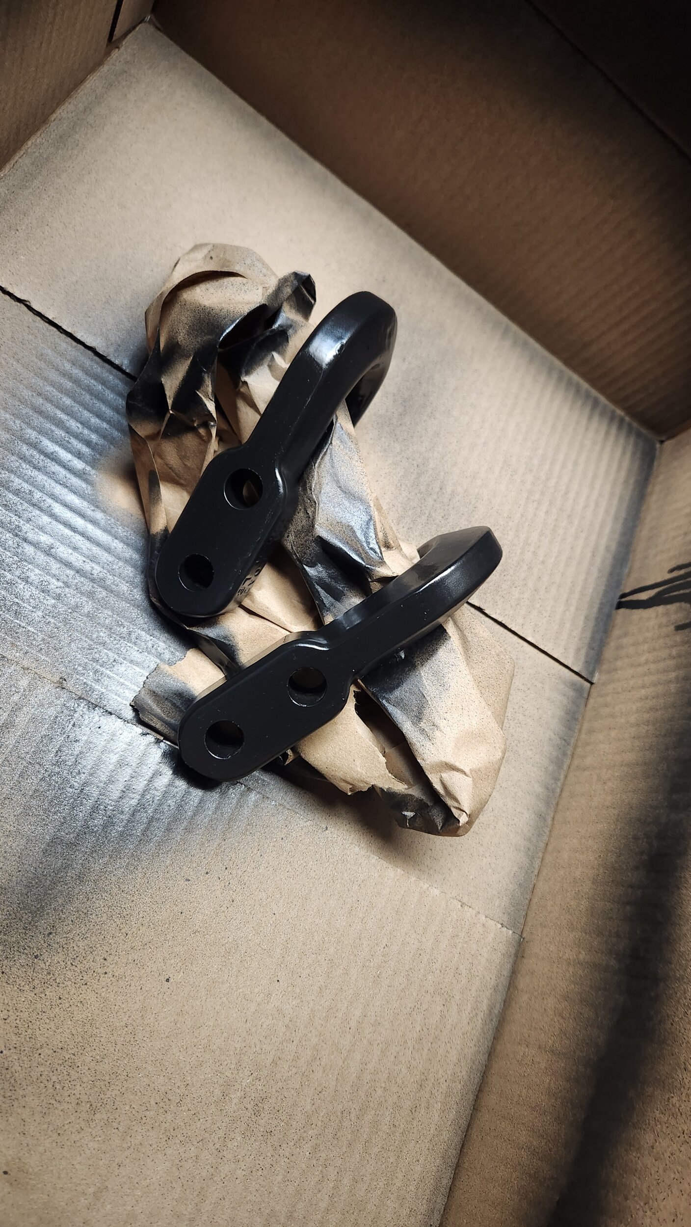

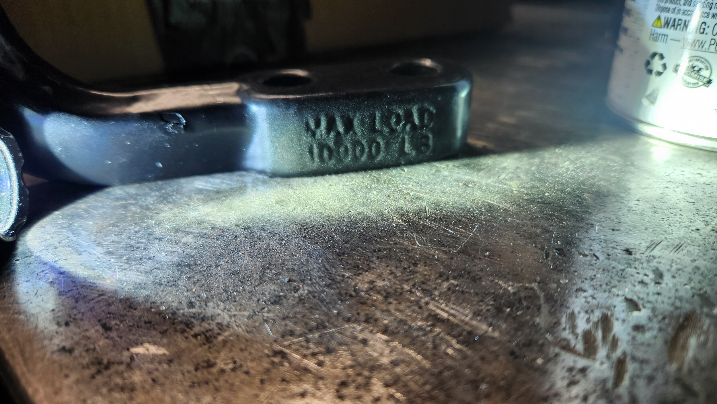

Updating this thread, I had ordered a Curt hook and just like @mrblaine said, it was seriously rounded on the bottom, it looked like a beached rowboat (see pic) I wanted the retaining clips which the expensive Warn didn't show in the pic, but I ran across these: https://www.amazon.com/dp/B07WZL8GT7?tag=wranglerorg-20 which have clips, the holes line up with the front bumper holes and they come with clips. Best of all you get two in the package. FWIW they claim a 10,000 lb. rating.

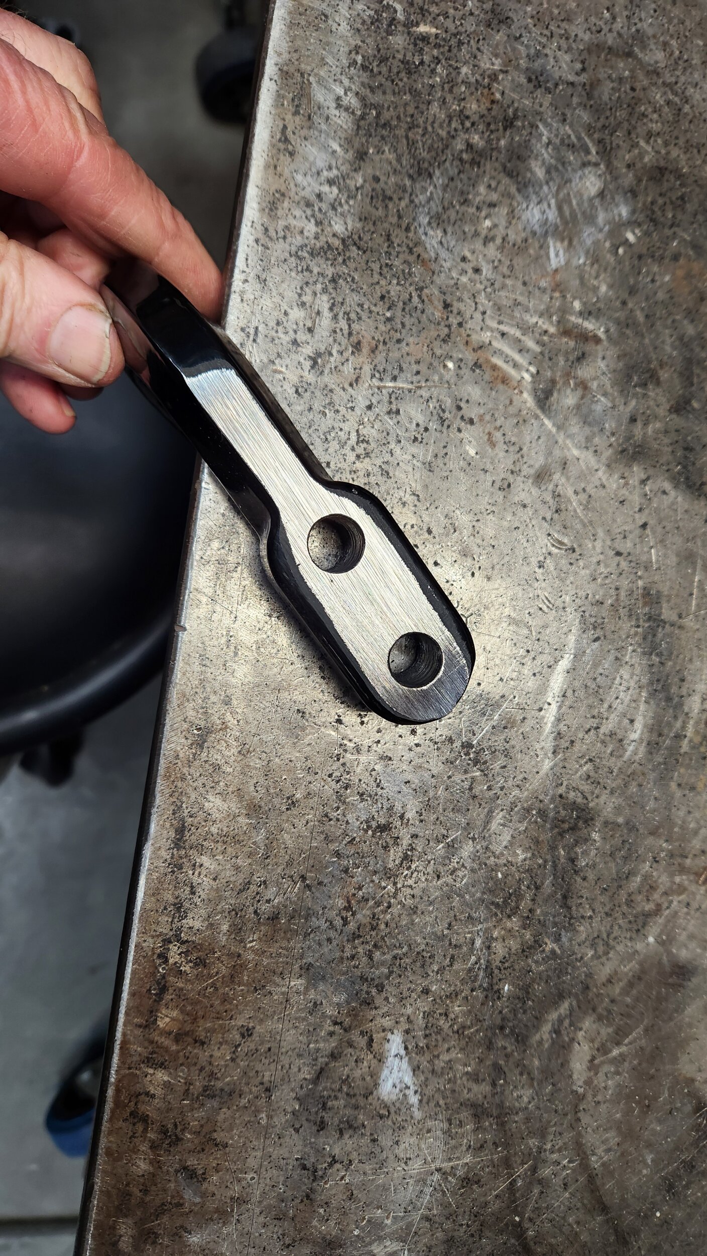

When they arrived I opened them up and there was a very slight rounded/raised ridge on the bottom, no where near like the Curt. I took them out to the shop and it literally took 30 seconds to flatten them on the benchtop belt sander (with an aluminum oxide abrasive belt). I think most of it was paint. After a quick re-paint they are ready to go. These will work for both the front bumper and the rear frame.
First pic is the Curt, followed by the XSTRAP

That's some bullshit, Curt. You had one job.

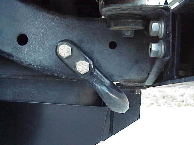

Serious question, would adding those recovery points on top of my already crowded front bumper (grade 8) bolts compromise strength during recovery? Picture for reference, i currently have the front bumper going through a winch plate, savvy winch guard, and a few thick washers to line everything up because i wanted to retain the front bumperettes.
If I shouldn't add a recovery point on top of those bolts, what are my options? A bumper with an integrated winch mount?
