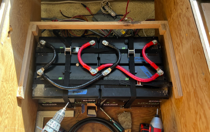

I jumped into lithium with both feet. They are starting to come down in price and when you consider their life vs the life of a typical FLA, it starts to make sense if you can swing the investment.
Are they lighter than the lead acids, Mike?
Yes, Like @reddvltj said...they are about half the weight. the 100 amp-hr batteries I bought weight about 34 lbs each.
I need a new battery, I've been looking into the Li-ion ones too
Look into the Epoch Marine batteries. Be warned though...You have to buy a charger for Li too, unless you can program your current one. I'd bet you need to buy a new one though, based on the age of your camper.
