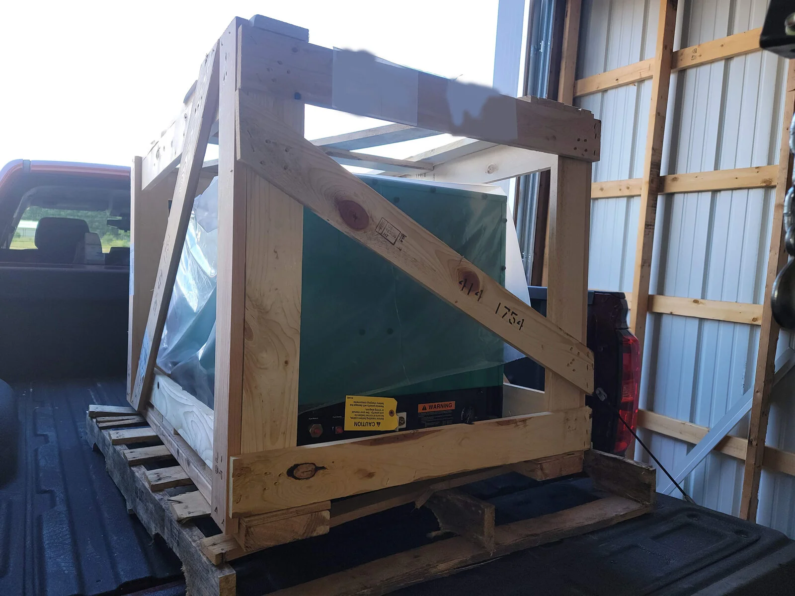

Which brand is that? Has that Cummins color.
Cummins/Onan but with a Kubota engine.
We're expecting to boondock more than stay at campgrounds, so we decided on a diesel generator to share the same fuel as the truck and they're supposed to be quieter. It also requires less frequent maintenance and sips fuel compared to gasoline which will mean more time doing what we enjoy. Since we'll have pets staying in the trailer alone at times having an on board gen seems like the more reliable option so a well meaning camper doesn't turn it off while we aren't there. If I could expect it to always be sunny where we camp I'd have strongly looked into more batteries and more solar panels instead.

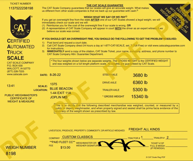

I just weighed my little trailer for the first time since I finished it. Loaded with water and gear its 1,160 pounds heavier than I would have guessed weighing 7,660. The truck is 7,680 with a full tank and me in the driver seat. I am also only 30 pounds below my rear axle rating of 6,390 with just the trailer and gear. She is way nose heavy. Adding the Jeep shifts the load to the trailer axles and off the truck. I plan to weigh again with the Jeep on soon and see how things move around. Trailer has 3x 5,200 axles so if I can get the Jeep in the right spot we should have lots of room by axle, and combined.
