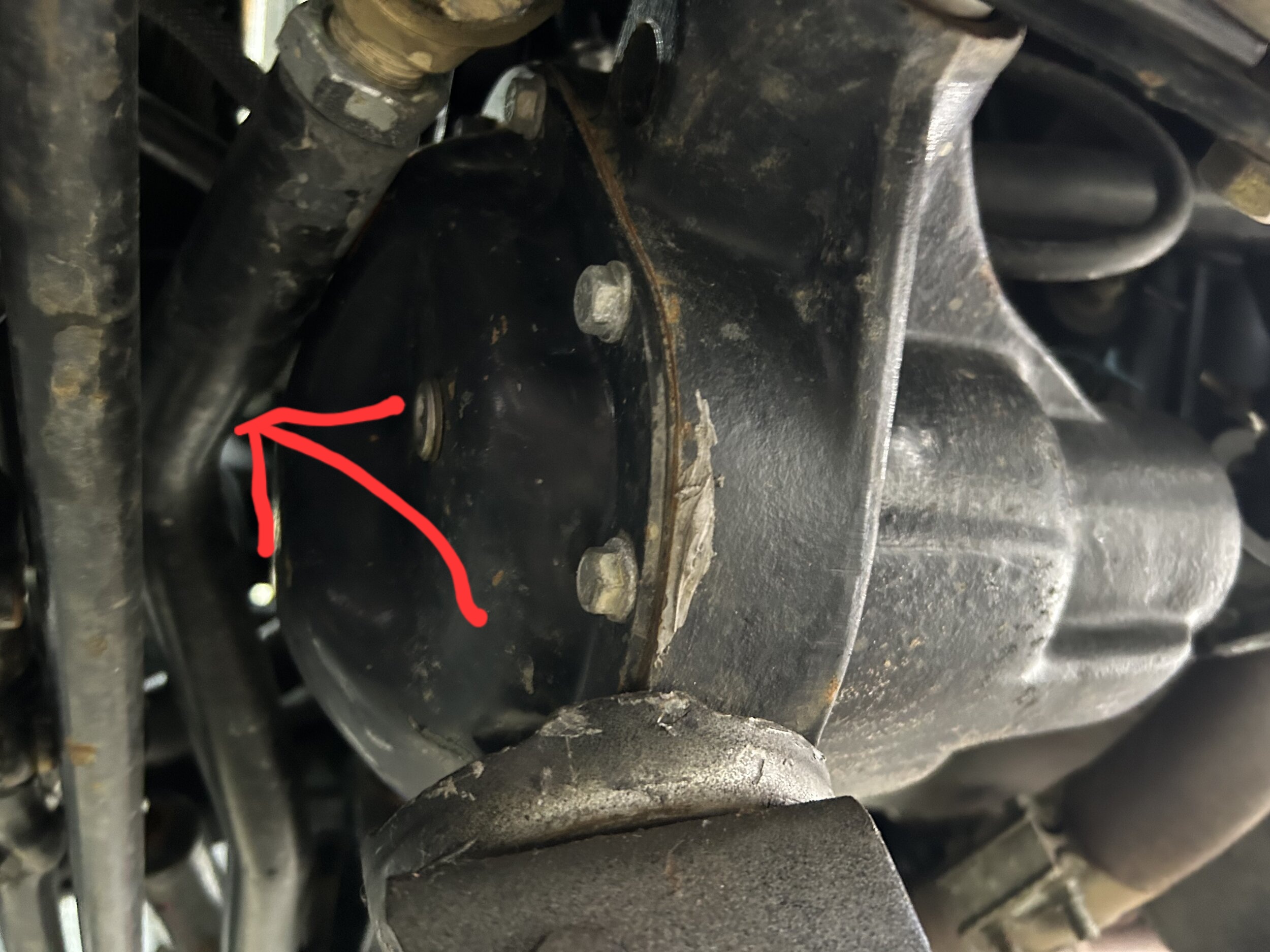

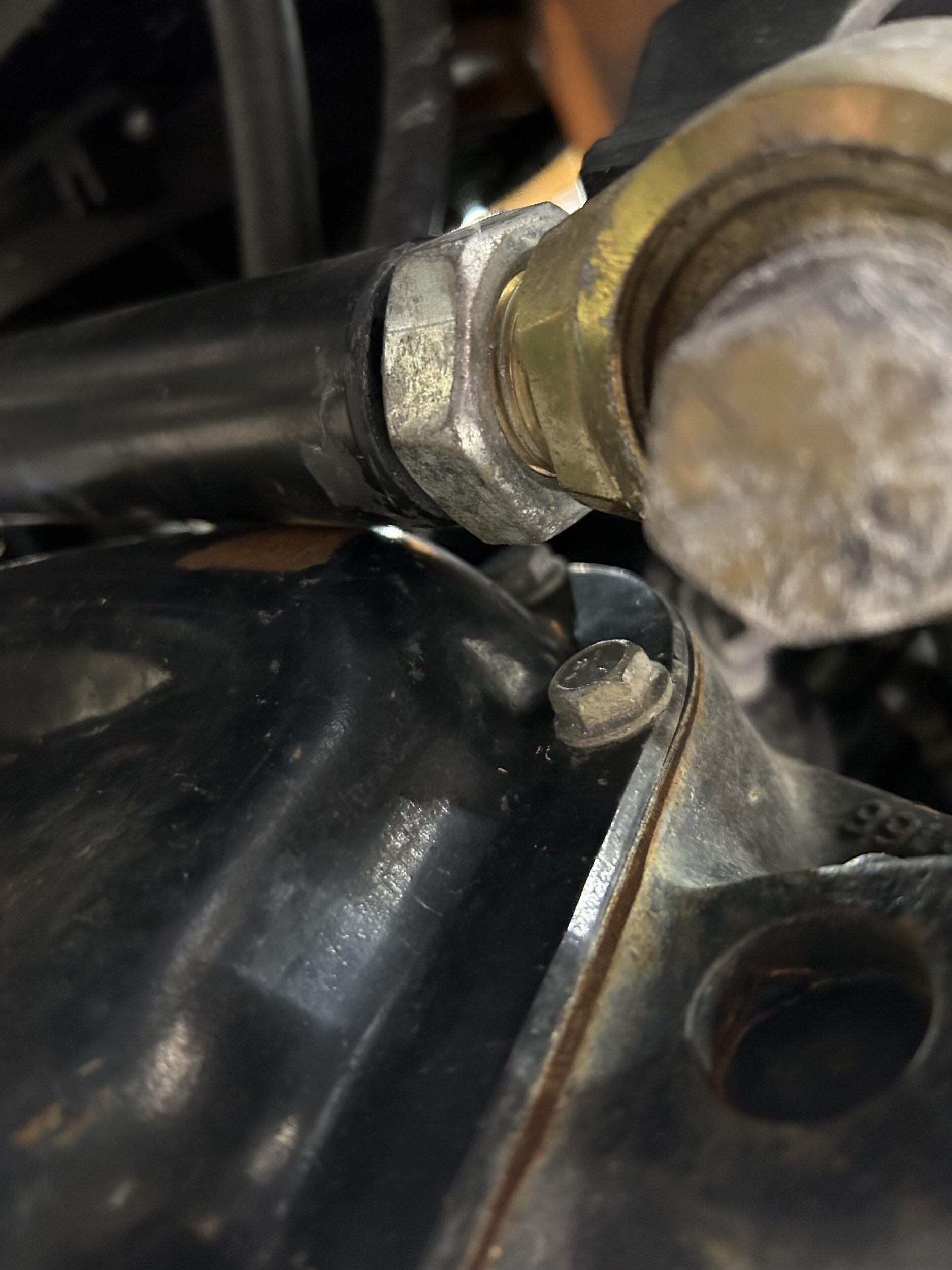

So I just found my Core4x4 Trackbar is interfering with the stock diff cover on my TJ at 1in from full compression and I cannot adjust the control arms enough to keep it from interfering. If I had the time I would probably just get one of those double shear mounts and relocate it further forward but I have a sand dune trip coming up soon and don't have time to do that. Is there a thinner adjustable bar that would be good to use? I already drilled out the mounting hole on the frame side so I cannot use a tapered stud style anymore. I was looking at the JKS bar and it looks thinner and kicks out more where the diff cover is. Kind of sucks it only has a JJ on one side, unlike my Core4x4 with dual JJ but I want to get something soon. The way I see it is what ever I get will eventually transfer to my LJ project when I do the double sheer mount and put the Core TB back on the go-fast TJ so buying another bar is not exactly a waste of money, just some extra work. Any other suggestions?
Can you post a picture from just a little bit further away

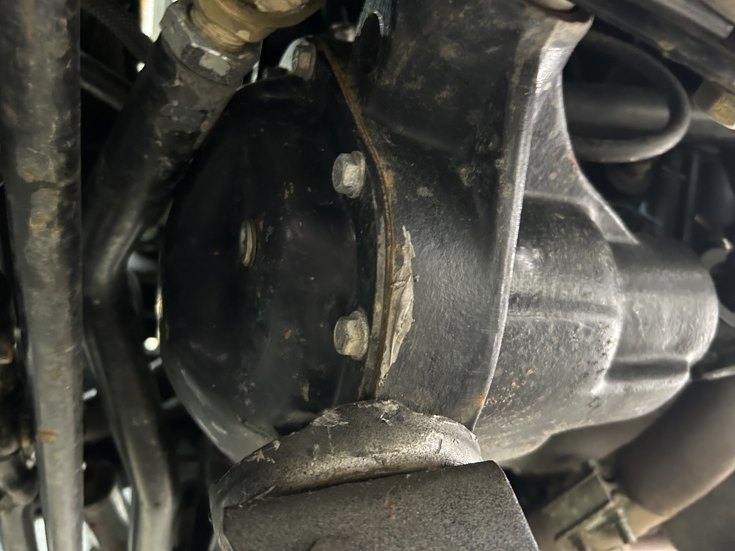

I already started putting some stuff back together but this was before I really started messing with the control arm adjustment. Its the only other photo I have.
