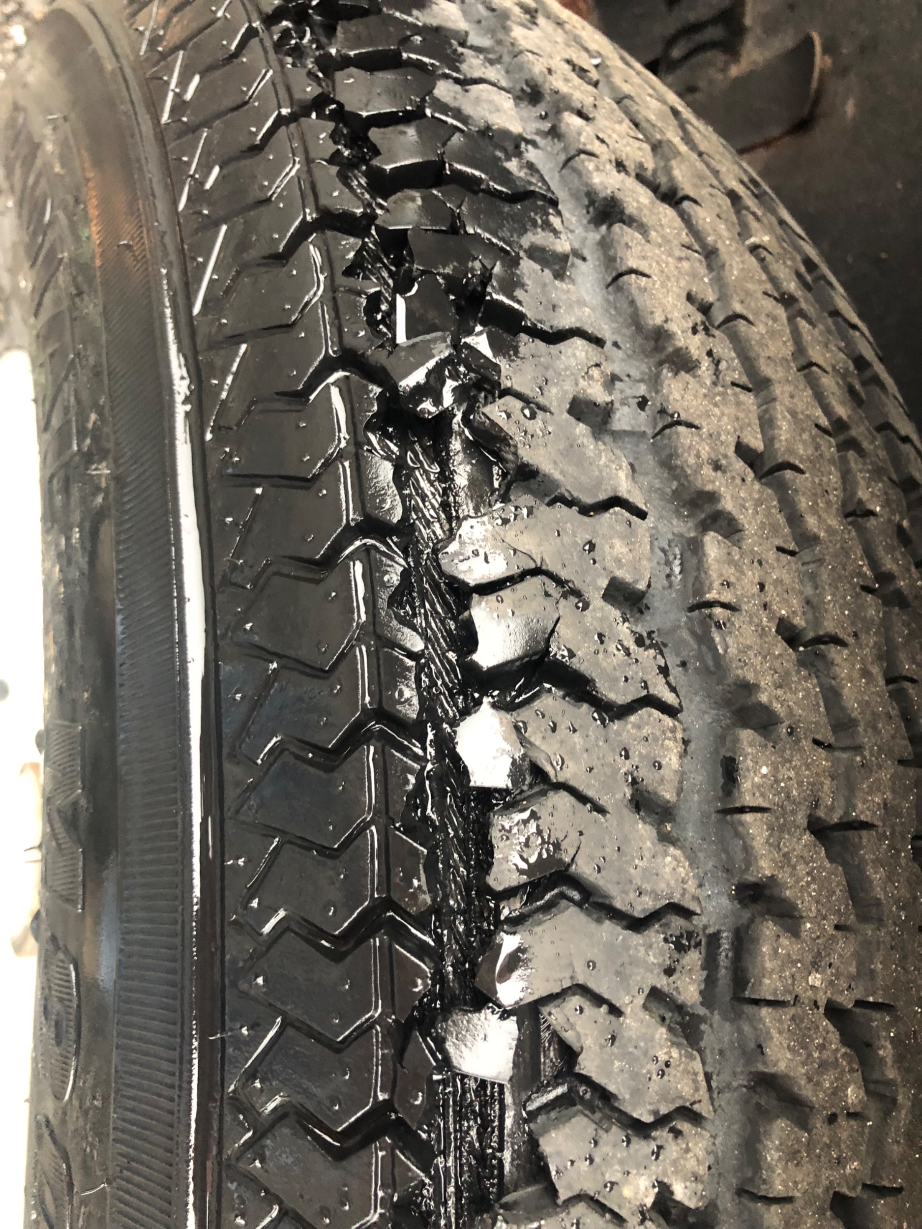

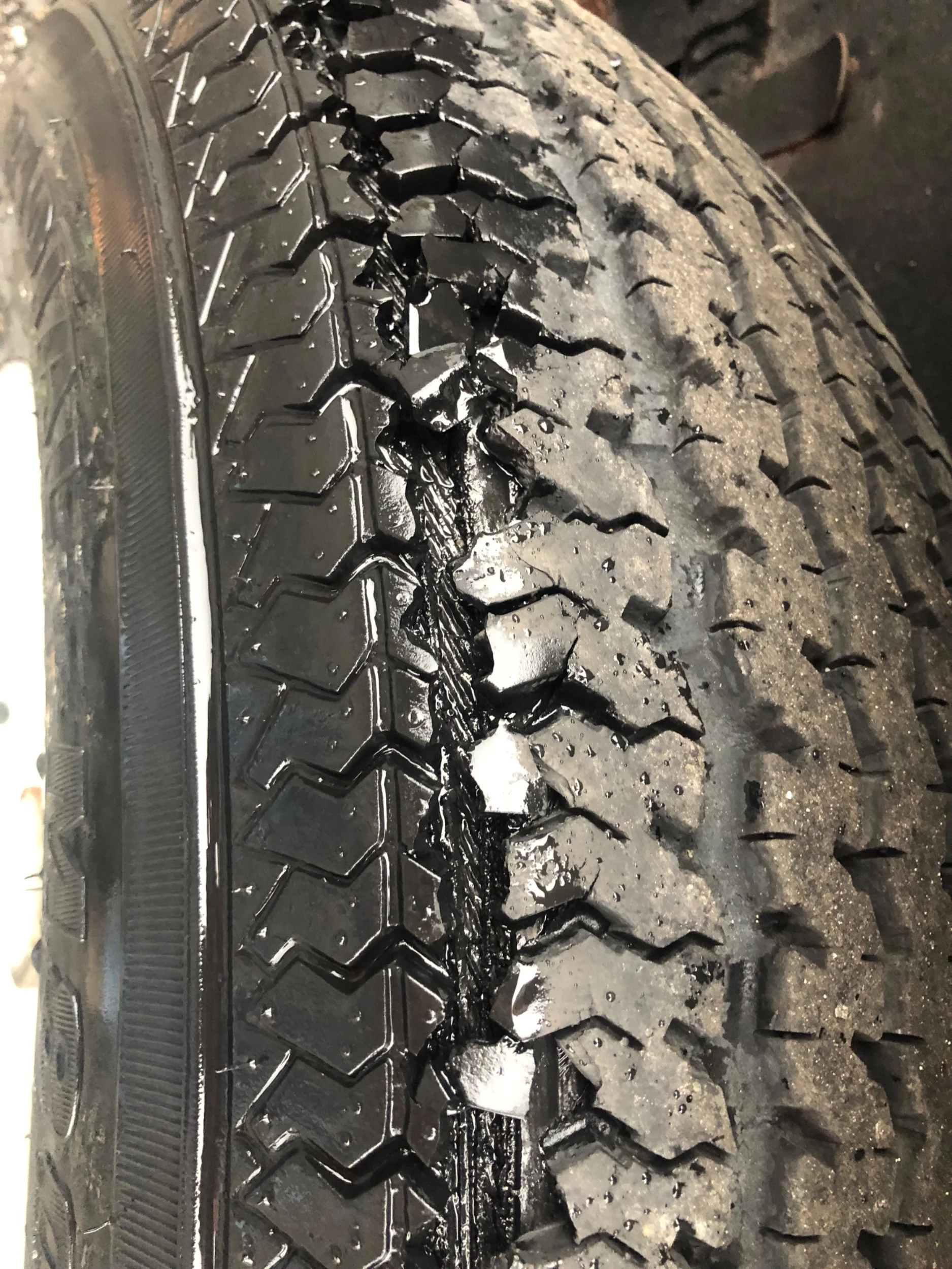

I noticed a tire separating on one of my flat bed trailers while walking past it this week. Build date is 03/18 so it was time to replace it anyway. I probably have over 10K miles on this tire. Several long trips to ID and ND hauling my equipment. I have 6 different trailers and keep tires in stock and change them out myself when needed.

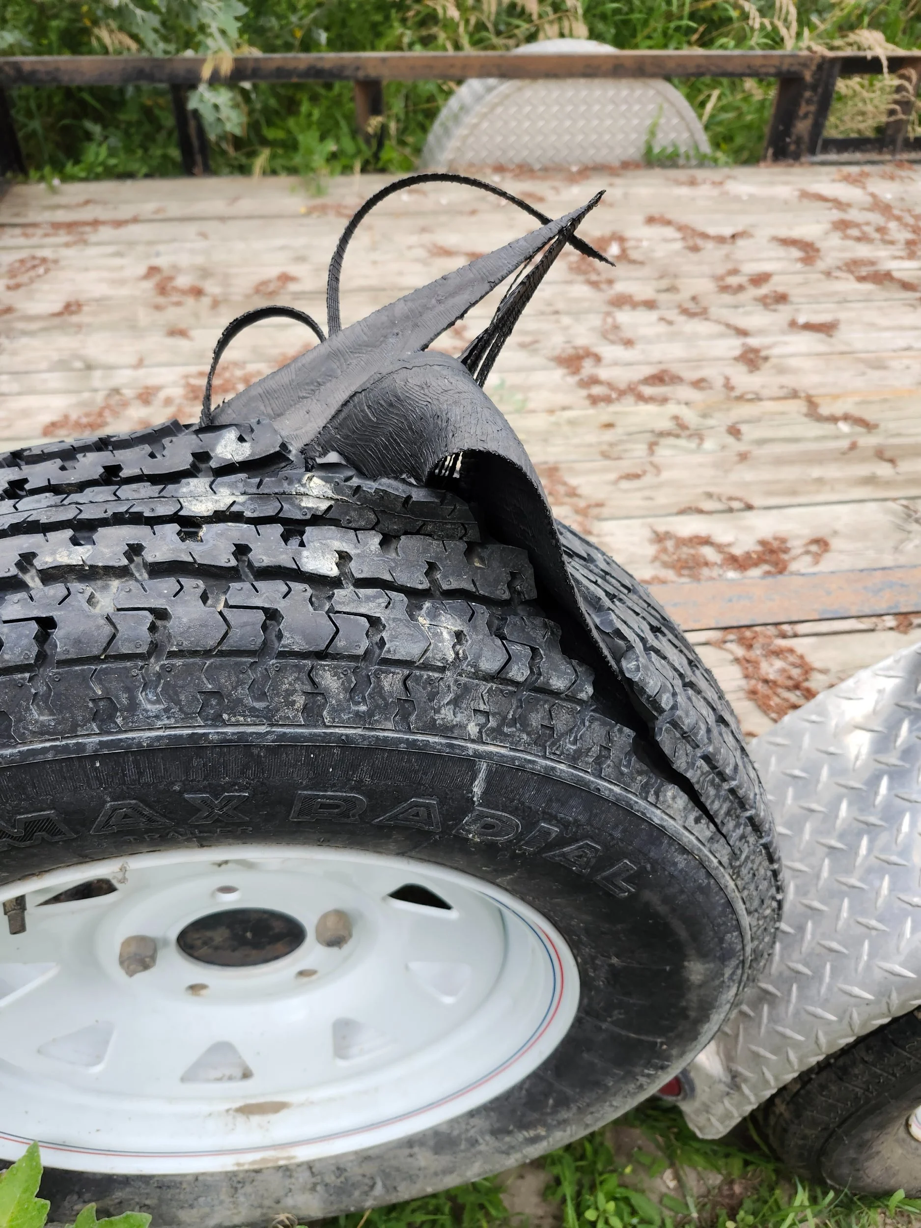

Oh. I added a pic that shows my luck with trailer tires.
It was on a smaller utility trailer. Had zero miles on it, sat on the spare tire carrier its' whole life- around 3-4 years. Never saw the ground.
Blew out ON THE SPARE TIRE MOUNT!
