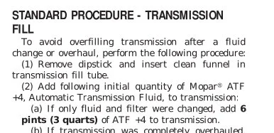

04 LJ with 115k, with 42RLE 4 speed auto. Located a hole in the side of the Transmission Pan and lost a good bit of fluid. Now have the following codes P0732 & P846.
This is my plan:
change all fluid: Valvoline ATF+4,
New Pan: Mopar 52852912AC or Dorman Transmission Fluid Pan - A/T 265-818
Filter: ATP B-216 Automatic Transmission Filter Kit
Fingers Crossed that the 2 code clear themselves out
