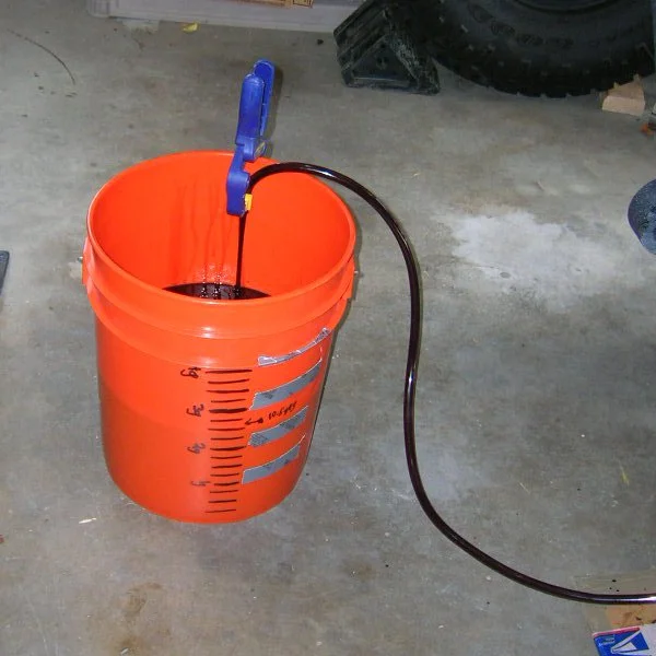

I've done this on every automatic I've ever owned. A few things I do: Pick up a large paint mixing container, I got a 2 gallon one at Ace. I put the 2 gallon paint container down in the 5 gallon bucket and secured the hose. The paint mixing container is translucent and marked in graduations. Chris' idea works fine but I find the paint container much easier to pour the old fluid into a funnel to recycle, and more accurate for measuring.
After the pan drain and filter replacement I add back the same amount of fluid that I drained out using the graduations on the paint mixing container, then I start the engine and let it pump out a few quarts. I keep the bucket right by the driver's door so I can watch it while my hands are ready at the key. I also climb in and run it thru all the gears a couple times. Each time I shut the engine off, I take the paint bucket measurement then dump it into my recycling container. There is no need to try and add fluid while the engine is running IMHO, just keep shutting it off and take your time. I even keep track on a paper quarts in and quarts out to be sure I don't screw up.

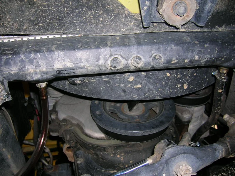

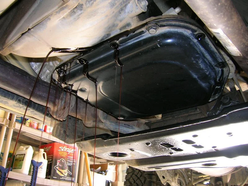

Since the back 1/3 of the pan is covered by the transfer case skid I decided I would drain the fluid from the front. I loosened the front bolts almost all the way out. Then loosened all other bolts working my way backwards down each side simultaneously. I kept the rear bolts tight. It ensures the front side of the pan separates from the tranny and the fluid comes out the front. I gently pried the front of the pan since it was still sticking to the tranny.

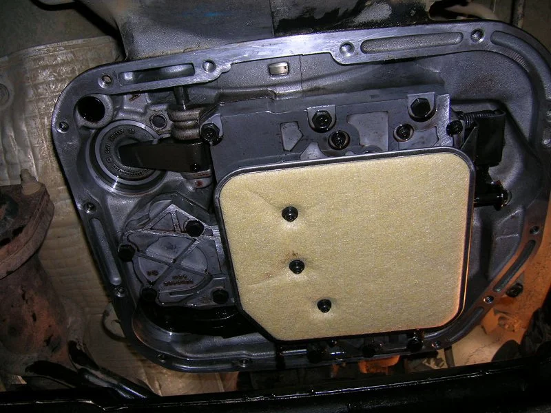

Once the fluid is done draining I removed the pan and filter. Without a drain plug the pan still has fluid in it. Wiped off the mating surface and remove any stuck gasket. I used a gasket scraper. Then wiped a rag with brake cleaner to finish cleaning the surface. Installed the new filter. Apparently, there are torque specs for the filter bolts. I had no idea at the time.

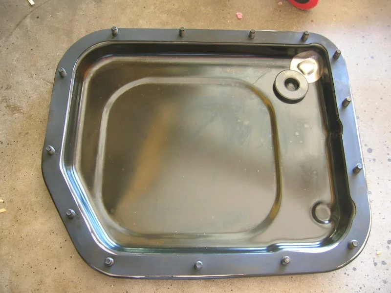

Clean the pan
I cleaned the pan with brake cleaner. Removed the magnet and cleaned it as well. Then washed in hot soapy water in the kitchen sink. Quickly dried and cleaned again with brake cleaner to remove any moisture quickly. Put the magnet back in and matched up the correct gasket. My kit came with 2. Put the bolts through the pan holes and screwed into gasket. The gasket holes are small enough to hold the bolts. It's important not to screw the bolts in the gasket all the way. It would make it difficult to screw the bolts into the tranny because all the other bolts are fully extended. I put them in so the bolts are sticking out of the gasket a couple threads (even though the picture shows them screwed in fully).

I chose a 5 gal bucket because they're cheap and I can easily see the fluid level through the plastic. I took an empty and clean milk gallon and added one full of water at a time to the bucket. I marked the level with a permanent marker on the side. Then estimated each section into quarters for quart graduations! I got the remaining 9 bottles of ATF and removed the caps. I kept them near the tranny dip stick tube for easy access.
