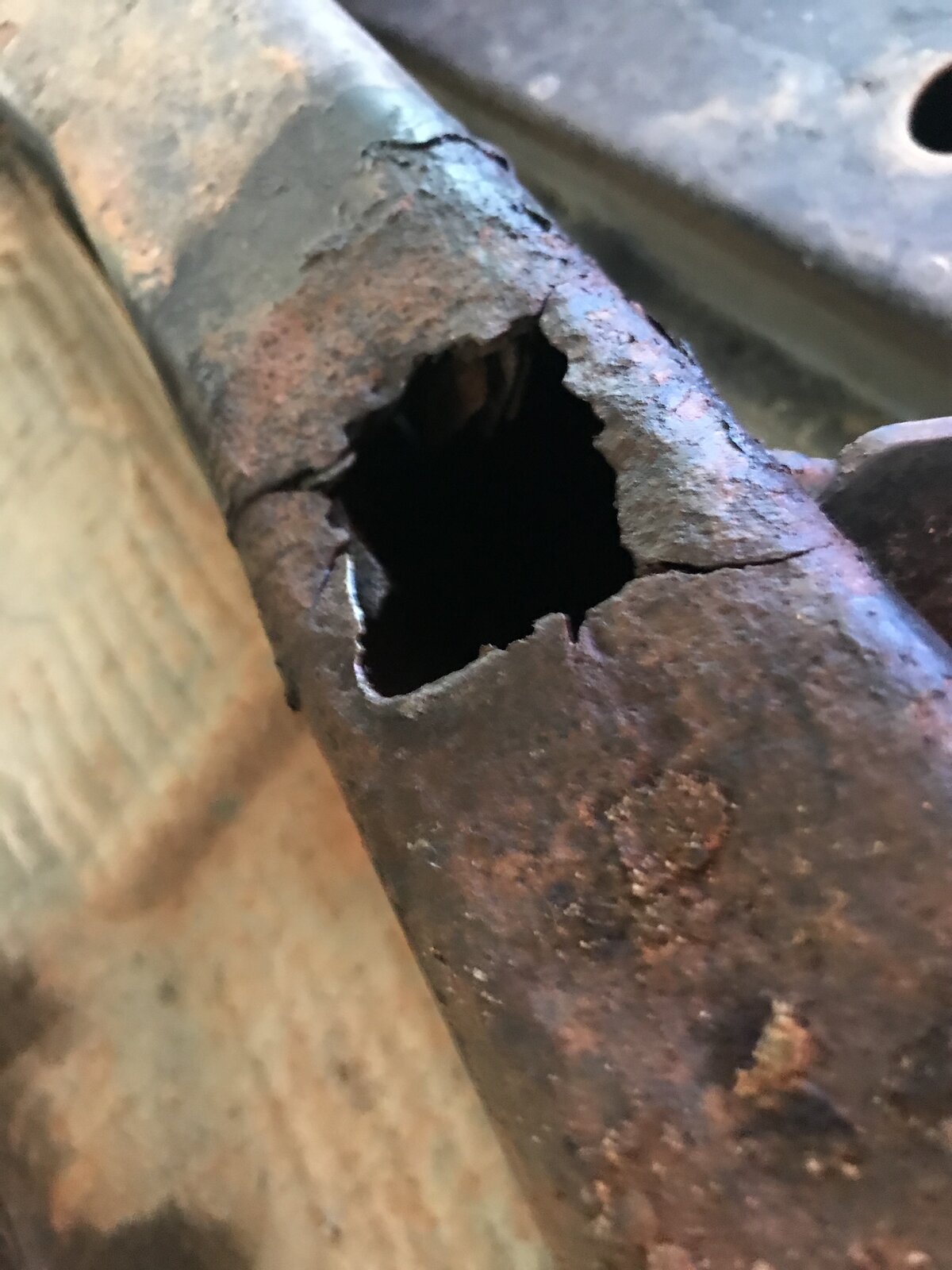

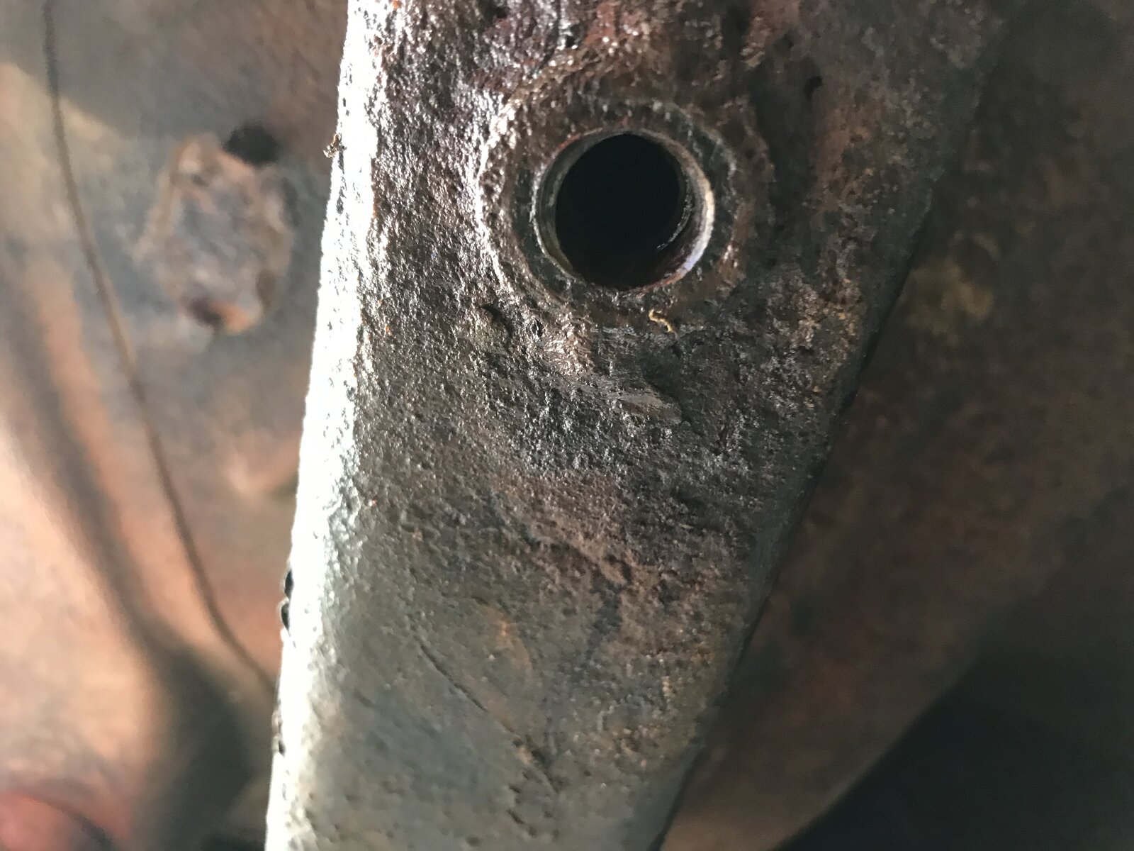

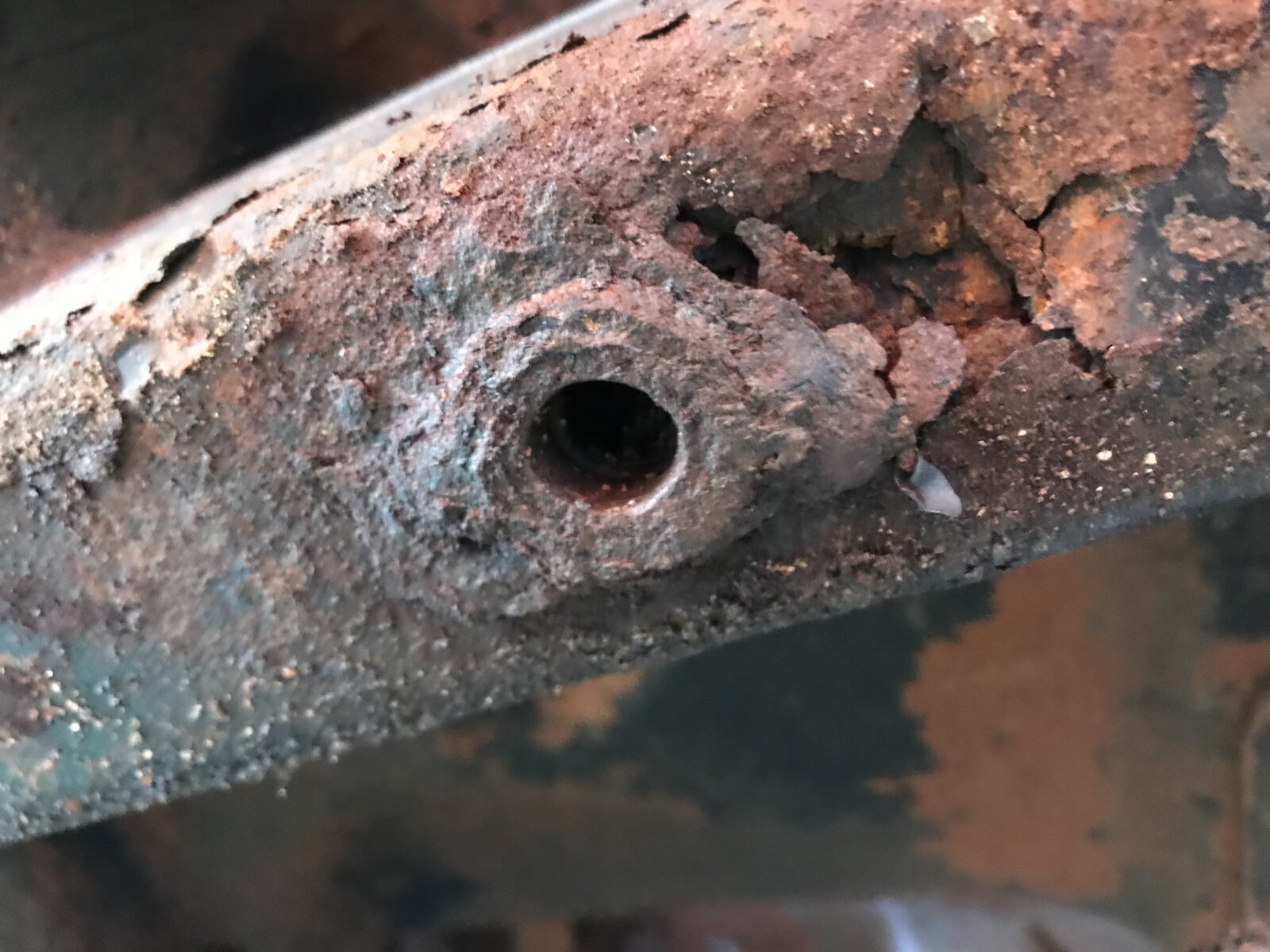

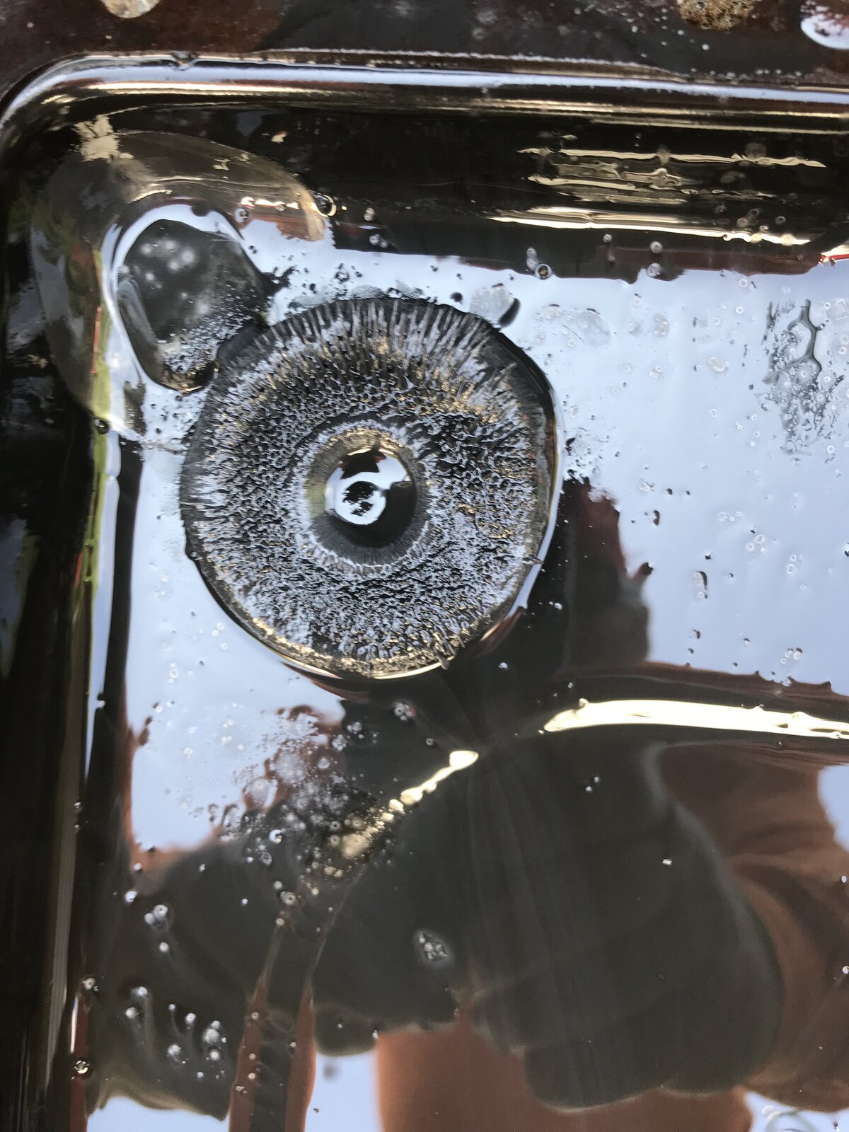

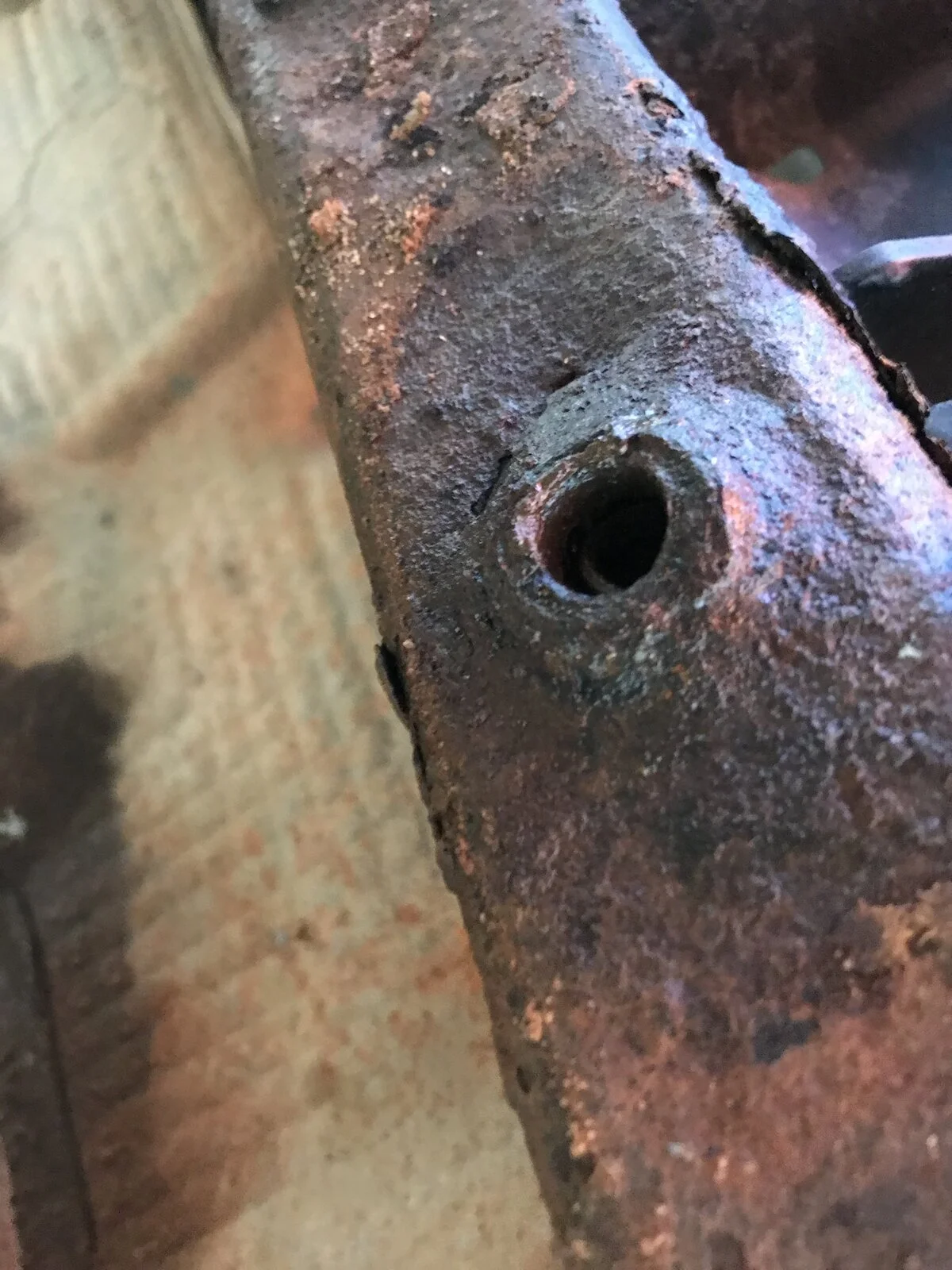

Well FUDGE 🤦‍♂️. Decided to take skid plate off and clean it while I was flushing transmission. To start, bolt holes for 1 bolt on each side are rusted out. One of them left 1 1/2” hole in frame. The one of the 4 bolts, for what I’m calling a rubber mount, had a rounded off nut and I had to cut bolt off with my dremel. Skid plate was filled full of an fluid and sand combination. My fluid leak is rear of pan. I have a slight leak from rear main oil seal. I’ll flush transmission tomorrow and see if skid plate will bolt back up🤞. Address frame later if I can
Can you post a couple of pics of the frame damage so we can see what you've got to work with?

Flush is done. Bands are adjusted. There is not a single skid plate bolt that will bite🤦‍♂️. Looks like I just need the center section of frame repaired on both sides. I’ve got a few friends that weld, one builds custom cars from frame up. And then it’s hoping transmission lasts a few thousand more miles. Thanks everyone
