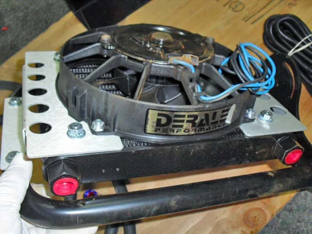

Thanks for the recommendation. I noticed that's twice as expensive as similar remote coolers. Why is that cooler better than others? Trying to justify the price.
It's a complete ready-to-install kit with all the parts required and specifically designed for a Wrangler. Thermostat switch, electric fan, cooler, AN coolant fittings, hose, mounting bracket, hardware, etc.
Did you read the installation writeup Chris included in his post?
Yeah, it's very detailed. Great write up.
Why does this one mount at the tranny instead of in front of the radiator?
Easier to install and the cooler with fan is too deep to mount between the grill and radiator support bars

Mud can clog anything including the big radiator up front. The cooler's mounting location hasn't interfered with any of my armor including my full engine skid that replaced the OE tcase skidplate.

3 more questions:
Could it get caked in mud at that location and cause problems?
Does the location interfere with armor or maintenance access?
Jerry is right, mud can clog anything, including your radiator up front. I've never had any issues whatsoever with the mud clogging my Derale transmission cooler though.
Also, it doesn't interfere with maintenance access at all. It's a very nifty unit that was very, very well designed. Anyone who has an automatic should undoubtedly be running one of these, seriously. You'll prolong the life of your transmission for sure.
