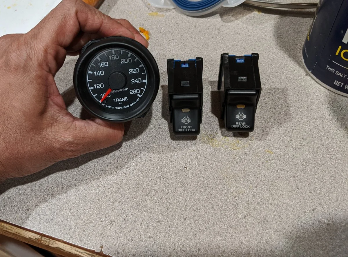

I guess we're even then. I'm not a fan of day-glo, overly cluttered gauge faces that look like they fell out of some spaceship on it's way to Mars that don't match anything else on the TJ interior.
It actually matches my TJ. I have an automatic that has stock green light and the aftermarket stereo is green. Thinking about installing this by the hand brake. Nothing inside my Jeep came in chrome. Adding a chrome piece now would look weird.

Looking for recommendations for transmission cooler + temp gauge.
Thanks.
2005 LJ 4.0 Automatic
I have this cooler in my Jeep and no problems so far.
https://www.pscmotorsports.com/engine-specific-products/jeep/psc-mbc100.html
I like the below gauge from autometer - it's backlit green but not overly bright.
Autometer factory match 2-1/6 gauge 8457
