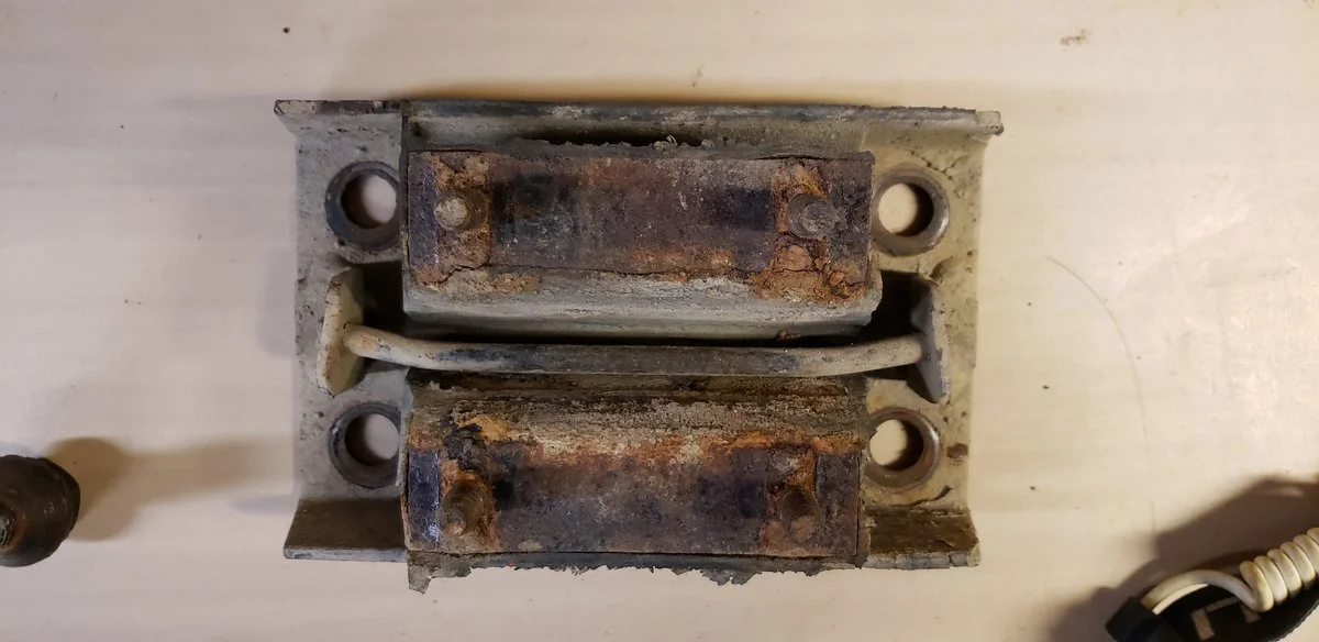

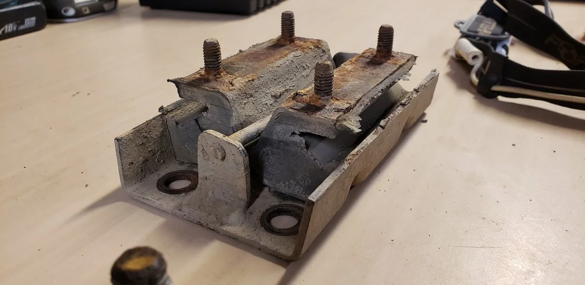

I went with the El Cheapo option from Rock Auto (Westar EM2882). It was $16 after shipping. It's only been in there a couple months and, so far so good.
For what it's worth, my original mount was is pretty rough shape. I was expecting to notice an improvement with a new mount installed. No real noticeable difference on the street...
