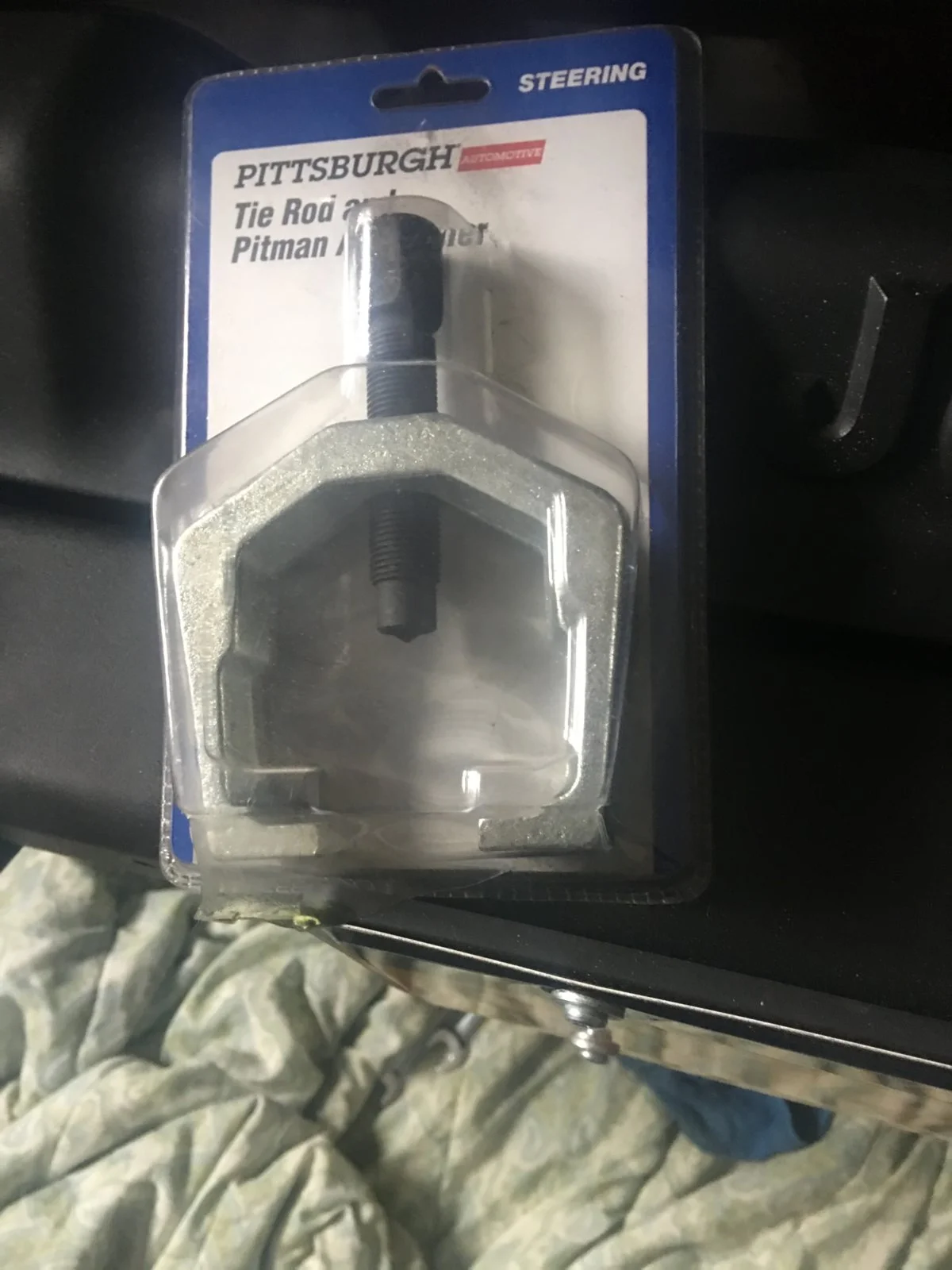

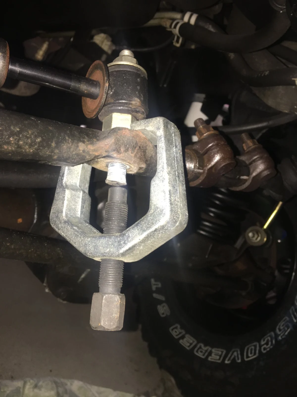

So after torch heating, banging with heavy hammer and trying everything I could think of doing...it wouldn't budge. Then I found a youtube video with a guy ("Jeep Pickle") showing his "tip" for removal...using a tie-rod removeal tool. IT WORKED GREAT! So I'd thought I share his video and my pics.
PS I would still heat up the bolt as it no doubt still makes it easier to remove.
I have always used this method with a nut on the end of the threaded tapered bolt. Leave approx. 1/2 of the nut exposed so the pointed end of the puller can center itself. That keeps the puller rod centered. Load up the puller until you can't apply any more force and soak with Kroil. Let sit for about ten minutes and whack the puller with a small sledge. The nut also keeps the tapered rod from flying. When you put the new tapered rod back in clean the hole with a wire brush and a bit of fine emery. Coat taper with Never Seize and re-assemble. Several years down the road, when you need to change this again, you'll be thankful you took these extra steps.
