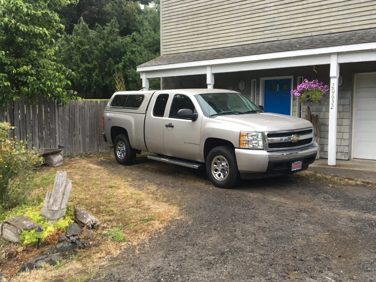

I picked up this 2008 Silverado with 73k miles not to long ago. It’s only the 4.8 but I figure it should tow the Jeep after big tranny cooler and maybe the corvette servo. Anyhoo, living in the PNW is awesome for camping and exploring.

This is what I have to work with. 6.5 ft bed. I’m thinking the previous owner rarely used it. The truck came with a canopy already so I scored on that one.... no sliding rear window so I licked the pudding pop on that.

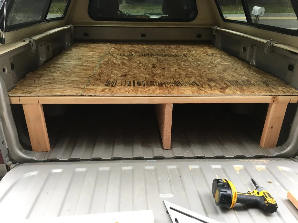

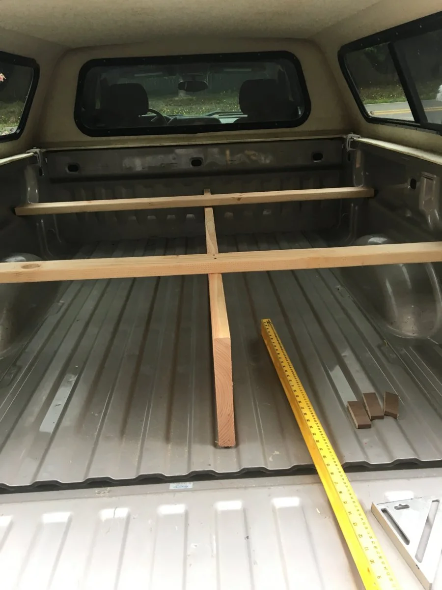

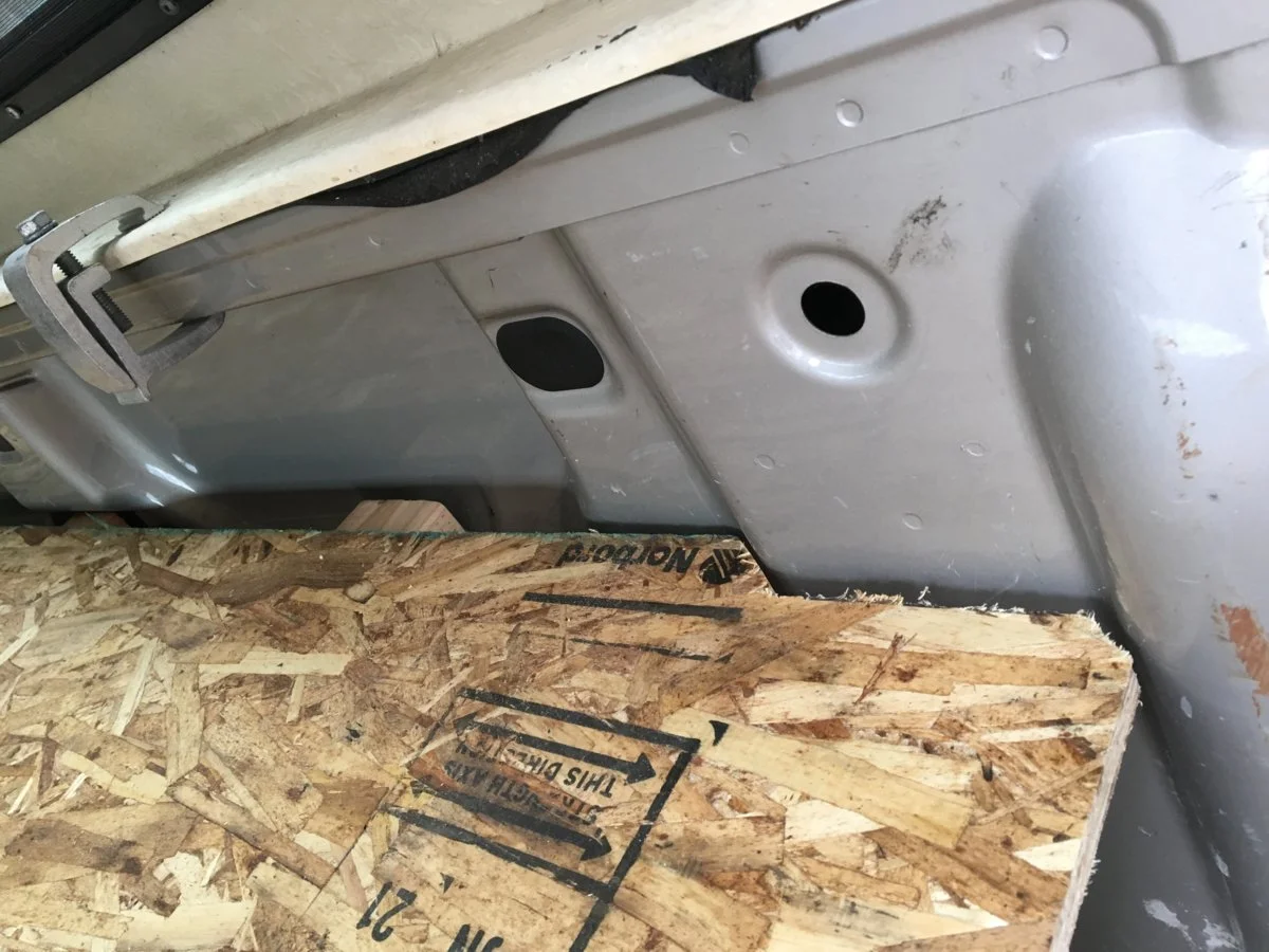

The Silverado has side indents for wood placement. If your truck does not have this you’ll have to make legs. I used the 2x12 as my center brace. Absolute center would put me on top of the rib. I wanted the rib to support he bottom from kicking out so I placed it groove over. I put two screws going through the 2x4 and into the 2x12.
105012

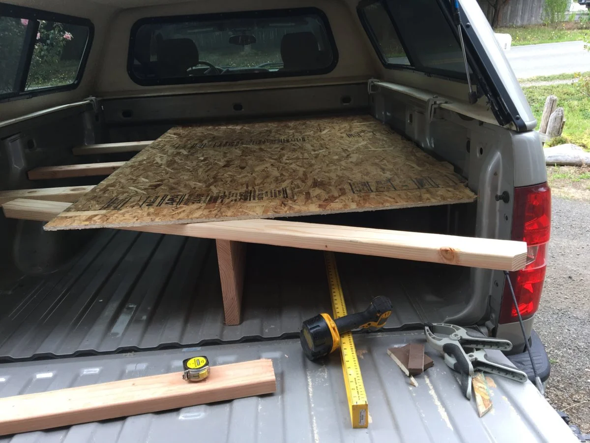

The middle indent for me was smaller than the 63” and was impossible for me to wedge in there. I measure from the center beam to the outside edge and toenail two screws in each 2x4.
105015
Boards are only fastened into the center 2x12. Outside edge is resting in the outer grooves.
105016

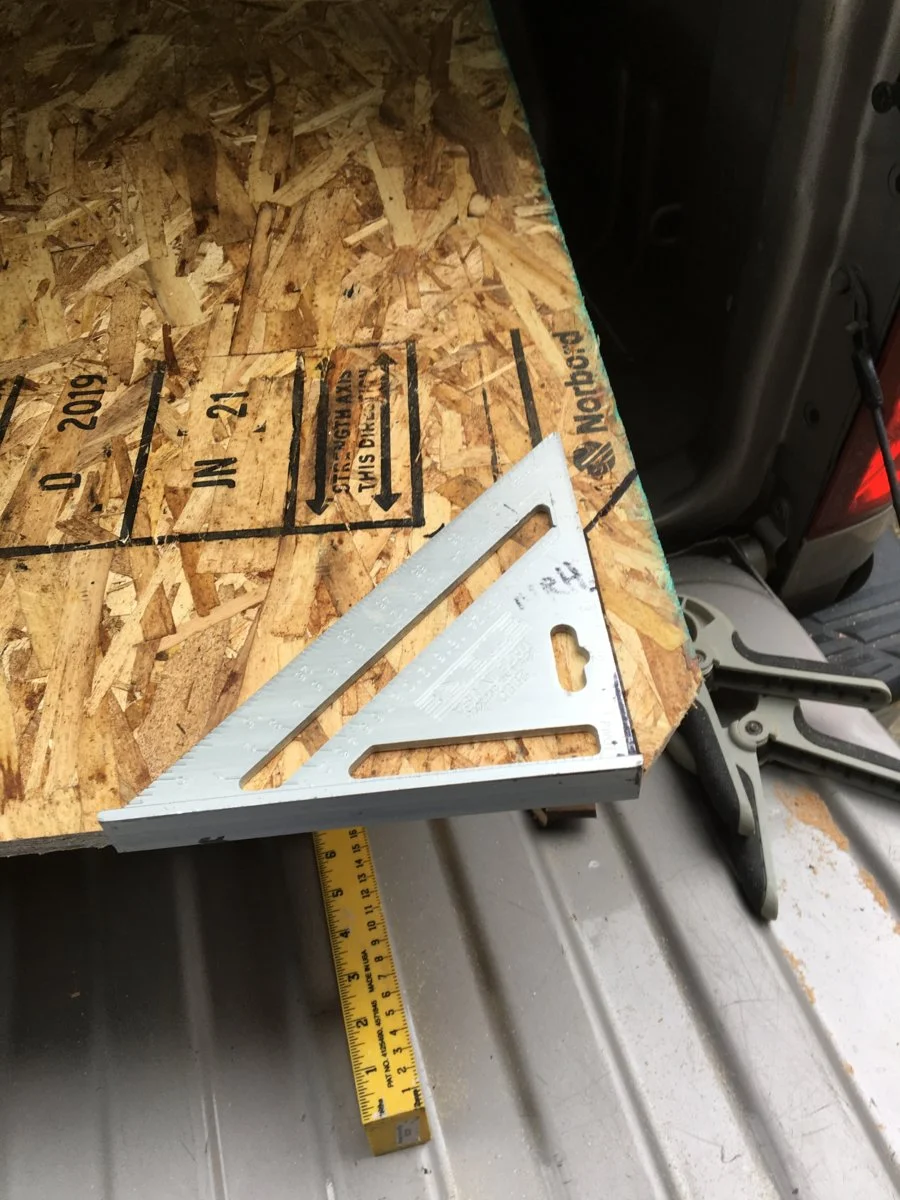

I had to notch around my bed towards the tailgate. This was not an exact science for me, but it came out okay.

You’ll have to make a front brace for the front edge. I cut a 2x4 down and attached down supports since there are no indents to support this board. I measured and cut everything and took it out to screw it together. I want this platform to be able to come out easily. I made mine flush to the plywood and 2x12.
105020
I made my legs perpendicular to the bed wall to help guide the slides. I used the end I cut off to finish the left side. I did not put a leg support towards the cab since most of the weight will be at the braces and again I want this to come out easily.
105021
If you with me at this point you should have a platform bed with a lot of room underneath. I only used 1 full sheet of plywood and a 2ft section of the second piece. I put the smooth side up for my platform. If you use sanded plywood it would be a nicer finish, but good god man this is for camping.

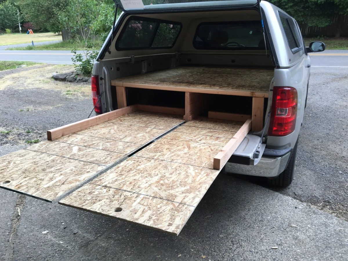

I ripped my 6ft piece of plywood into widths length wise based on my opening dimensions. For me I have one 25” wide and one 22” wide.
I used the 2x3 to make an L shape on the edge towards the bed sides. The inner 2x12 won’t need this brace since the beam acts as your divider.
105026
So it will be something like this. I was going to put the handles I got, but I didn’t have small enough screws. So I used a 1 1/2” hole saw to make a grab point. I’ll probably grab the screws when I’m out tomorrow to install the handles.
105027
Now just compete the other side. I added 1/2” scrap of 2x4 at the bottom of the 2x12 on each side to help guide the slides and hold them up when fully extended.

Either drawer fits my Coleman stove. Bonus for being able to use the slide as a cook station once we are set up.
105031
So that’s it! I’ll update once I get the smaller bins loaded. Slides I put the shiny side down to help with movement. Rougher side May hold things in place. We have a queen size air mattress or futon for the top. Enjoy!

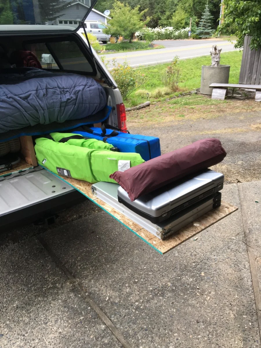

So here is everything loaded ready for our camping trip this weekend. On the smaller side, I was able to fit our pop up canopy, two massive folding chairs, fold up table, Coleman grill , camp shovel, and a three person dome tent just in case.
105130
On the larger side I was able to fit three 25”x 17”x 8” high tubs.. could have gone bigger but these were Walmart cheapies. Camp shower, step stool , and roll up pad for the tailgate.

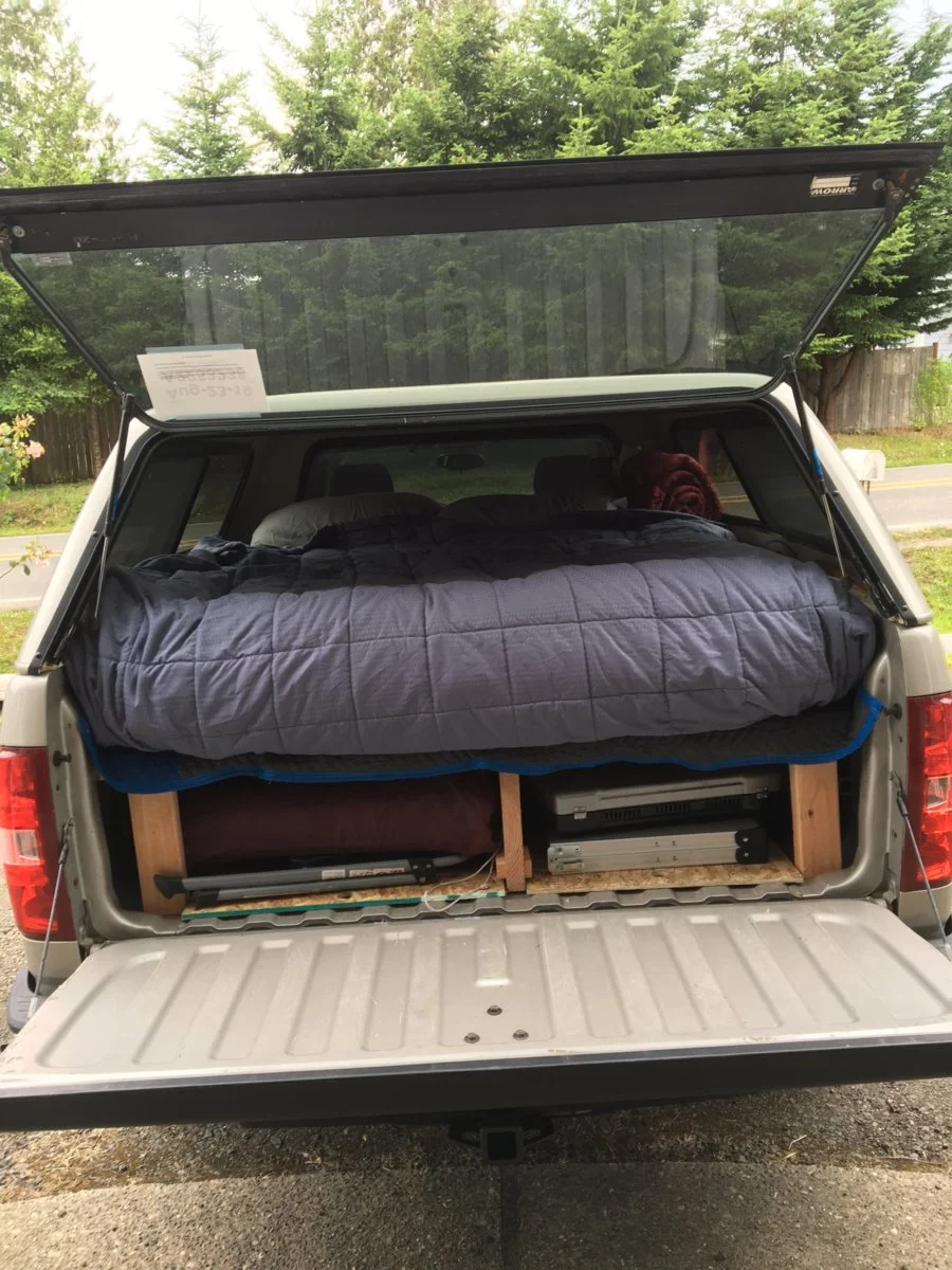

All our bedding is on a queen size Coleman air mattress, sleeping bag, comforter, pillows and extra sleeping bag. It drops to 40 here at night in the mountains so we should be snug. Side vents in the cap in case I fart.
Notes before the trip... queen size is super comfy but takes up a lot of room. The thinner mattress we had off a hide a bed was uncomfortable so we are going to look for a 4” futon or memory foam for the next trip.
I have a snug top which that it is. There’s enough room to move around an lay down, but that’s about it. Mattress is probably 8”-10” thick so cutting that down will help. We have about 24” from top of mattress to ceiling, but man is it comfortable and the benefit of having everything sent up is super nice. Basically pull in set up pop up canopy and you are set.
Heading out in the morning for Mt Baker to go camping so it will get a shake down soon.
