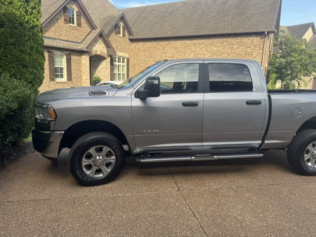

I have a 2018 ram 2500 4x4 with the 6.4 and it tows my 1997 TJ and my 2014 JKUR fine. Mine has the 4-coil suspension. I was surprised I just figured the rear would be springs but seems to tow ok. We also have a 27-foot Whitehawk travel trailer we tow also no problem. I used it off road a few times when the TJ broke down on me and it was a 2500 truck ride off road lol. I don't use it off road much, more for towing and when my road gets snowed in and the Yaris won't make it to get to work.
Anyone that know what’s going on with these tires? Dealership says it’s cupping but when I google it, it doesn’t look the same
These tires were on the front. They are easier to see in real life. Apparently the stock tires on the ram 2500 really suck. Just wondering what could have caused it.
I brought the truck to the dealer because I was worried there was something wrong with the front driveshaft. They said everything looked good but blamed the tires
View attachment 702878View attachment 702879
Have they been rotated on schedule?
Did the dealer check the alignment?
I believe those are probably the 2 leading causes of cupping.
Have a good alignment done and rotate the tires.

No idea, I've owned the truck a month. I kind of think the tires were not rotated. I've been thinking of replacing the shocks anyway so I think I'll do that and get an alignment done. The tires are cupping on the inside and outside.

WHen I experience cupping, its almost always shock/balance related.

I'm going to buy the Bilstein 5100s and put those on the truck. It will be about $440 and I hope it will ride better. I've heard that the Bilsteins are stiffer but I think that's what I need. The 5100 on the front are supposed to be for 2" lift in the front but the compression difference is like 0.3" from factory.
Next I'll wait until the fall/black Friday to buy some Michelin tires.

On the cupping, shocks and alignment will accelerate it, but just not rotating for 50k can do it too. Cupping I've had is normally on more aggressive tires and you can see the different depth between the lugs. If it's just wear on the edges, it may be because the PO drove like a crazy person on tight corners in the mountains.
Cupping example:
Ordered some Rancho RS7MT instead of the bilsteins. Only $360 out the door for all 4 so not too bad. I'm leaning towards just keeping the truck suspension as close to stock as possible. I have no desire to go offroad with it since I have the jeep. The only time I'd have it off of pavement would be when I'm trailering the jeep to some of the offroad parks.
