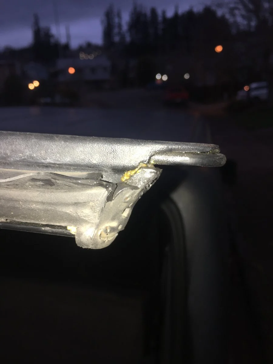

Again like I said the leak is coming from the rubber seal on the bottom.

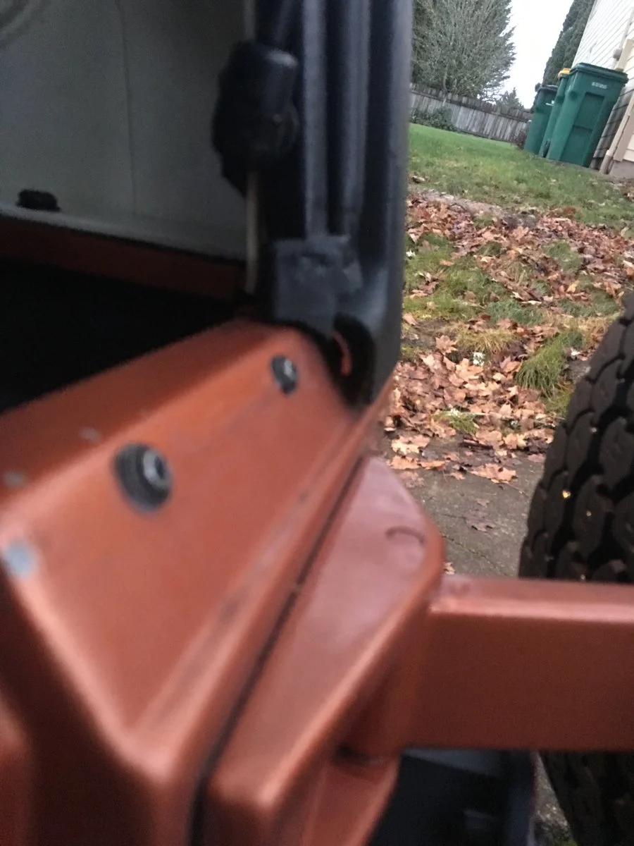

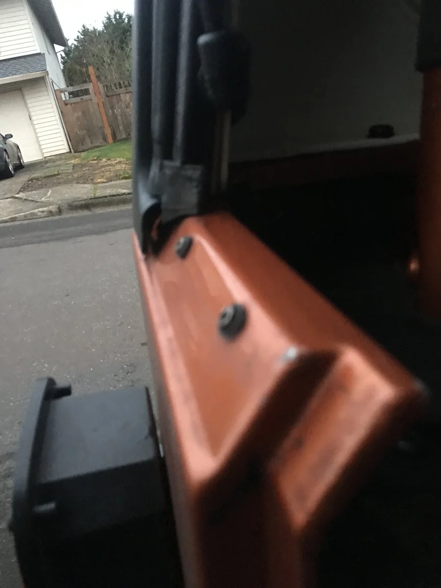

The left and right sides of the frame, The right side is definitely more out than the left side but I don’t think fixing that will do much

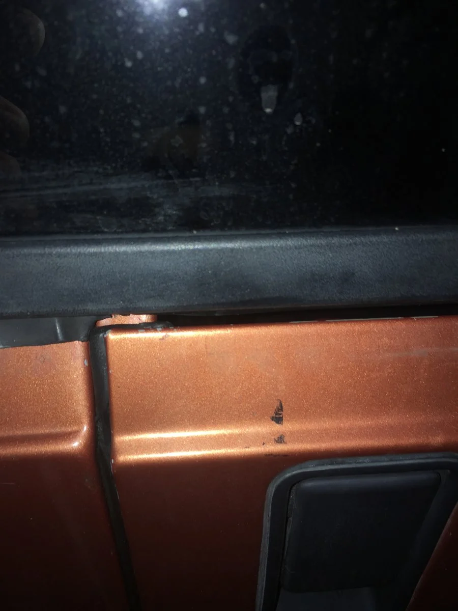

Based on your last picture, it looks like your tailgate is sagging and the window (bottom) seal may be missing some material.
Sagging...like it needs to be tightened? The window doesnt look like it’s missing material. My guess is that is what the rubber on the trunk door is for
No, like it's misadjusted. Re-read what Blaine wrote...

You should have a seal running all the way across the bottom of the lift gate...from your pictures, it looks like it isn't really there over the tailgate.

The liftgate lower trim and seal needs to be replaced. I would give you some links to the parts needed and an explanation of what is involved to replace it but my crayon keyboard is in the shop getting refilled.
That and you need to adjust the tail gate. It is low on the left side and will allow water to get in when the lip doesn't contact the seal. (I typed that really slow in hopes that you can understand it)
It looks that way because that is the problem.

What part of the top are you trying to push in? I don't see any issues in your pictures. Unless you have an uneven gap around your rear window, meaning the sides of the top are pushed out.
Also, how thick is the weather seal on the bottom of the hard top? Maybe you're sitting a little too high. Although, it doesn't really look like it is.

Turns out I figured out a reason for the prob. I need to get a really tight bolt to hold the door latch in place so that the door can fit more flush to its closed position. As for the GATE door rubber seal, there is a tiny tiny hole on the bottom which is where the leak is most wet. Just gotta super glue some shit
