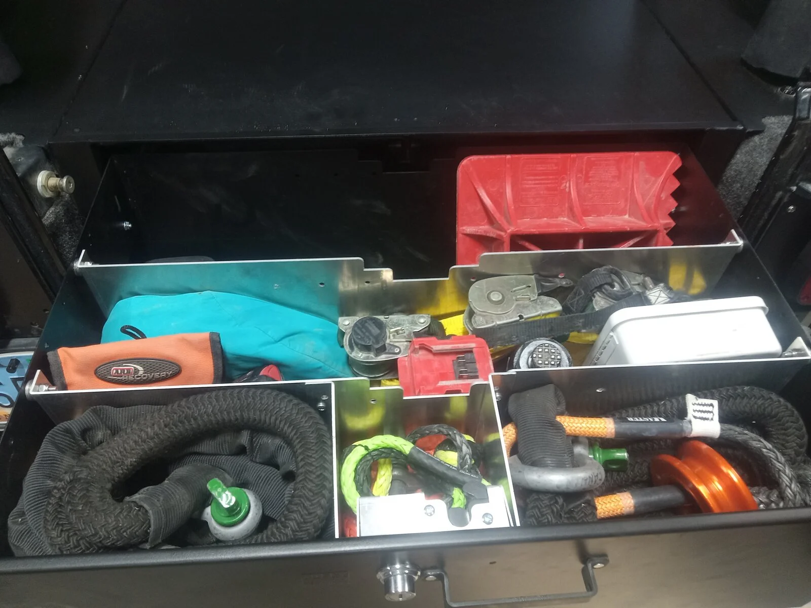

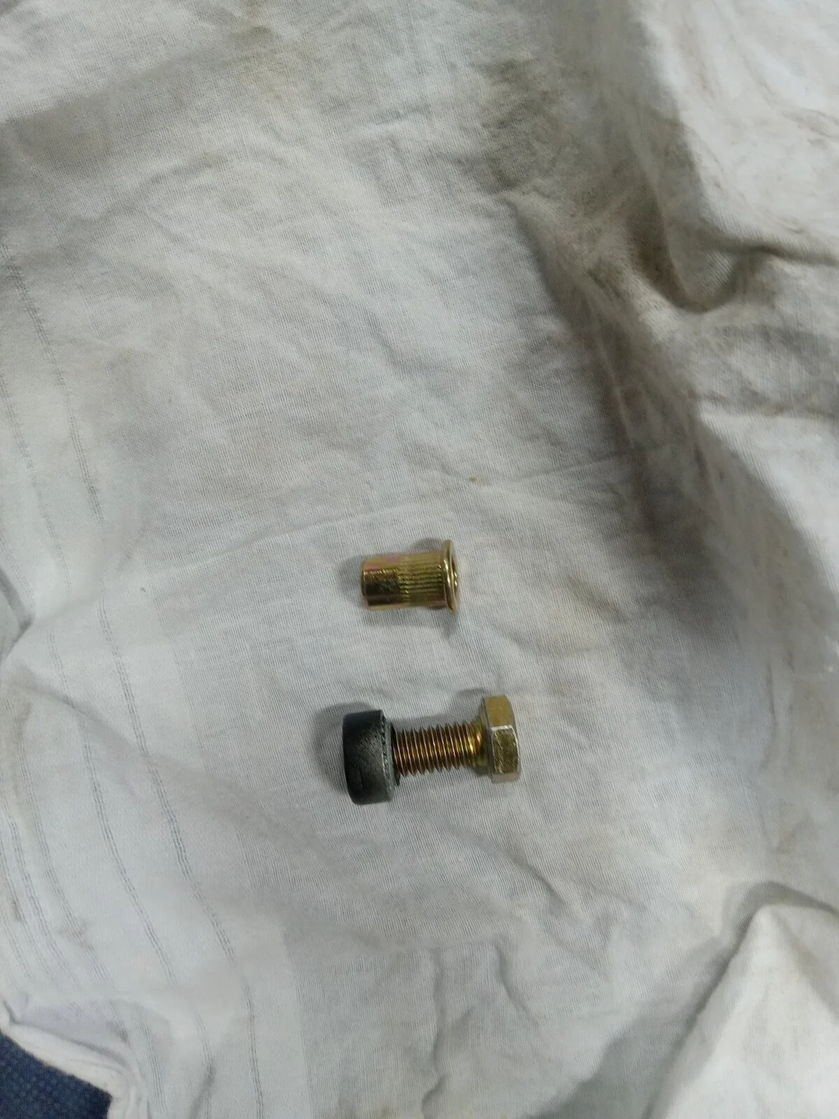

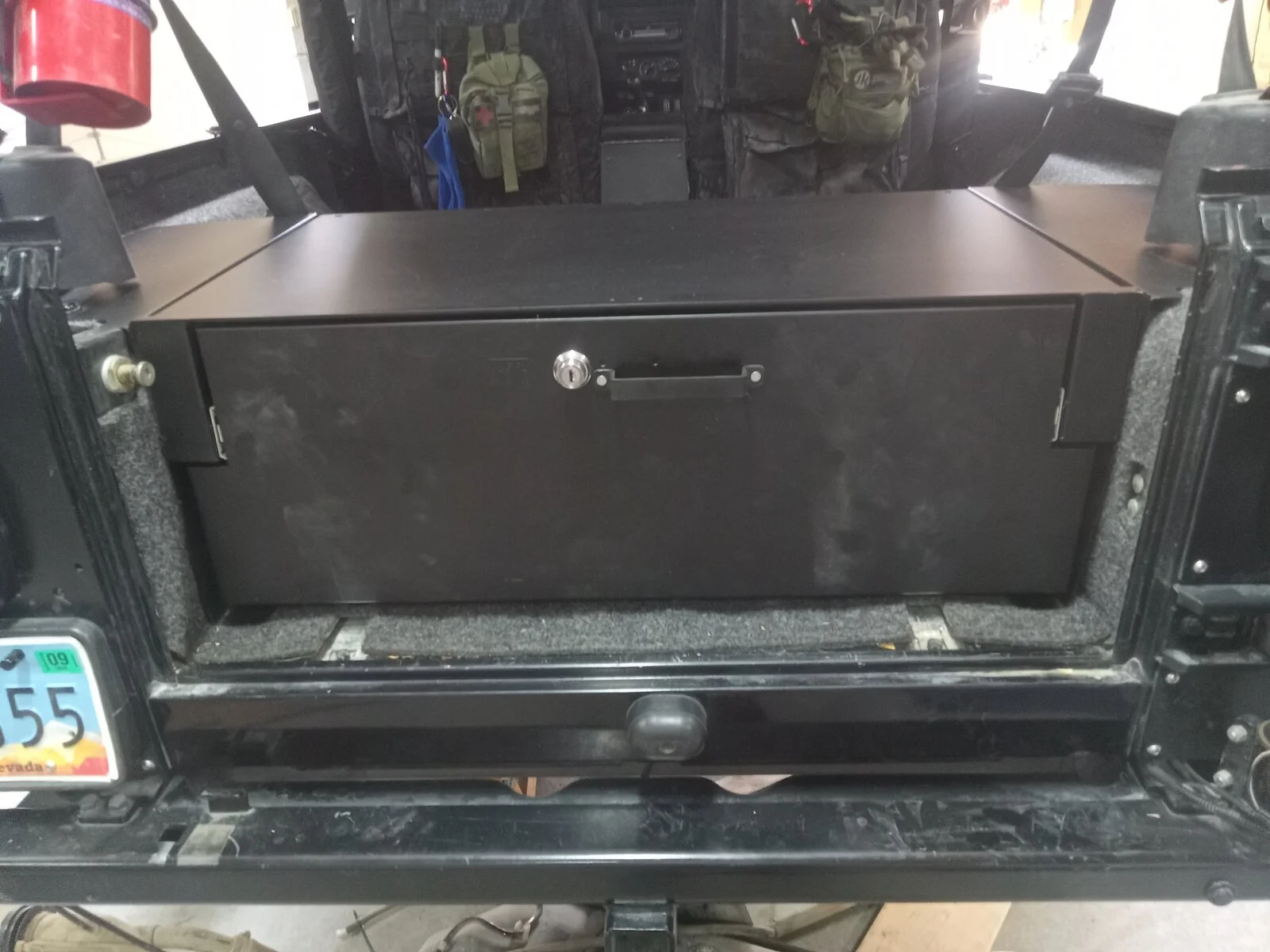

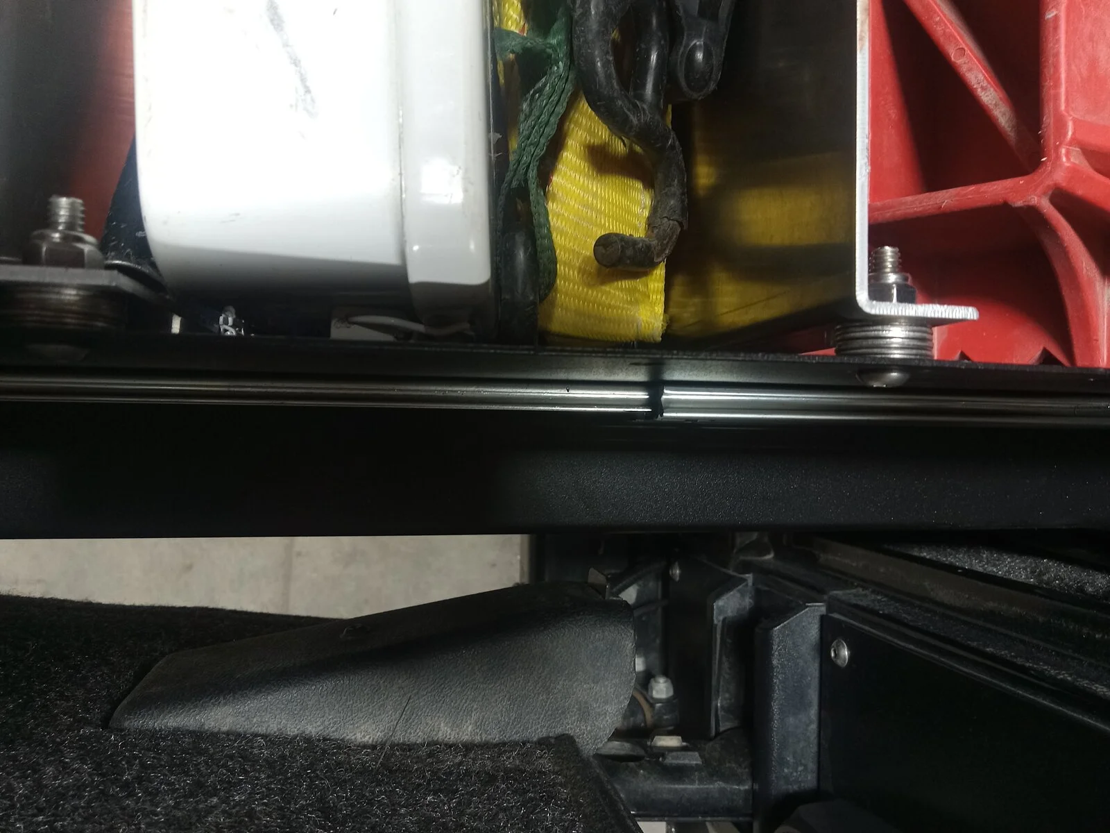

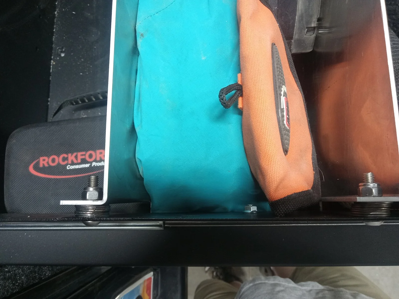

Got the Tuffy drawer installed but not without issues.
1. Nutserts they use to attach frame are cheap junk, 2 came out and was a PITA to cut off bolt and replace in the corner position. There was no way to get a grip on the sert from behind.
2. The long divider is 1.5" short and tightening hardware bows the sidewall where the track runs. I expect the drawer would bind with this. I had to shim with 7 washers per side to keep it square. Wrong divider set?

Phone call today. Scratching heads but moving to resolve.
Tuffys "pressnut" next to my rivnut.
Full 1/2" shim each side.

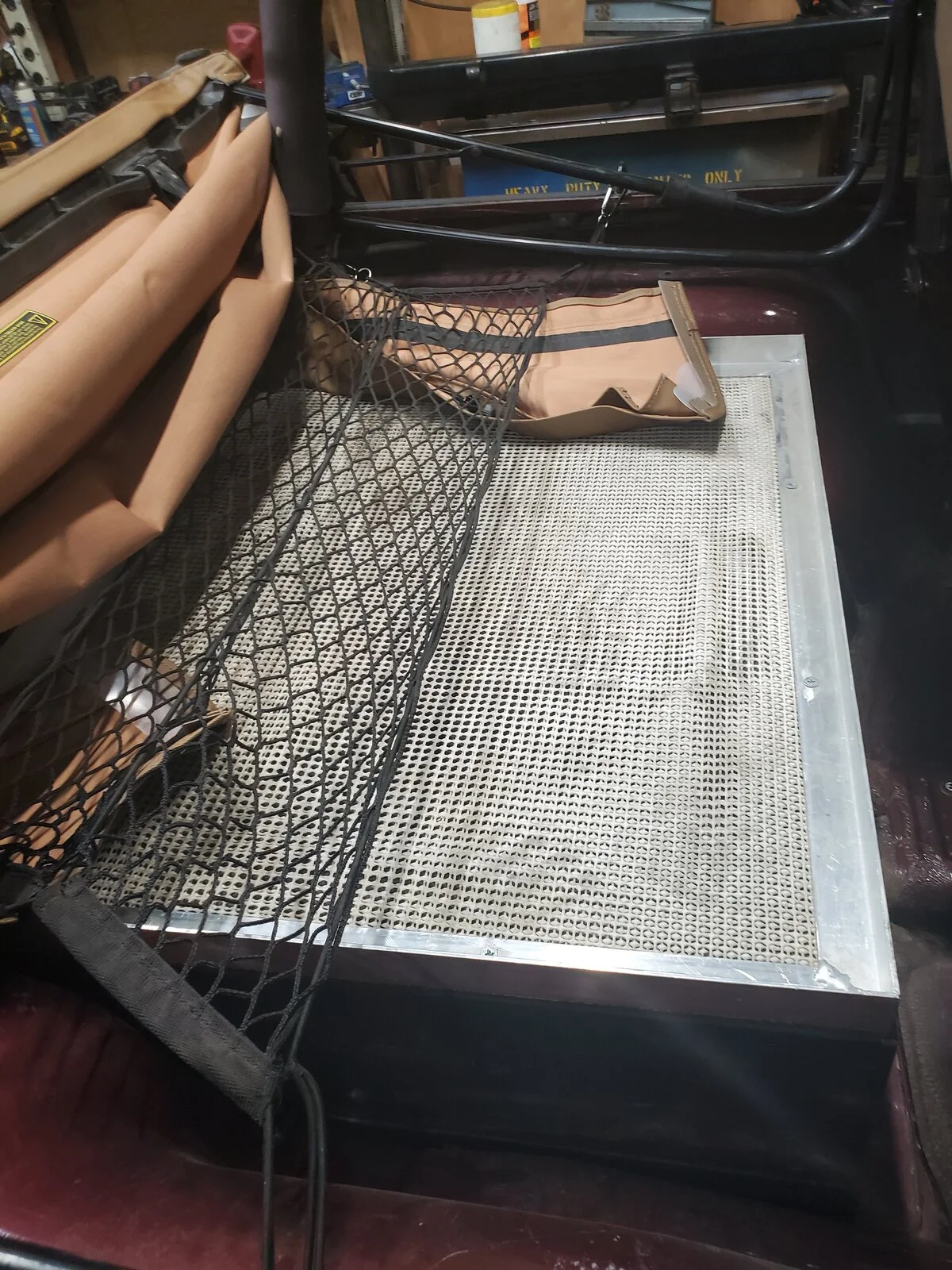

I put some aluminum angle around the top and some tacky fabric so things wouldn't slide around sitting on top of the box

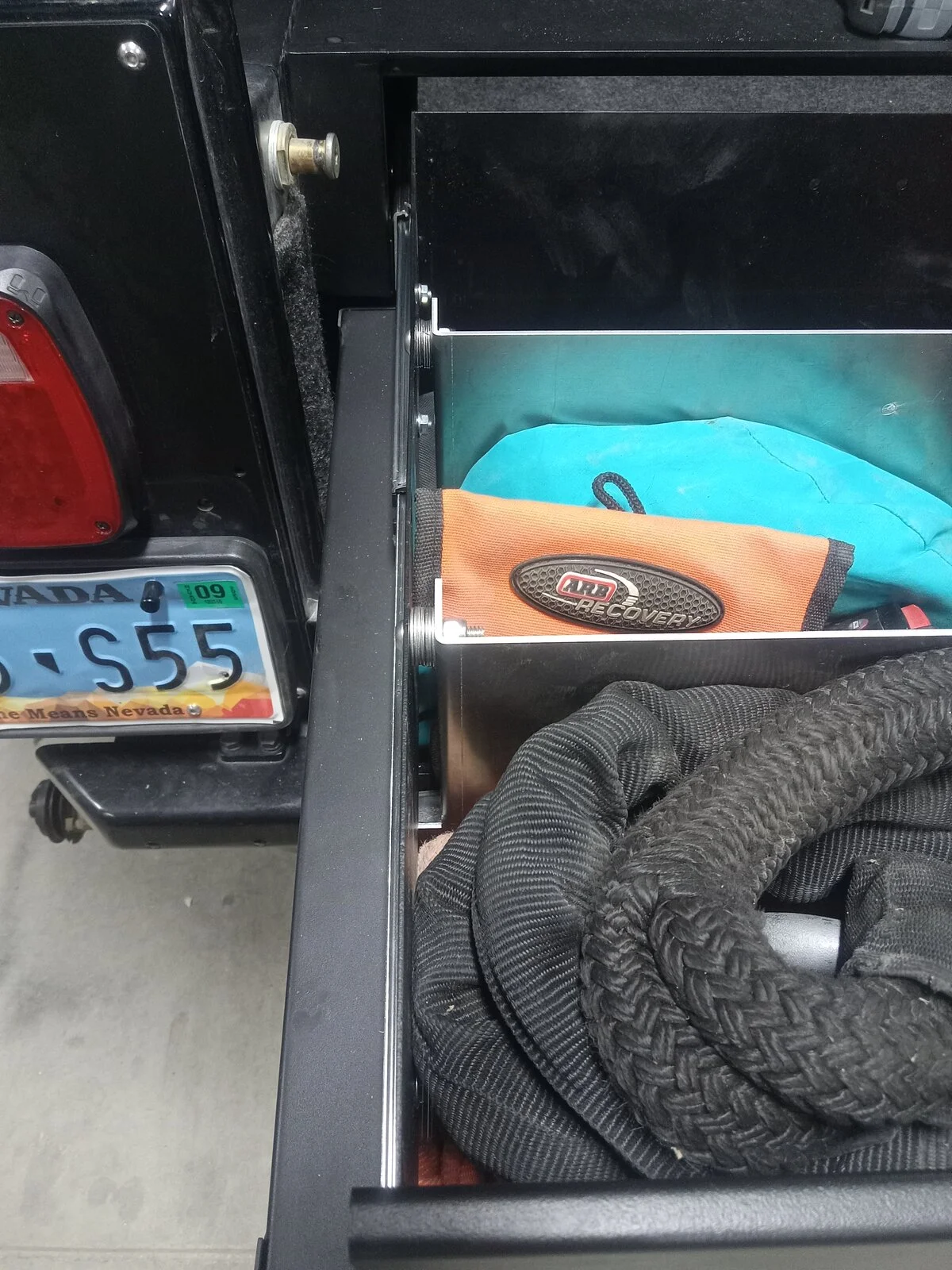

Reply from Tuffy after making them.aware, complete with pictures:
"This caused quite a bit of a stir. Apparently, no one has noticed this issue. No customers called in, nothing. But what you received is in spec to our cad.
Explanation I got from my engineers, "I’m pretty sure we’ve figured this out. In 2014 there was a move to a new slide supplier and the new slides were ¼” narrower. This meant that the drawer needed to be widened ½”. Unfortunately, the 133-divider kit was not updated to match this increased width.”
I am on the hunt for some spacers that we might have here to send out to you.
I haven’t forgotten about you, I just don’t have a clear solution yet, so I didn’t think it appropriate to reach out and say I didn’t have a solution yet."

And my solution to get rid of 7 washers on each of 4 bolts (passed along to Tuffy):

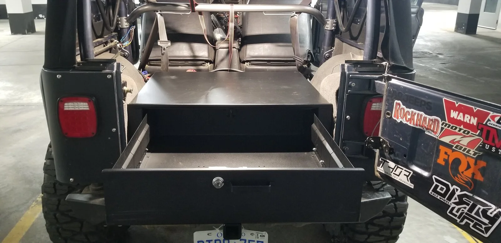

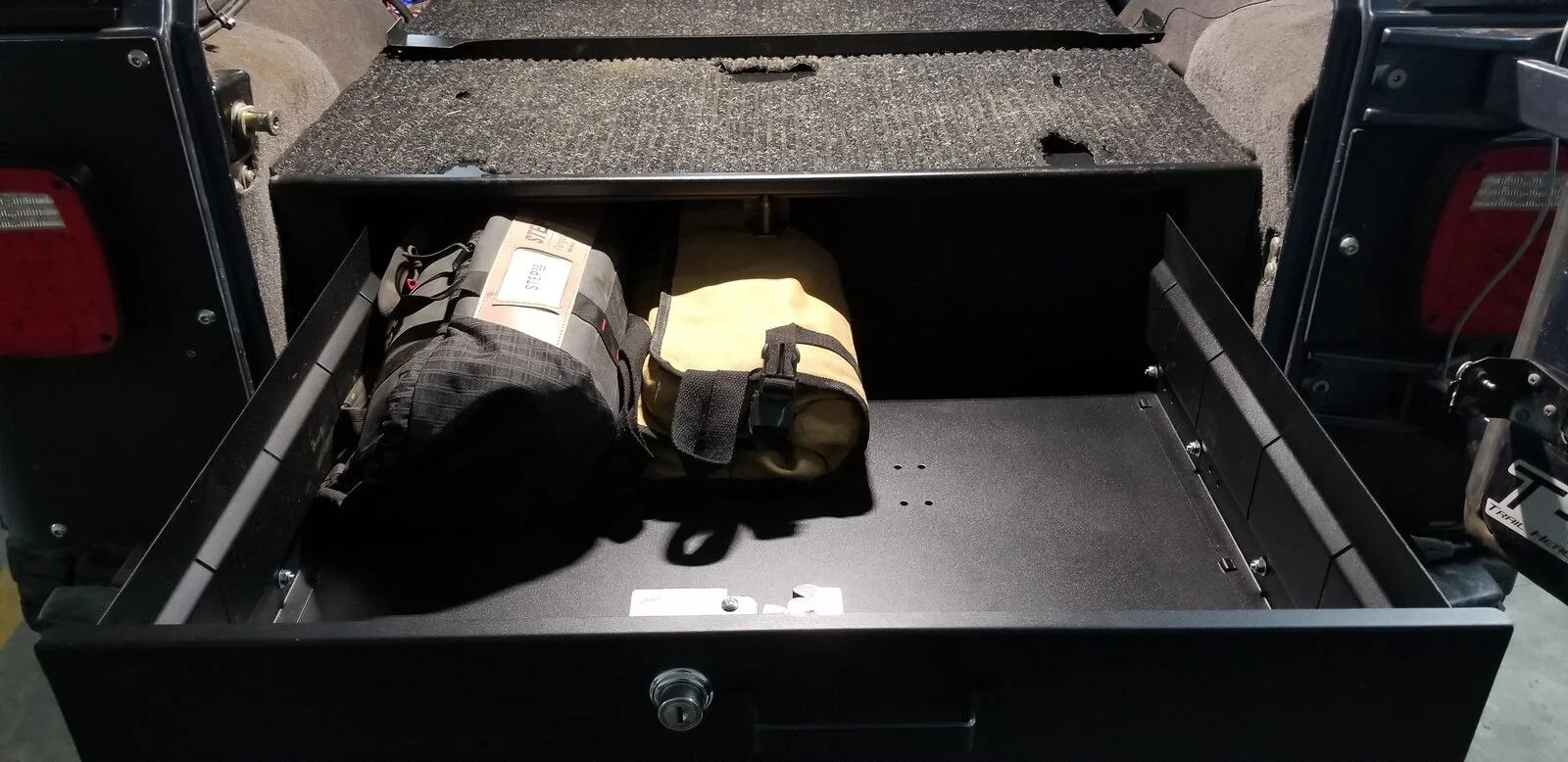

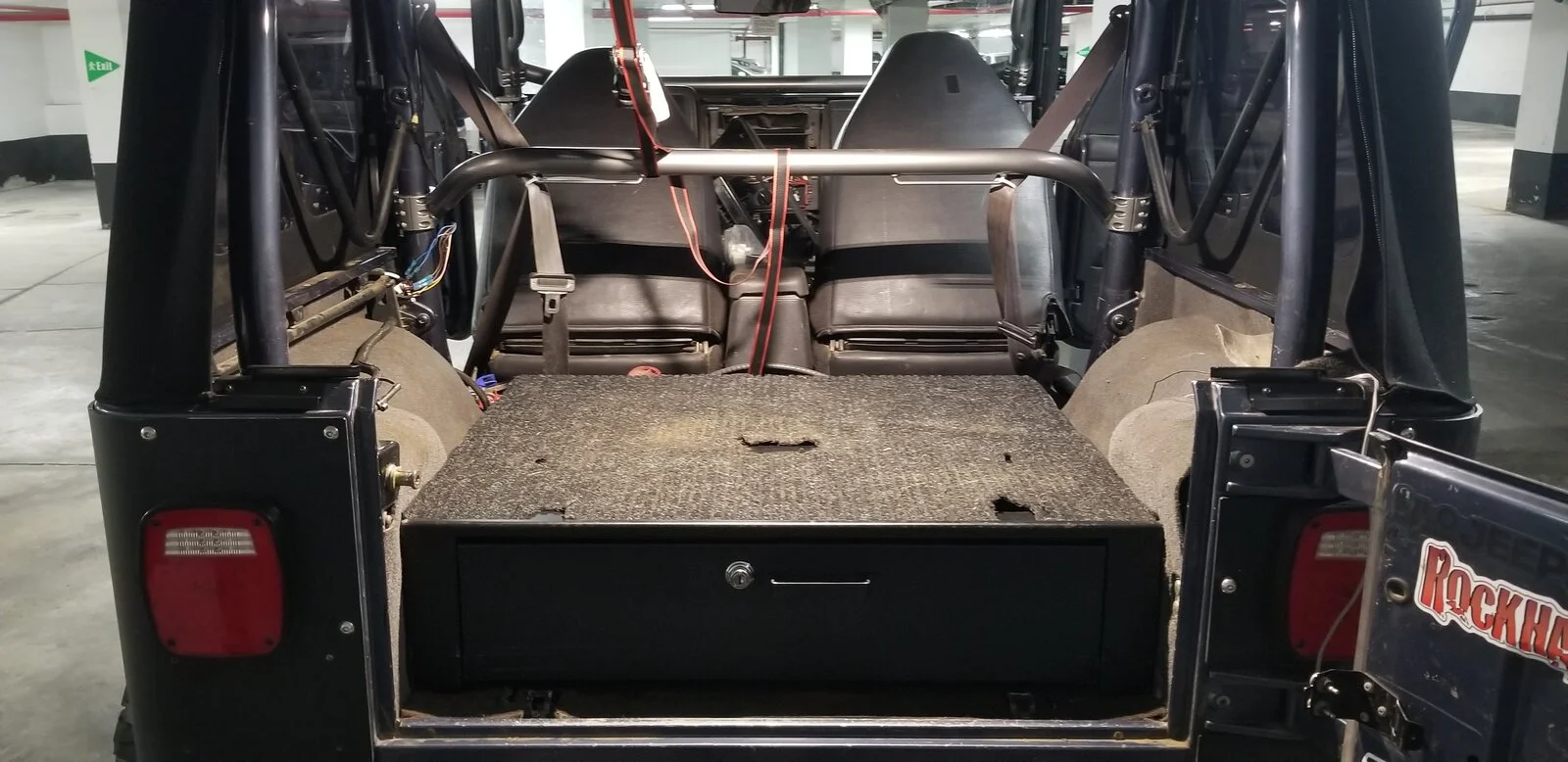

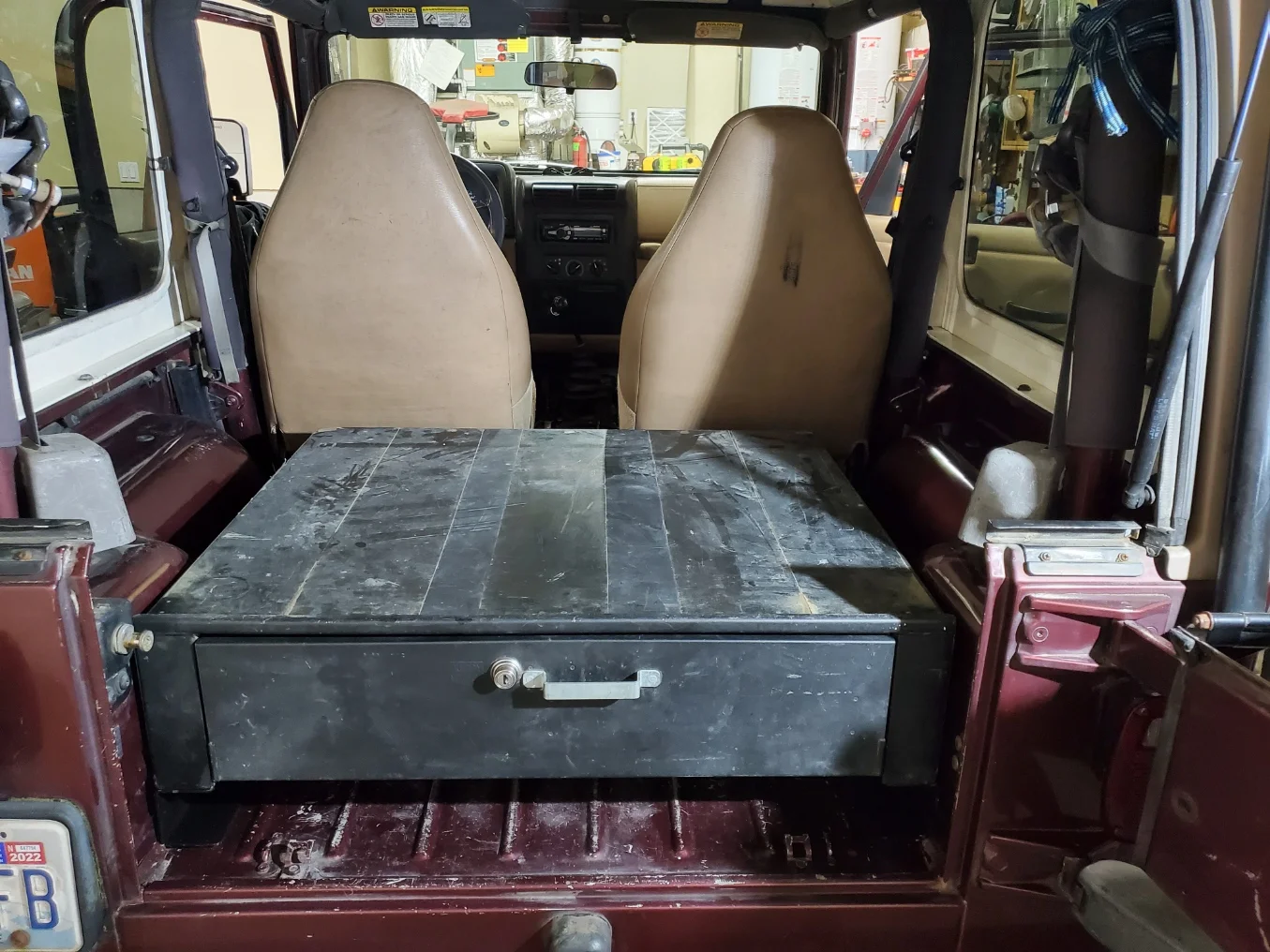

So Saturday I finished installing my Tuffy Drawer. I like the build quality overall. The size is about perfect for what I wanted. I didn't want it to be too tall so I can still stack stuff on top, or even through my spare on top but also deep enough for my recovery gear and some tools to keep in the Jeep.
I reused that $20 Home Depot carpet on top, so thing will have some friction and not make a racket.
I am in the NE and am soft top full time. For security I have opted for the Tuffy Underseat Concealed Carry draw for things like my iphone, keys, wallet, flashlight and other small items. Out back I have the Bestop Instatrunk because I want to keep my back seat. InstaTrunk is tiny, but it is stout enough that I don't worry about the few things I have in there. I might be willing to switch to a shallow full length drawer if I could mount the seat on top of it.
