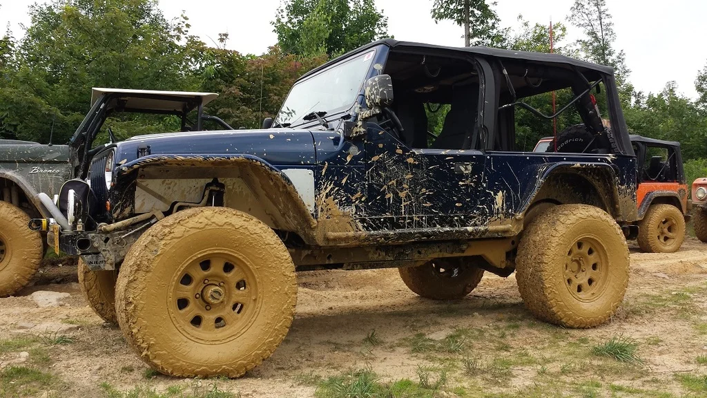

This nailed it. I spend 6 - 8 hours wheeling, then two to three times that bringing the Jeep back to my happy state! :(
I've got a buddy and every time he goes with me he wants to get into some mud hole and we end up cleaning up for 3 hours for 25 minutes of fun...
I don't go out looking for mud... But that's just part of it.

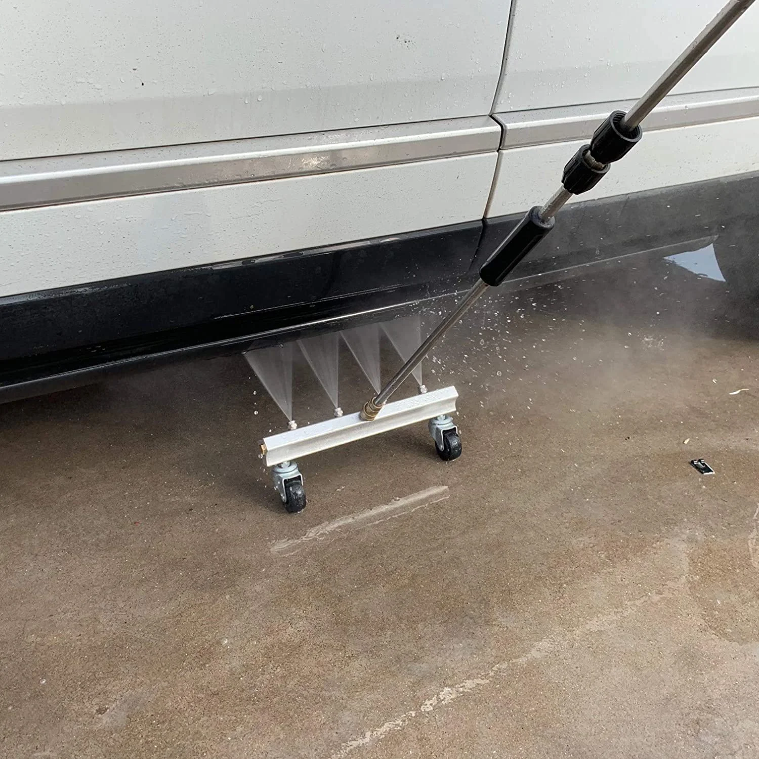

I have also herd that people use a lawn sprinkler and let it run for awhile, I have never tried it but is sounds like it could work.
Use one of these.
Its not high pressure so one must run the sprinkler long enough to soften the crud - long enough to drink a beer maybe two - then a regular hose with high pressure nozzle will do the rest.
