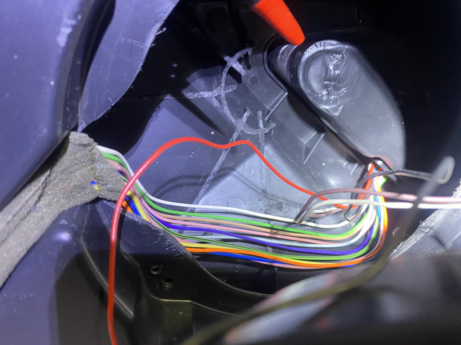

Yes, with modifications. I had to break out the ribs and also melt the plastic cover for the amp (I’m still using the factory amp for the time being). You can see that in the picture at the tip of the pen. Obviously, if you use a different amp you won’t have to melt that piece.View attachment 227766

If I had a nickel for every time I heard that...🤣
Lol that's good to know.
I'll prolly just cut it out flat and 2 part epoxy some abs flat across.

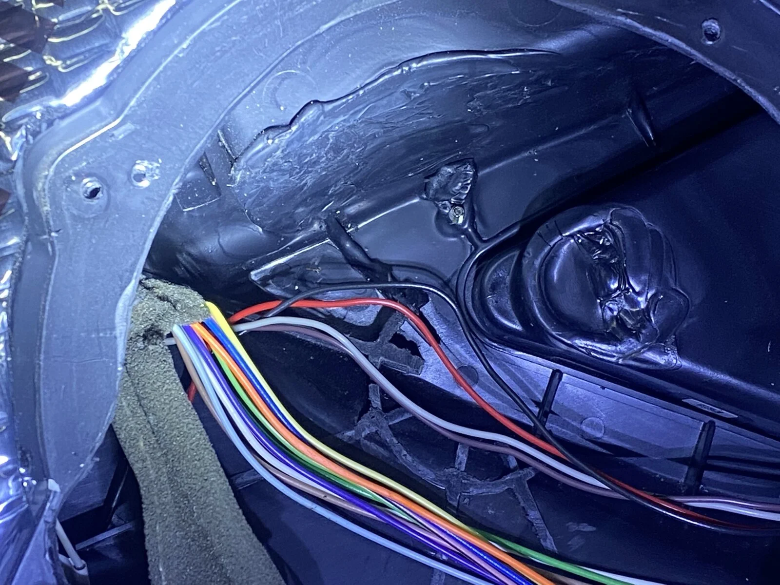

I also had to melt & reshape another area to accommodate the magnet. This is inside the top when the enclosure is sitting upright. It is under the storage area when the console is in place. You can see it at the top of this picture.

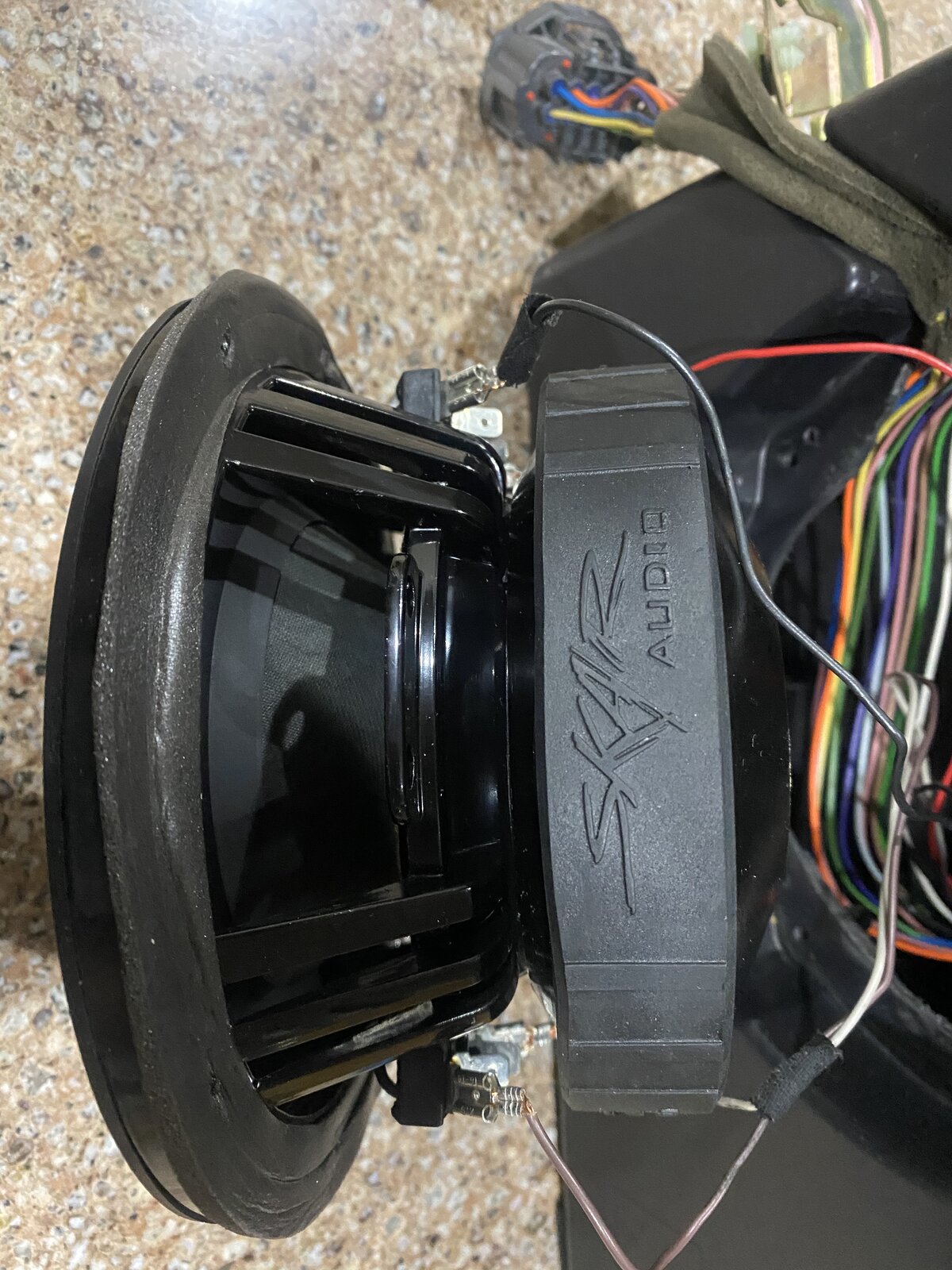

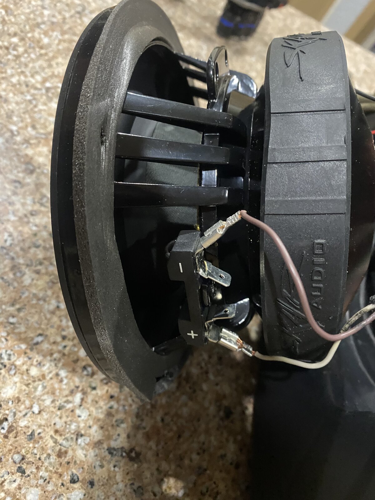

Coming back to this. Do I need to do anything different with the way I have my sub wired? I have terminals on both sides of the sub just like this:View attachment 227762
you might be able to see both sets of terminals a little better on this second picture.
Do I need to run a wire from the unused positive terminal on one side of the sub to the other unused positive on the other side and do the same with the negatives?

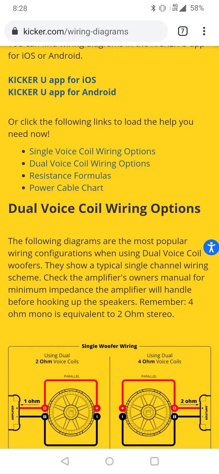

If I remember correctly the stock amp is rated at 1 ohm and 70 watts, so while not a wise choice to use, you should wire in parallel as you mentioned.
The unused Pos should be wired to the used Pos, that is connected to the amp. The unused Neg should be wired to the used Neg, that is connected to the amp.
Your sub will, in theory, pull 2 ohms when wired like this. See picture:

The factory sub had 2 positive and 2 negative terminals. And there were 2 positive leads and 2 negative leads coming from the amp. I basically wired the new sub the same as the old sub.
Even though there are 2 positive terminals and 2 negative on each side, there is only 1 wire coming from each terminal. And the terminals seem to be 1 piece if you look at the bottom.
