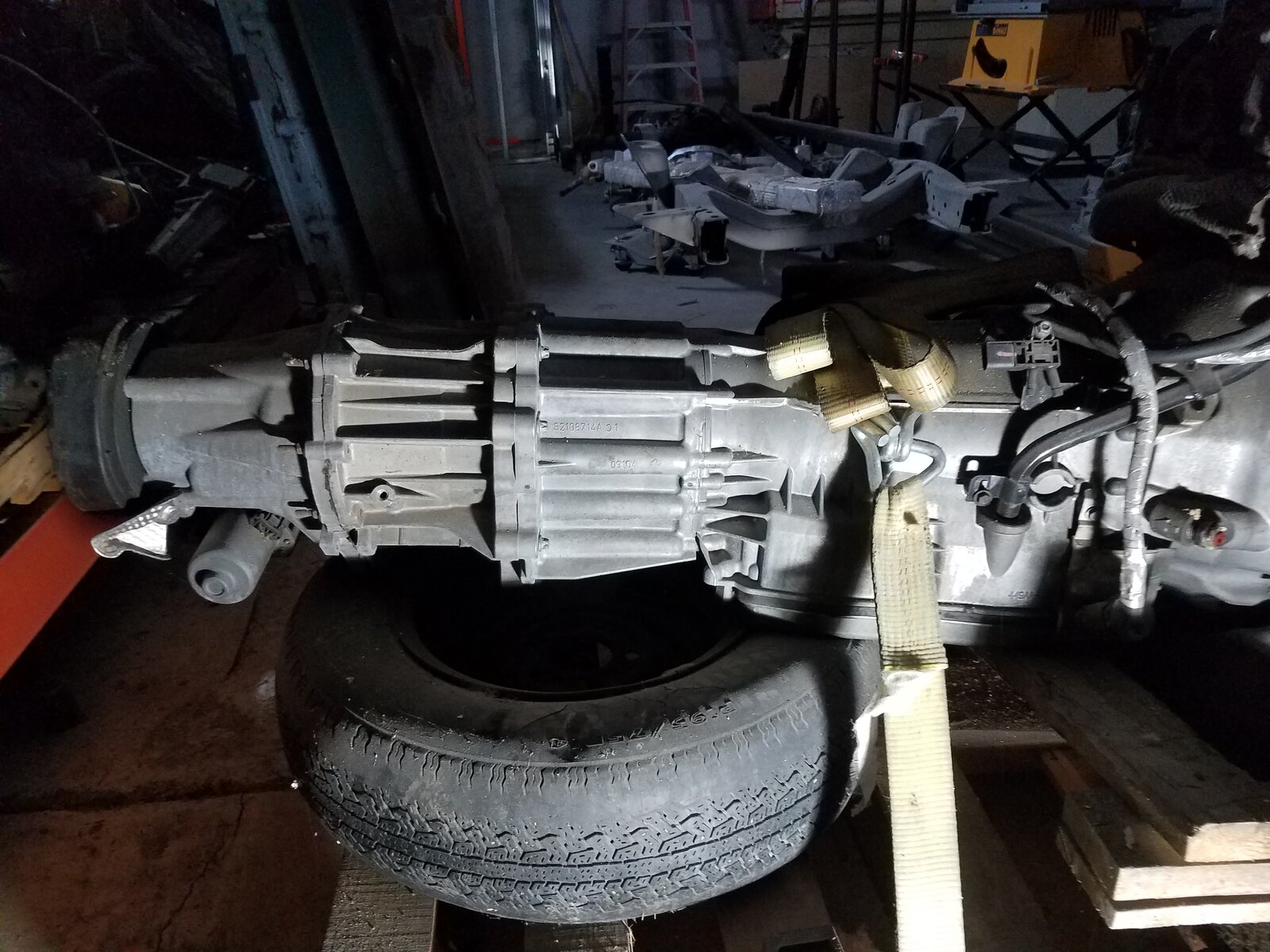

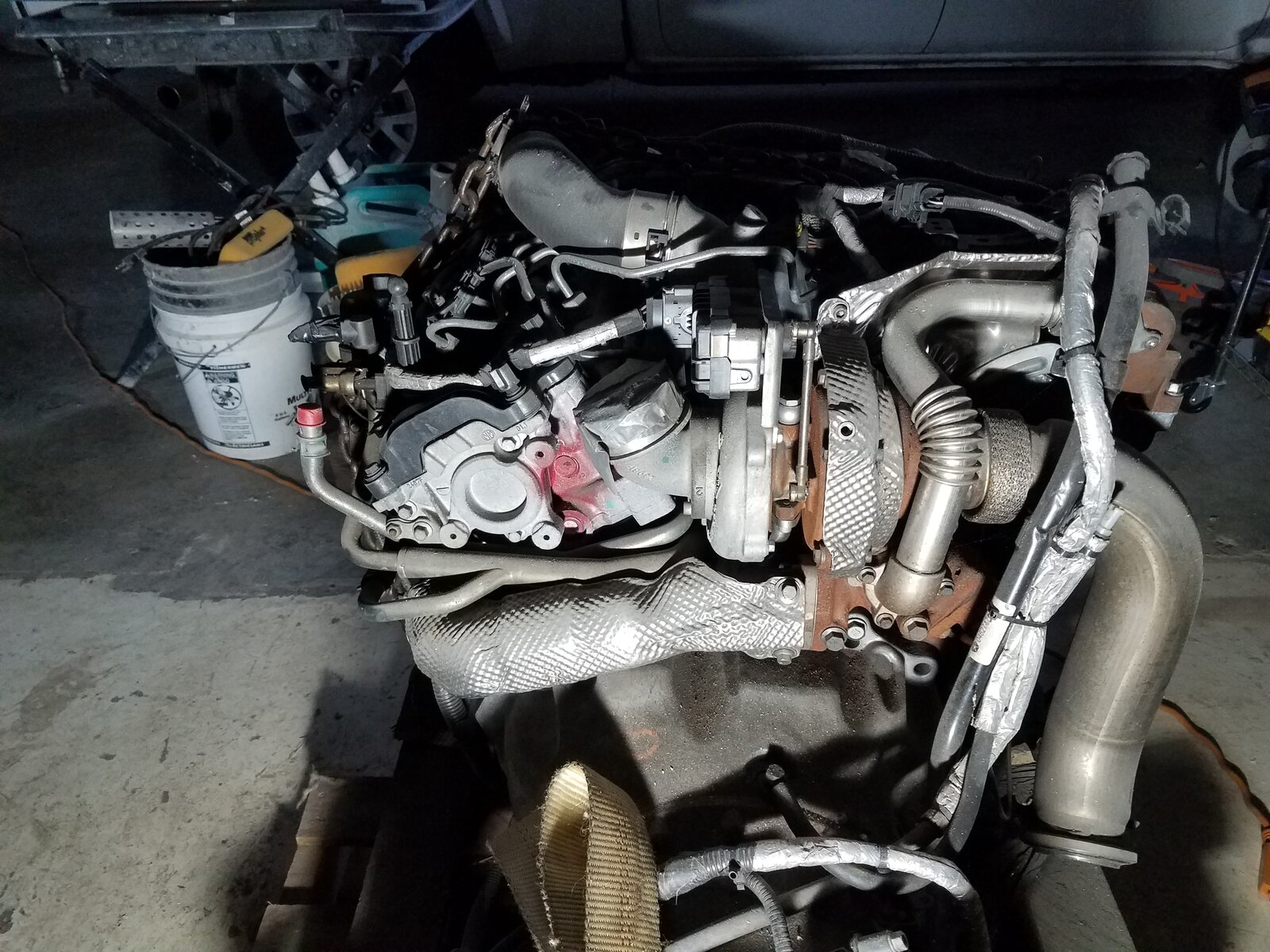

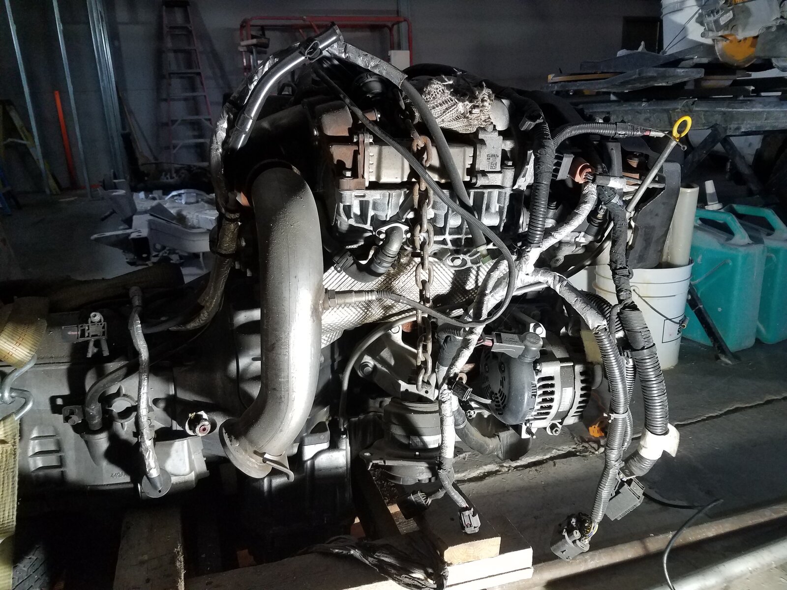

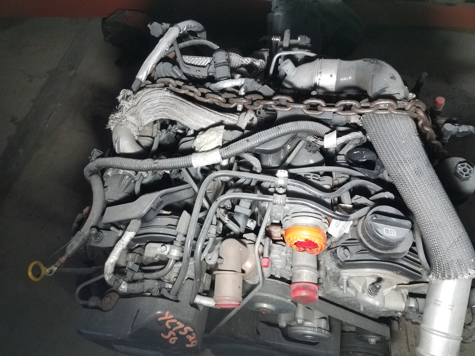

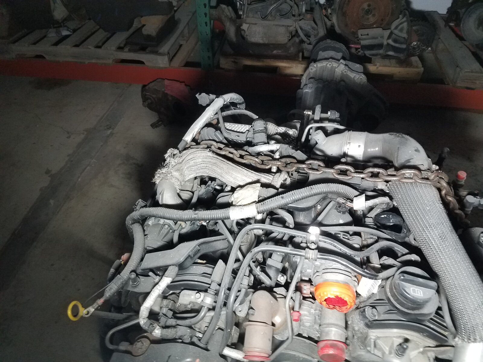

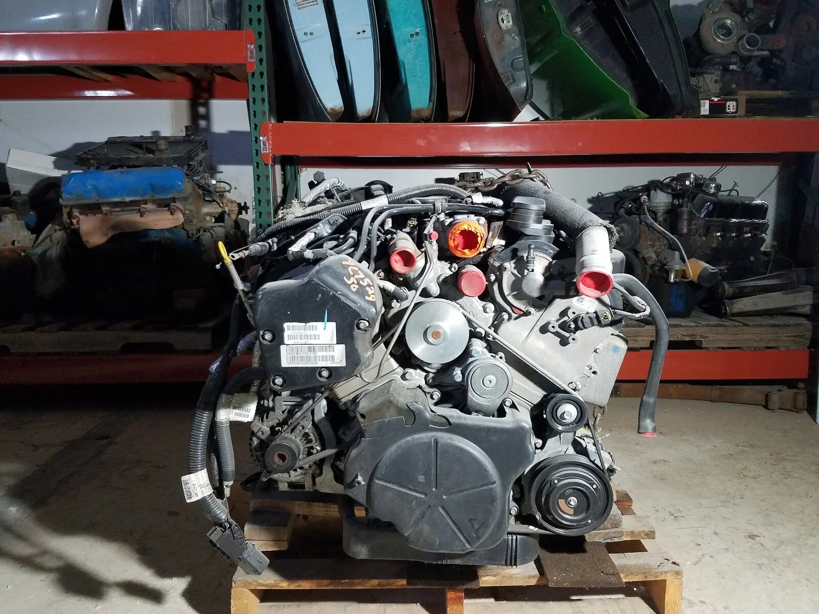

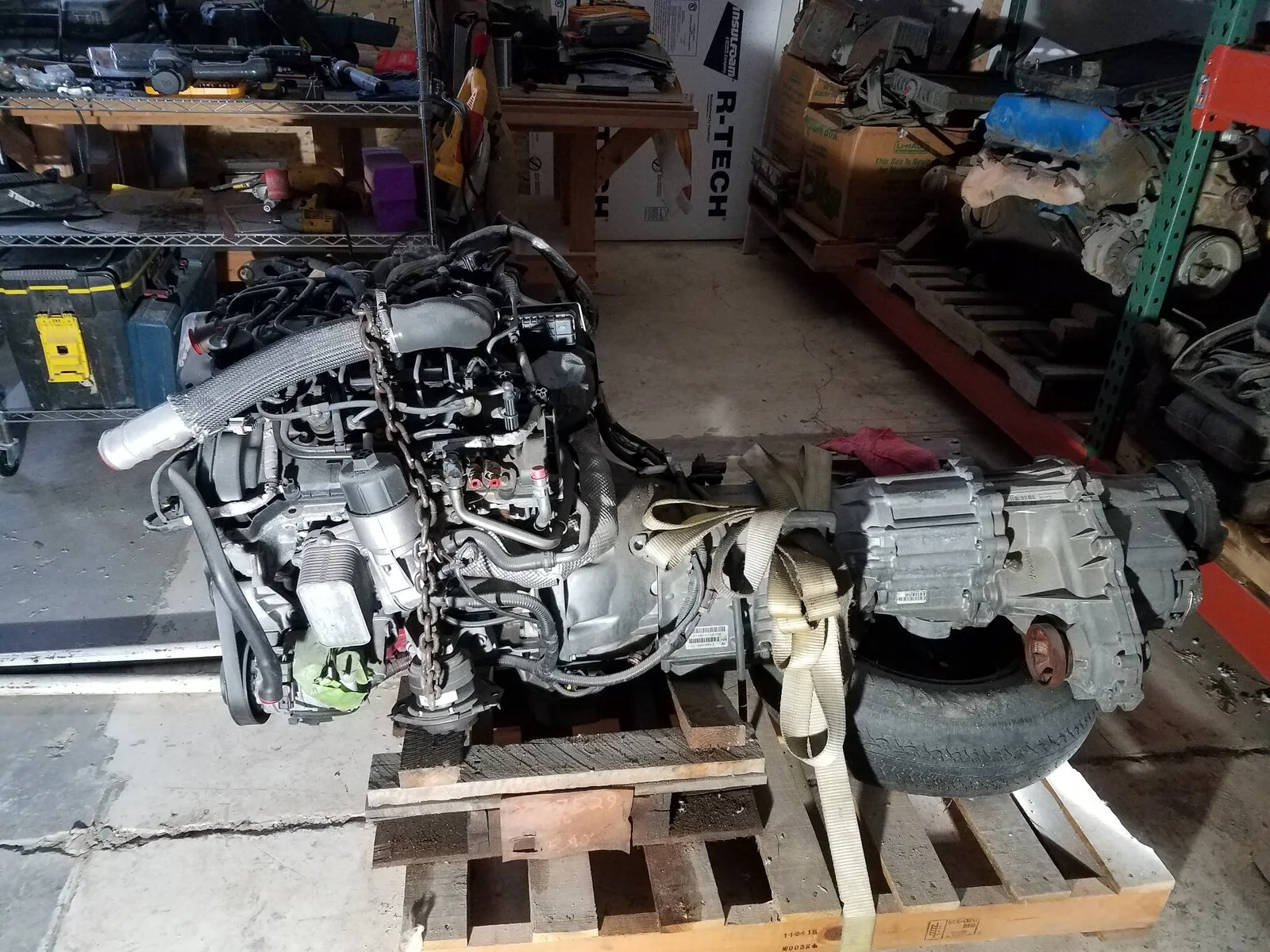

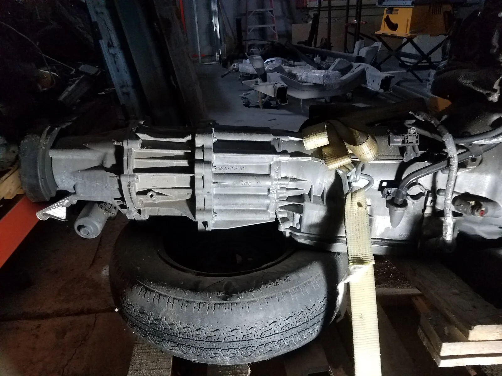

I've got a brand new VM Motori V6 24 valve Turbocharged. Carbon graphite compacted block. 241 hp 406 foot lbs torque. The whole motor weighs under 500lbs. I have the motor, 6 speed automatic transmission, transfer case, ecu, front half wire harness, gauge cluster, telescoping tilt steering wheel and floor shifter.
Everything it would take to make it run. It's the same set up they put in dodge ram and the jeep grand Cherokee EcoDiesels in fact it was in a Cherokee. I was going to put it in a 2012 JKU. If your looking for a conversion this would be the one.
The only reason I would sell it is I broke my neck several years ago and my priorities have changed.
If your interested get ahold of me? I'm probably going to list it on the forum.
