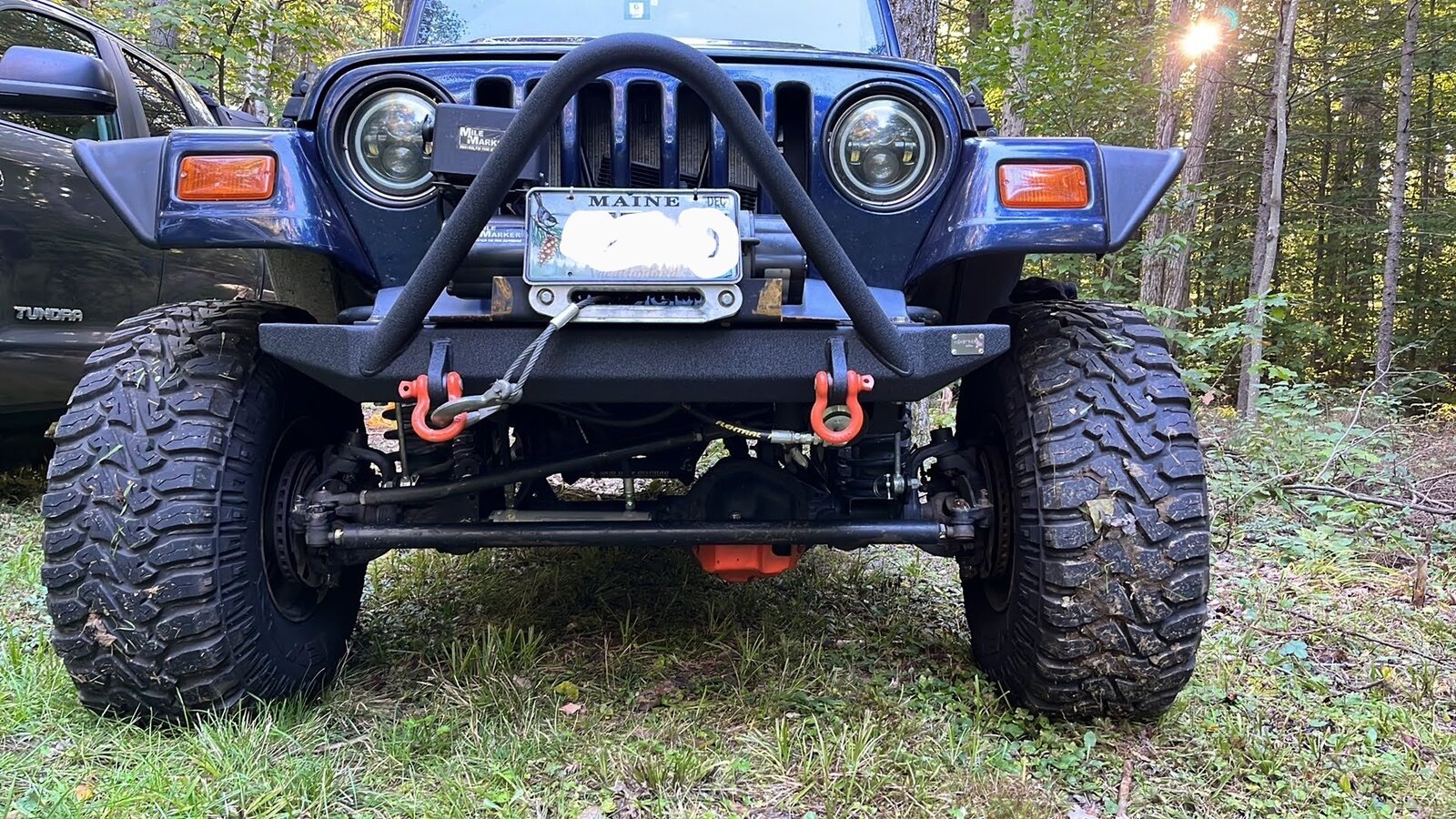

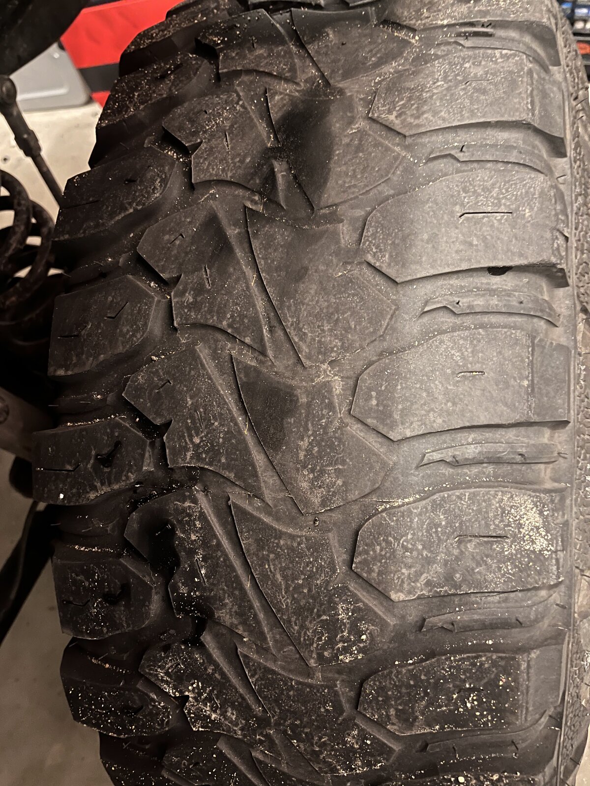

Should this warn kit have a wheel spacer? I have an 8.8 rear with an Adapter/spacer I am ok with leaving the rear spacers for the time being.
Questioning the spacers upfront due to tire wear, turning radius is increased and i believe the scrub radius looks excessive.
Thoughts and ideas, thanks

Anytime you can see the whole rotor outside the rim, it likely isn't going to steer and drive in an acceptable manner. That and your balljoints hate you.
