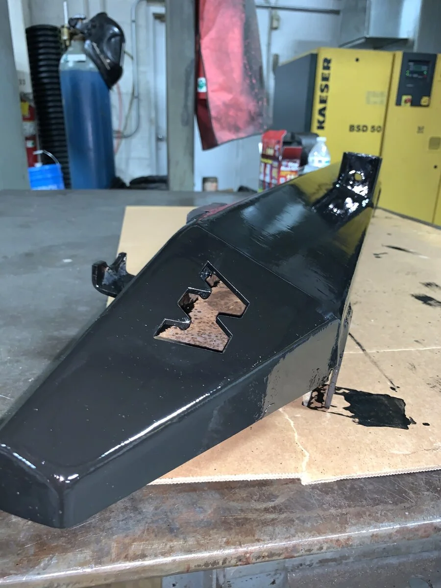

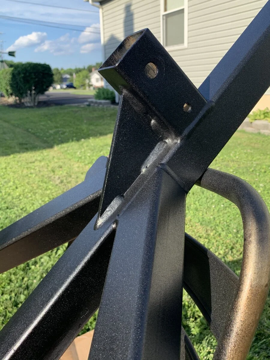

Just waiting on paint to dry. Sprayed the tire mount and carrier support bracket.
Reactions: JMT and Alex01

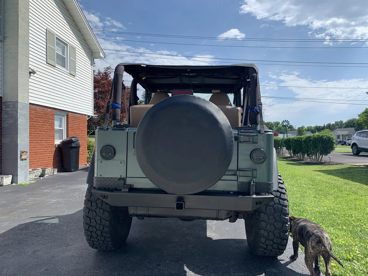

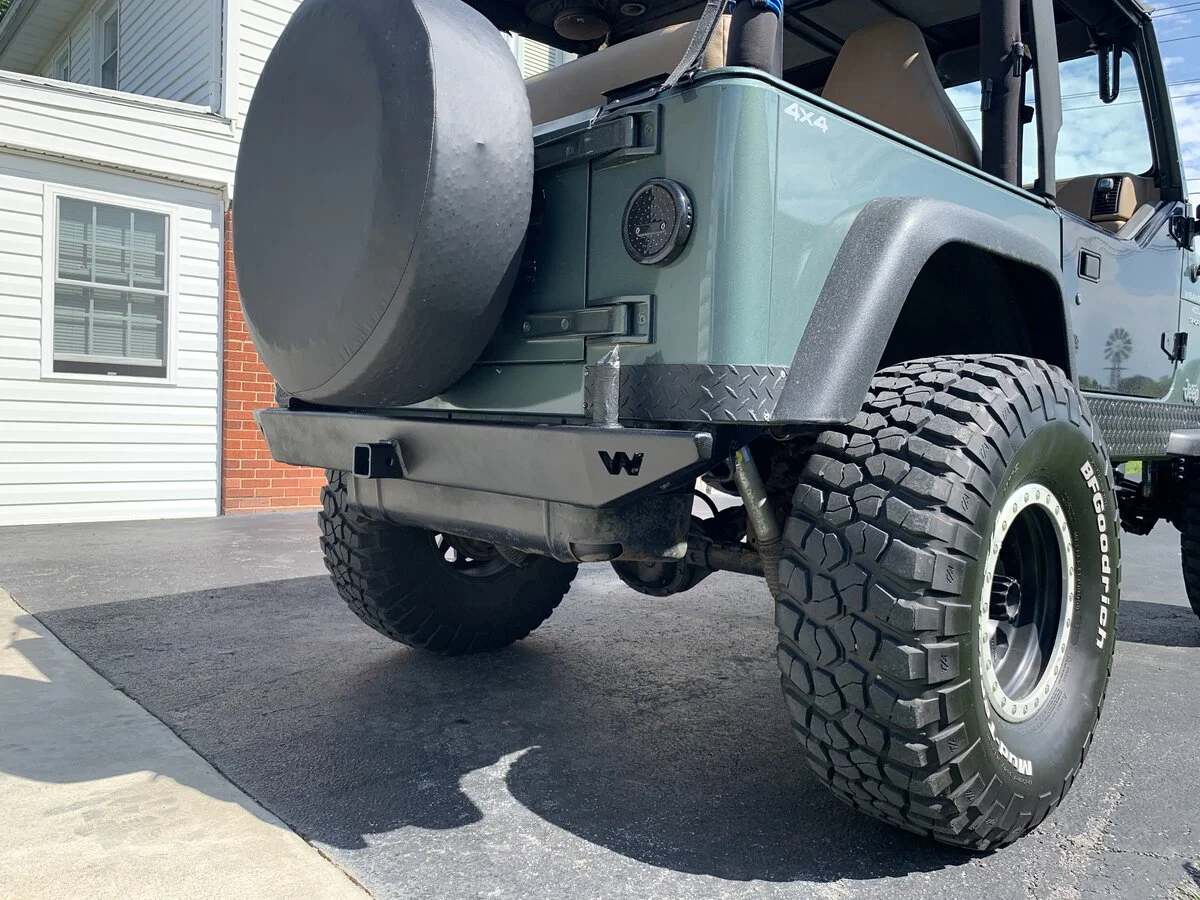

All done! Turned out pretty well considering what I started with. Has a couple small “issues” I’m not particularly fond of, but I’ll make some adjustments later on 😁👍🏼
Here’s my “issue”. The carrier has some slop in it and is causing it to tilt out about 1/4”. I’m not sure if replacing the Teflon bushing that the carrier pivots on would help correct this or not. I’m going to put some washers under the tailgate snubber to snug it up for now, but after my trip this weekend I’ll probably turn a new bushing and make it a bit thicker push the carrier up into the support bracket a little. I’m hesitant to go too thick though due to interference/drag from the support bracket. Maybe that’s better than a flopping tire though.. 🤷🏻‍♂️
No tire:
Tire mounted:
Reactions: JMT
Added some washers behind the one tire snubber to prevent any rattles. More of a temporary solution for the next week or two. Finished the evening off with a quick drive to grab some better pictures of the final setup
