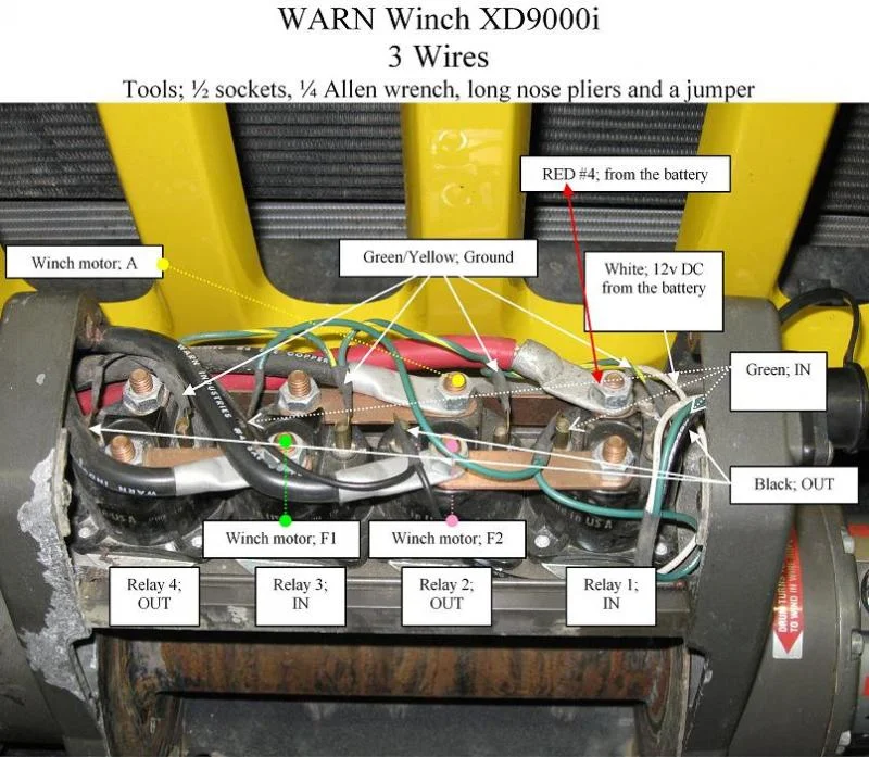

My bet is a faulty solenoid. I found this handy reference so I know where to look first. Something with 1 or 3.
Reactions: WSS
Found the solenoid. #3 in the photo above. It clicks to close some times, not other times. That's why it worked for a while then stopped after painting. Easy fix once I get the part. The other number 1 is not original either. Made in Mexico and the others say USA. It could be a cheap replacement so I'll buy a pair.

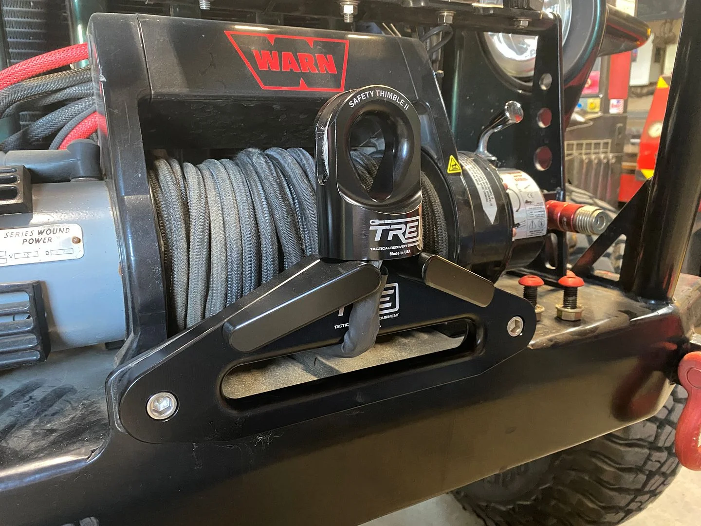

On to installation and getting rope on it.
Almost done. I need to take the bumper loose to get the back bolts in. And route cables to the battery. It's tight. I may unspool to remove a section and make my own soft shackles.
It cost more than I thought but doesn't everything. I learned a ton and like what I got in the end. Now I know everything about my winch.
I don't see a big change in my rake so HD OME springs and synthetic worked. I love the safety thimble and fairlead storage. Worth every penny over cable and hook.
Oh and the made in Mexico solenoid.... well. Spend the extra $10.
I'm glad I bought 2 warn stamped parts.

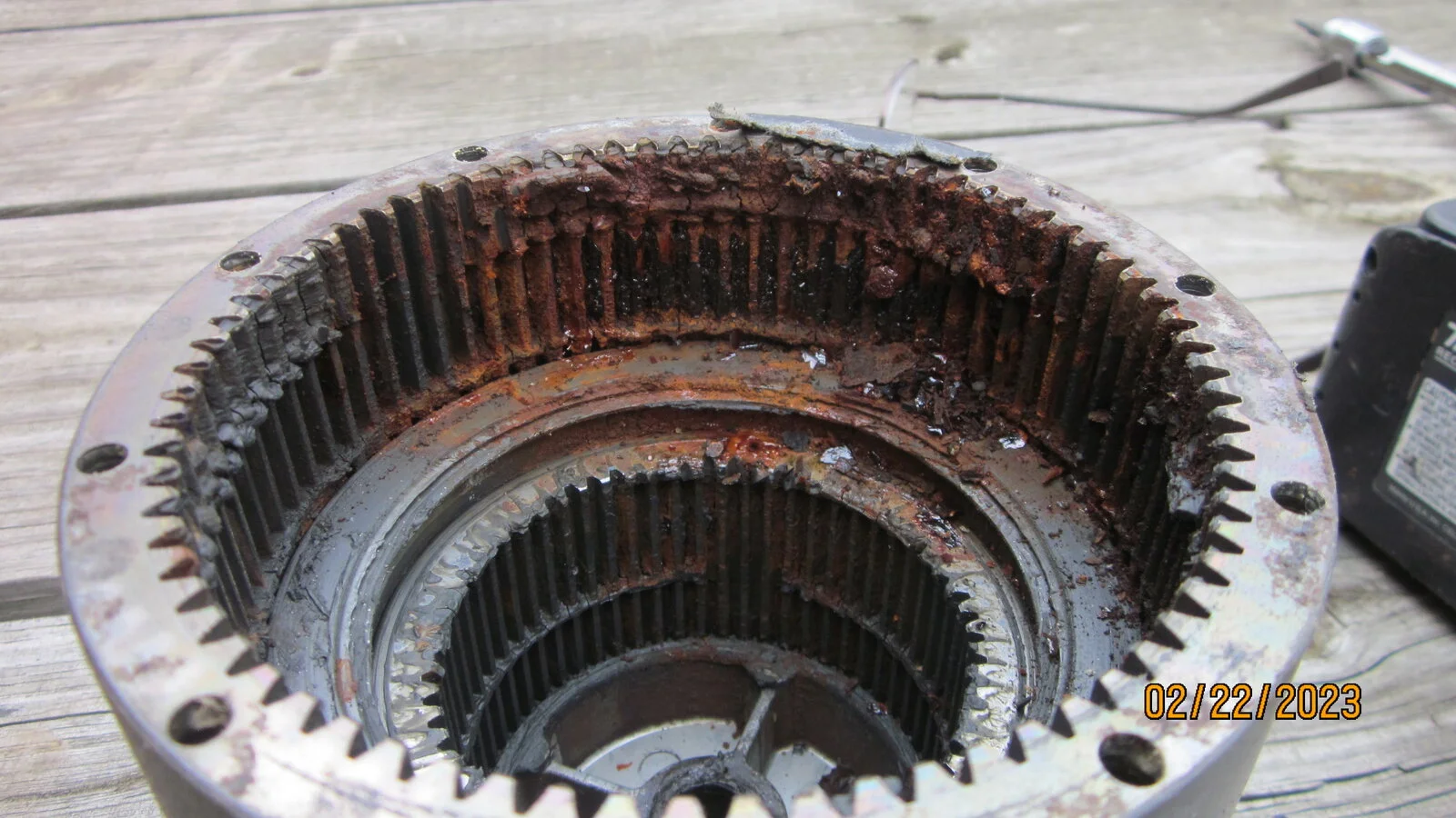

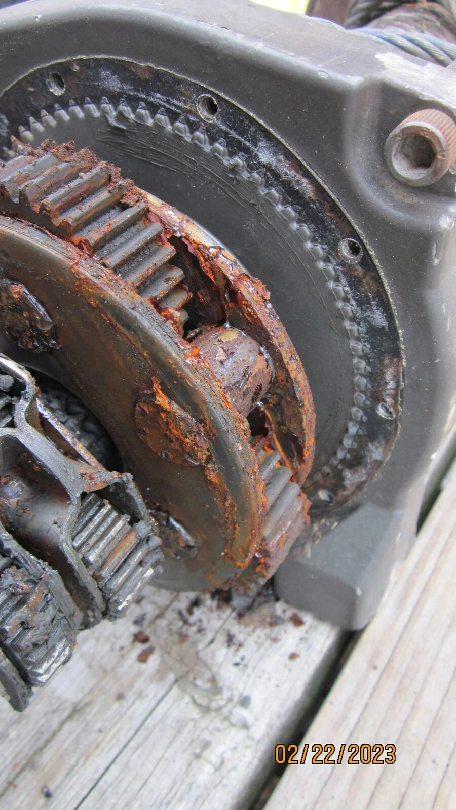

I soaked them in mineral spirits to get the old grease to disolve. I used an old toothbrush to work it in and get stuff off. Then let it dry to see where I was.
I am lucky enough to have access to a solvent tank but if I did not this is what I would do as well.
