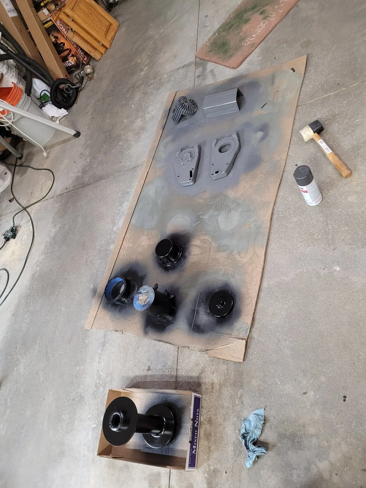

Two days of drying. I lightly sanded the pieces. The rest had some minor thin spots so I put another coat on. These pieces were good so I put the first coat of black on. Which grey should I go with?
The darker gray is generic Rustoleum. The lighter gray color is Krylon acrylic enamel like the black.
Or I could go all black.
I'm going to wait a day, lightly sand, and repeat the process for three coats. Then 2 clear.

My vote is the darker gray. Looking great. How much are you going to charge yourself on the labor?? An expert paint job ain't cheap.
I'm going to go look for a darker gray enamel machinery paint. I'm planning 2 tone with the motor and gear housing black and the rest dark gray, including the motor cooling fins.

Thunder and rain today so no painting in 100% humidity. I'll let it all set longer to make sure everything dries before a second coat.
I found a charcoal gray I like so I'm going to use that one.

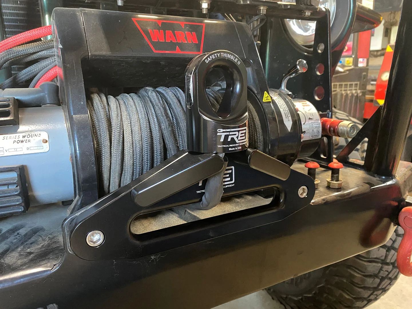

I'm ordering synthetic cable. The winch came with 125 ft of cable. I'm assuming I can only get 100 ft of 3/8 synthetic back on due to the size difference.
Or should I spring for the extra 25 ft? I could always cut of some and make my own soft shackles and recovery extensions.
I put a 100' on mine. It did fill it up. I may have been able to fit 110'. Then you could have a bunch of soft shackles or a 15' extension.
Reactions: InOmaha
I'll just go with 100 ft, a safety thimble and the fairlead to hold the thimble.

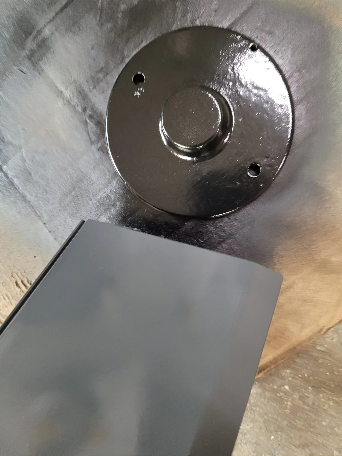

50% RH today so I sanded, cleaned with mineral spirits soaked rags, mowed my stupid yard because it's been raining forever and a section was 8 to 10 inches tall, and painted.
Final colors.
I got pounding with the mallet and got the other piece off.
It's damp so I'll dry until Sunday. One last coat, then clear before the next round of storms.
