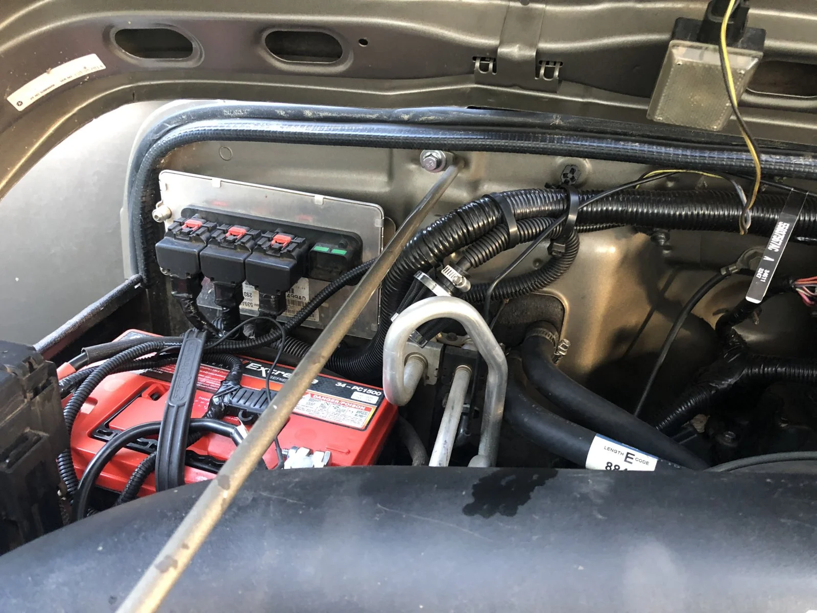

Verify that BOTH your transmission and transfer case have breater nipples / tubes. I had to hack together something to vent my NSG370. I also redid ALL of my diff breathers up higher under the hood, and ran new locker compressor input tubing to run in my Jeep, inside the roll bar padding (I wanted this one to be extra dry).

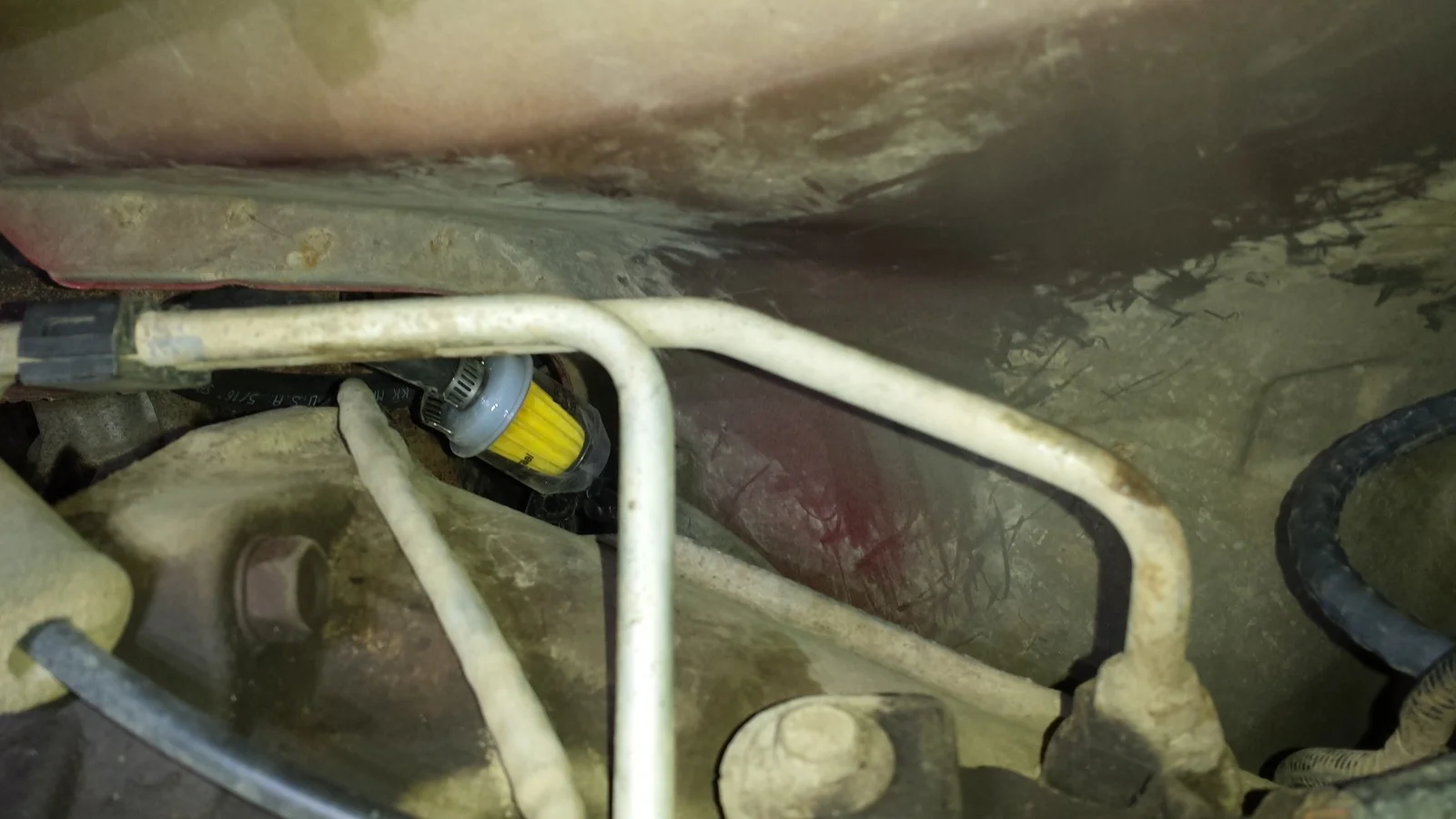

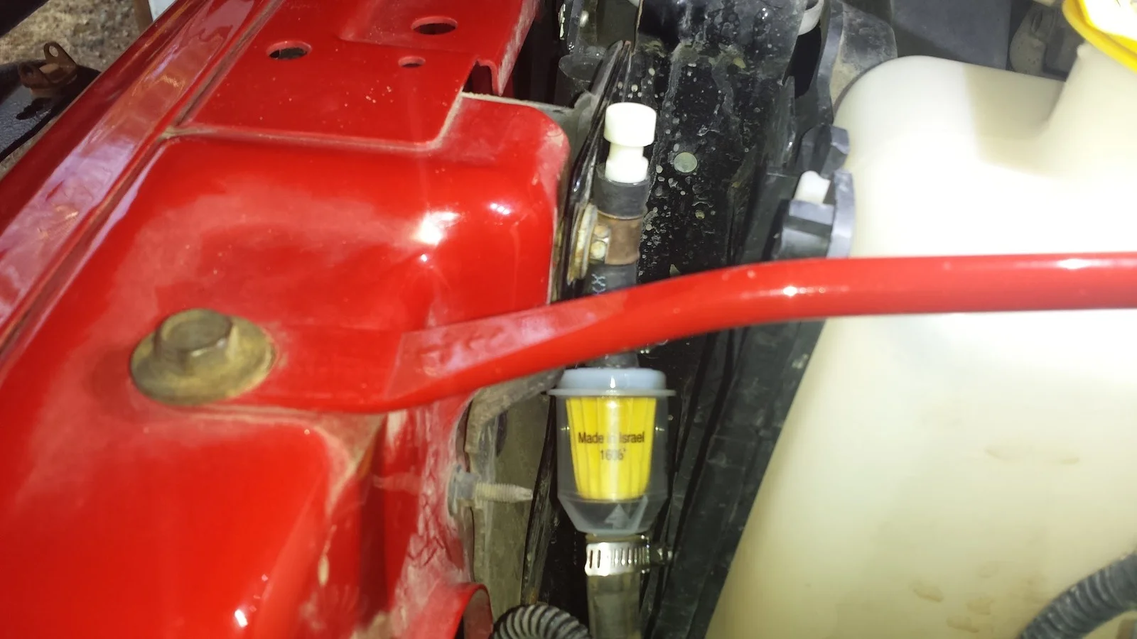

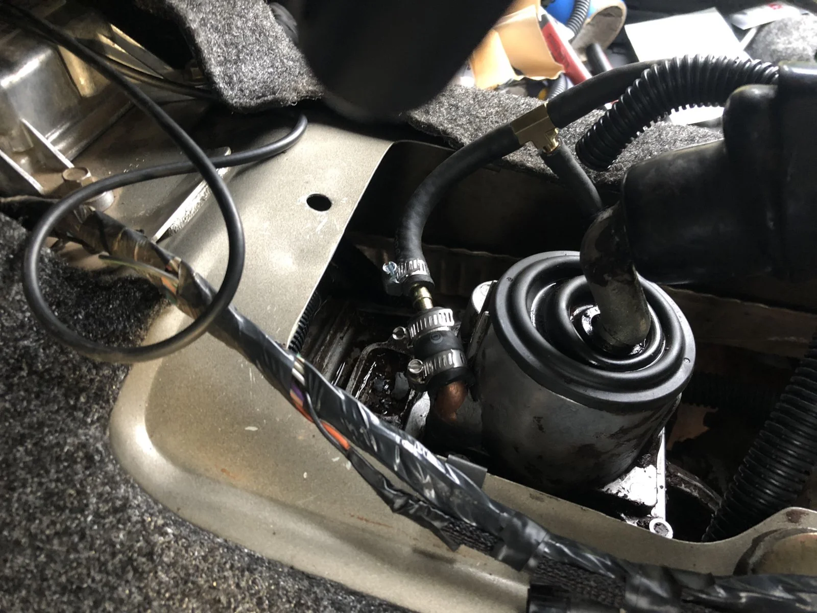

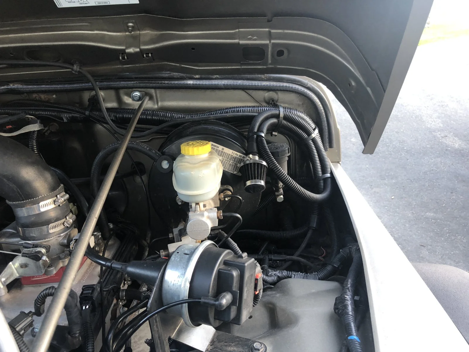

Copied from my build thread: jeepforum .com/forum/f22/red-lj-2485961/index2.html#post37964778
I extended my front differential breather, transfer case breather, and transmission breather and added filters to them to keep dust out.
I used the parts:
My front diff was without a cap where you see it there attached to the grill. The cap may have been removed and not replaced by the shop that rebuilt it after somebody came from the oncoming lane and drove into my lane (which is only the second issue I've had with the repair besides the 'trail rated' badge falling off on a trail. Otherwise I haven't noticed any issues in the last 5-6 years since.). It didn't really need extending but to do the job completely I extended it a few inches (which makes up for the lift anyway) and threw the filter on it. Took 5 minutes and cost only a few dollars so whatever.
The transmission was on a clip that must have once upon a time been attached to the firewall near the bottom of the automatic transmission dipstick tube. When I went to extend it I realized it was just resting against the dip stick tube. Now extended and ziptied to the top of the dip stick tube.
The transfer case was clipped near an electrical plug at the top of the transmission. There's a bracket there that it was attached to. I cut the old clip off and zip tied the breather midway to that bracket and zip tied it to the electrical harness that runs along the top of the firewall. This one was a pain to get to but was also the lowest for me. It would have been easier dropping the front driveshaft so I could get both hands up in there.
I'm probably going to wait to extend the rear diff breather (if it needs it) once I drop the gas tank and have additional access back there.
