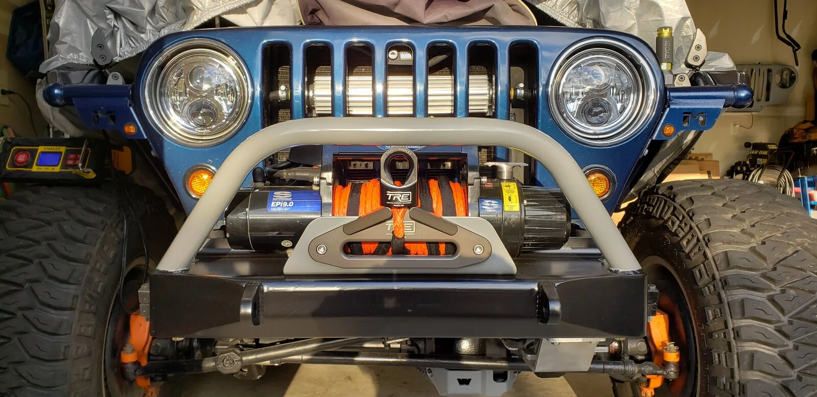

This means no compromises. FWIW, I started out looking at the M8000, which has a stellar reputation. However, because I'm also in water, my ultimate decision was to go with a Warn 9.5 XP. It's sealed, faster, and can pull more. I bought the steel cable version, then replaced that with a TRE line and safety thimble. The price was definitely more for the XP, but this was an area I wasn't willing to compromise on.

I run a basic fairlead on my TJ. It came from my LJ and had dozens of pulls on it, with synthetic line. I never had a problem with it. That said, my LJ was fitted with a TRE fairlead, to be different. I could have put one on the TJ, but didn't see the need to spend more money, when I had something that was proven. If you do go with a cheaper fairlead, just make sure it doesn't have sharp edges where the rope will contact it.

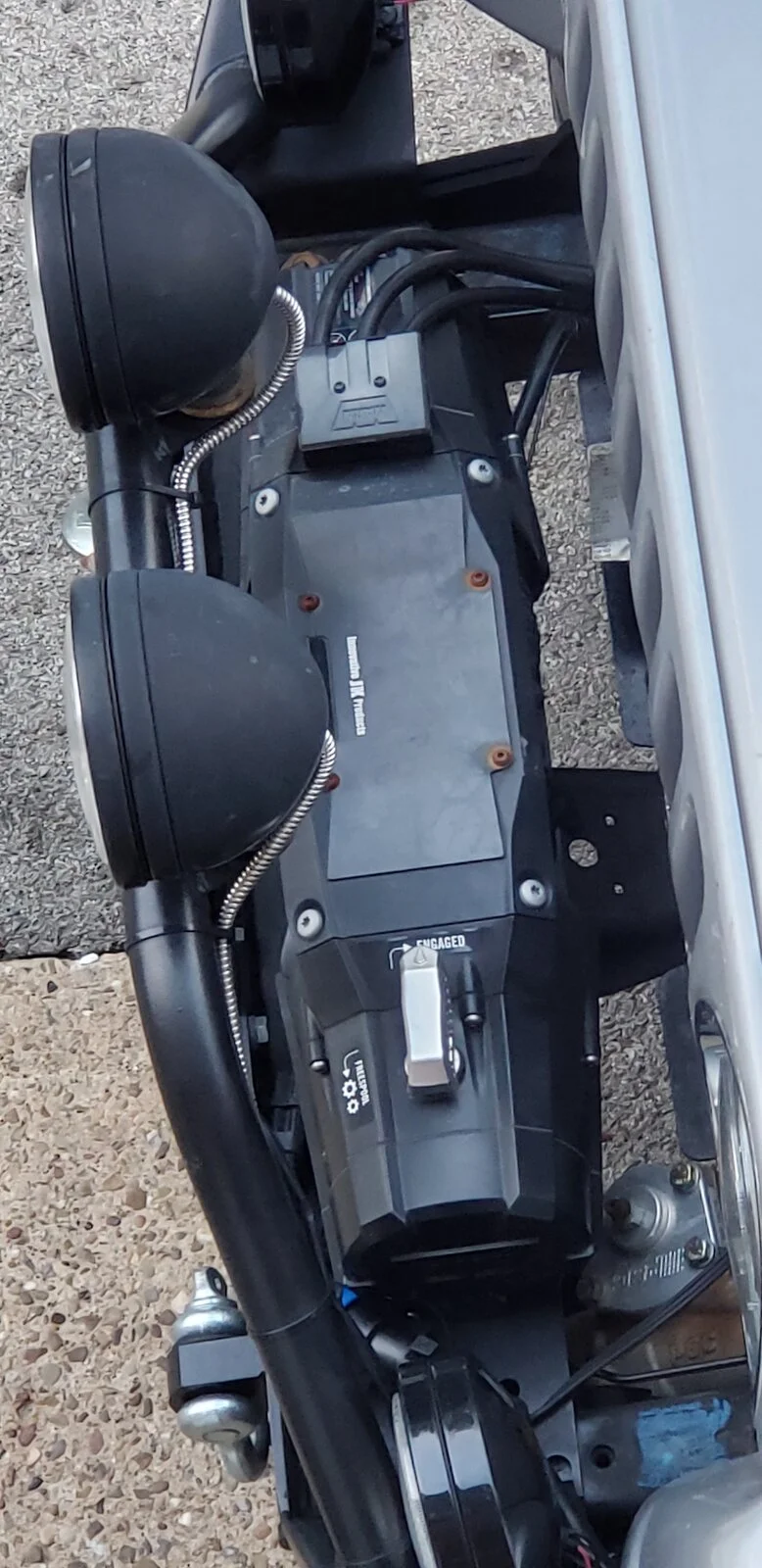

The Zeon also has a relocatable control pack. Mine is now behind the headlight.

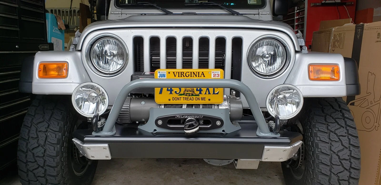

Innovative JK Products makes a nice plate that covers the Zeon hole. Keeps the sun off of the line and makes it look a bit cleaner.

This is what it looks like:
The part number is IJKP-13
Their website www.innovativejkproducts.com redirects to www.innovativeatproducts.com. I'm guessing they probably rebranded. But I can't find the plate for sale on the new website.
Might be worth calling the new site to see if they still offer it...
