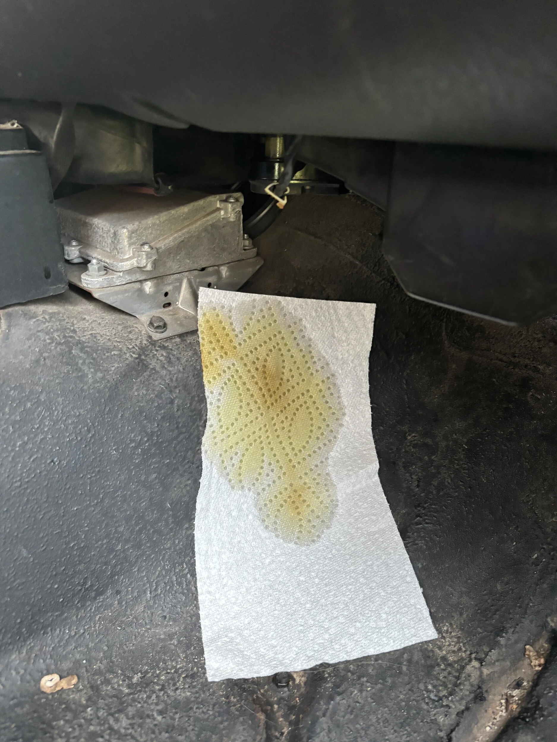

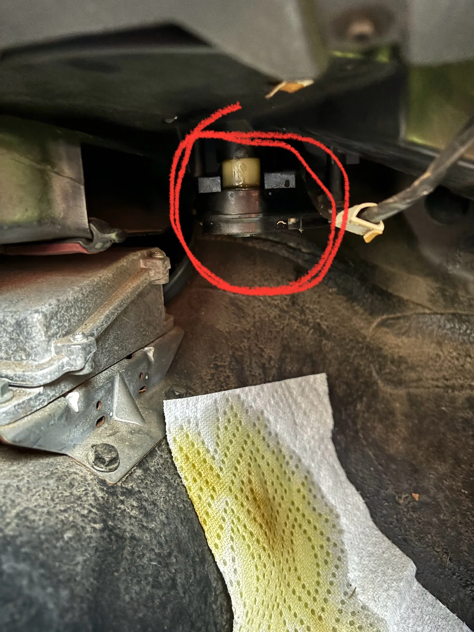

Occasionally it seems like there is a coolant smell but it’s pretty faint. Yesterday, I put a paper towel down under the leak to catch the drips. This is what it looked like this morning. And it seemed as though it was coming from this.
Still likely the heater core?

That looks like the right color for coolant to me. Leaking Heater Core. Condensate would not have as much color to it if any.
Yep, looks like heater core. Condensate should be clear, unless it is washing out the dried up coolant... You'll be needing to start gathering parts, and scheduling the weekend to do the teardown/reinstall. Heater core is only about $100... the labor for a shop to do it will be close to $1k, so advantageous to do yourself...

Another good way to tell is to put the liquid on your finger and rub two together. If it is super slippery, then it is coolant. But, then again it depends on your coolant/water ratio.

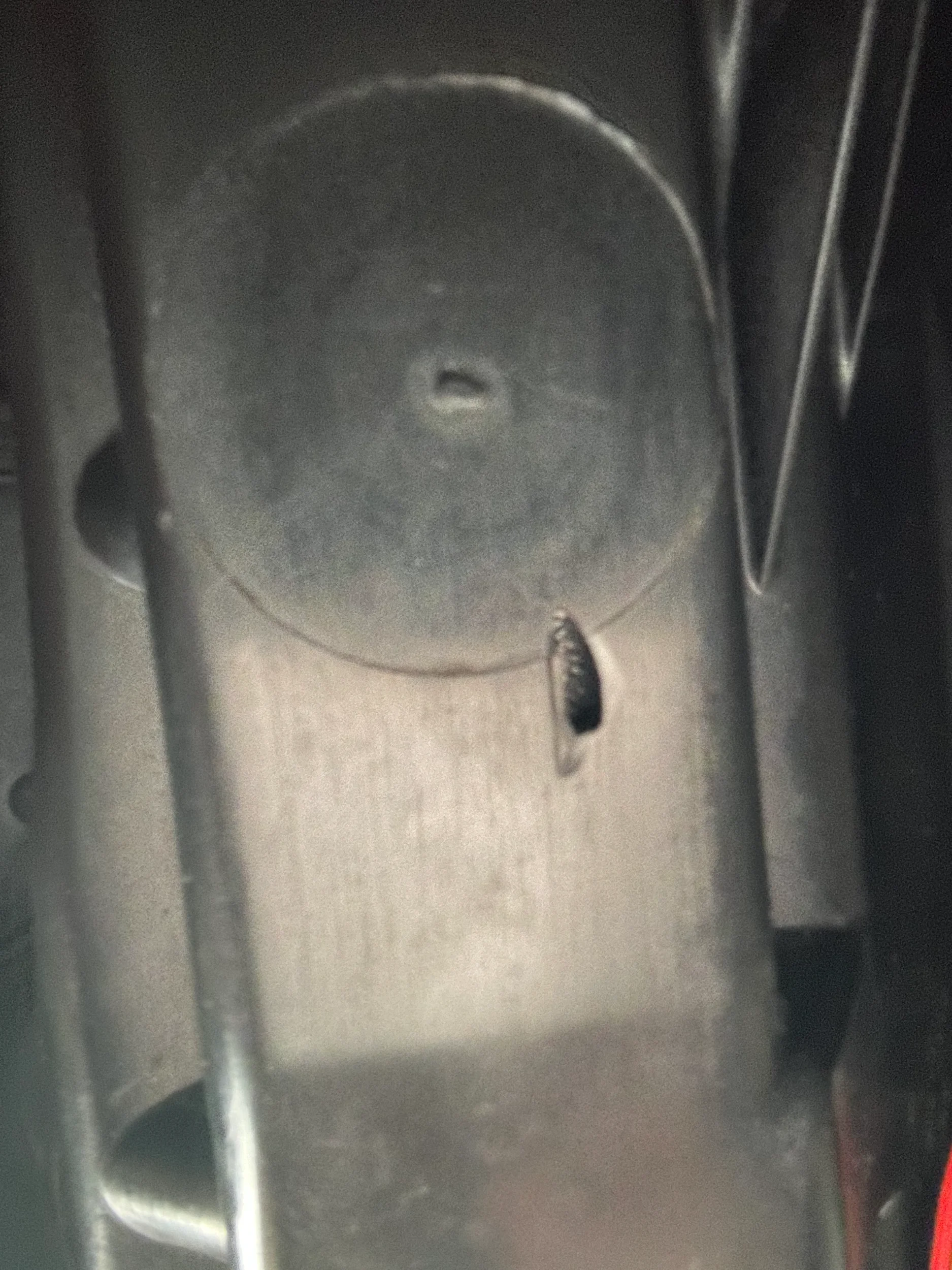

Mine would leak water in passenger floor with ac on and I tried all the suggestions, rubber tube on drain, clean cowl and nothing worked. Finally found a hole in the hvac box aiming directly at floorboard. Filled with RTV and leak solved.
