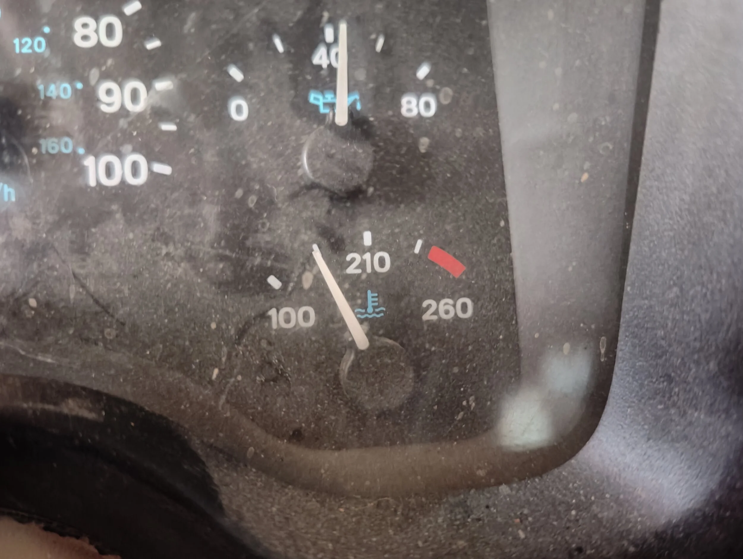

My 97 TJ doesn't appear to be reaching operating temperatures.
It's been an 1/8" to the left of 212 for a while...about the 3/8 mark on the gauge.

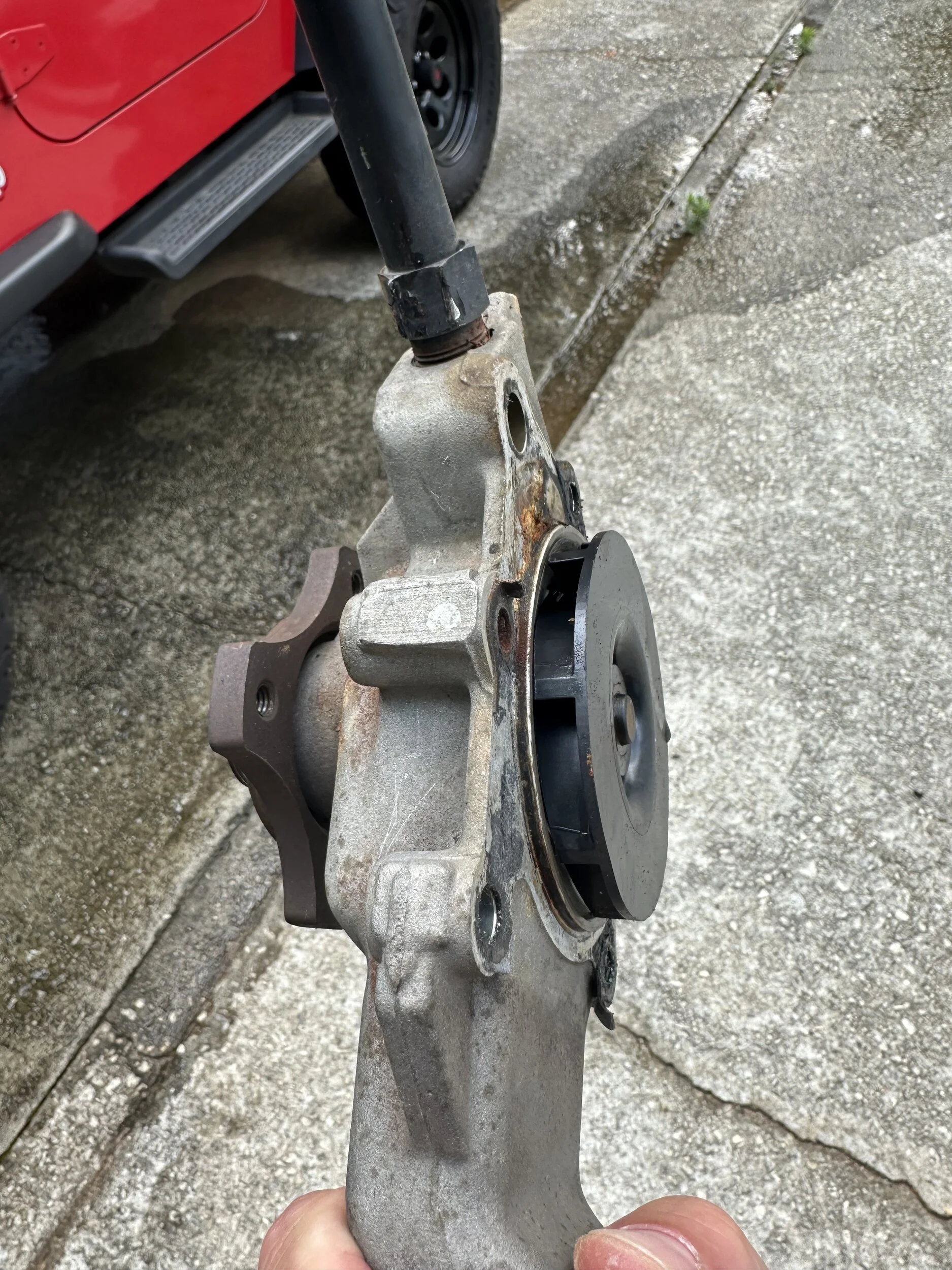

At this point I'm guessing I no longer have a water pump?

Have you accually hooked up a obd2 reader and see what it says your temp is… mine was like that and obd2 said temp was 200…

I assume the water pump is not weeping?

It could be a bad sensor. That is what is sending the data to the PCM and you are reading via the Torque App. I'd try a $15 part before ripping the water pump off.

I don't suspect your water pump since your engine is NOT overheating, but underheating. A bad water pump would overheat the engine.

New sensor...both old and new sensor are withing a few hundred ohms of each other.

Is the connector to the temp sensor corroded? What does the gauge do when you unplug it? Go to zero? That would make me think theres more resistance in the circuit than should be if you shoot the thermostat housing with the ir gun and get a higher temp.put the gun real close. The laser spreads out over distance and they don't like shiny,glossy,reflective surfaces

Why do you think the water pump is involved? It wouldn't make it run too cool

Is the connector to the temp sensor corroded? What does the gauge do when you unplug it? Go to zero? That would make me think theres more resistance in the circuit than should be if you shoot the thermostat housing with the ir gun and get a higher temp.put the gun real close. The laser spreads out over distance.
IR gun temperatures are consistent within a few degrees of sensor temperature measured at the front and sides of the thermostat housing.
