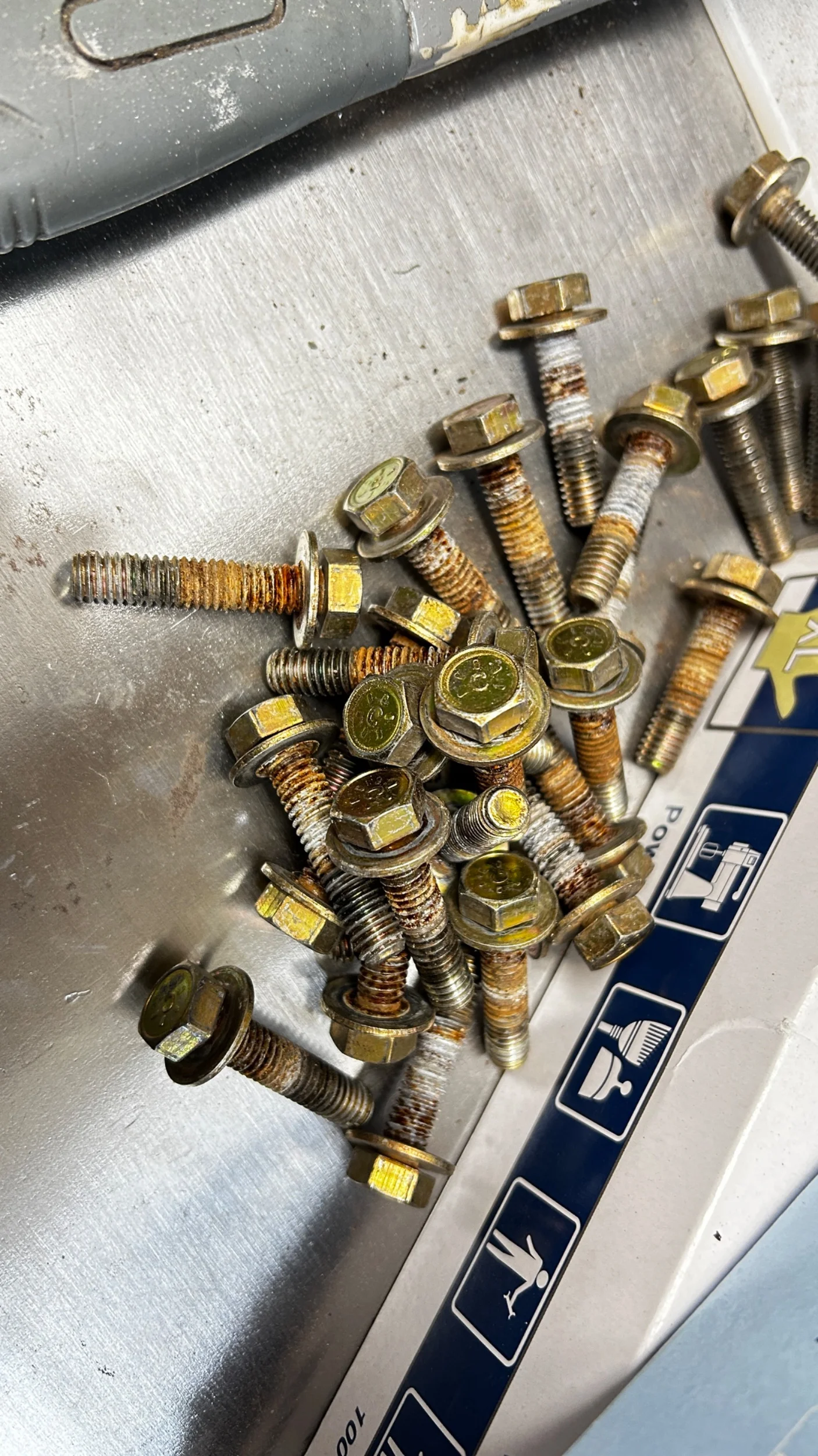

I watched 64 beadlock bolts with blue loctite gall in one year.
Why you putting Loctite on beadlock bolts?
