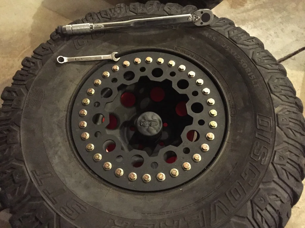

I alluded to it in a previous post, but I'm in the process of installing weld-on beadlocks on my TJ. I already have a very capable TJ, complete with front and rear selectable lockers, but I'm wanting to take my rig to the next level. I've become increasingly frustrated with the rigidity of the sidewalls in my Cooper Discoverer STTs even at 6-8 psi, so beadlocks were the logical choice. I've been running the Cragar Soft 8 steel wheels; so rather than spend another $400/wheel on new wheels, I chose the weld-on beadlocks from Total Metal Innovations.
Below is my progress. Note that I have zero fabrication skills, so I sent out my wheels/inner rings for welding from a reputable local 4x4 shop, Brucker Brothers, Ltd. With the beadlock rings, hardware, welding expense, paint, and including the price of the wheels purchased 5 years ago, I estimate an investment of about $180/wheel.
A long weekend of priming, painting, and clear-coat:
I plan to start the mounting/balancing on Wednesday. Stay-tuned...
- TMI Beadlocks: https://totalmetalinnovations.com/index.php?main_page=product_info&cPath=130&products_id=382
- Install Instructions: http://totalmetalinnovations.com/index.php?main_page=page&id=4
