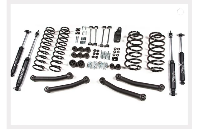

can anyone tell me everything that comes in the zone off road 4 inch lift kit. will i be able to eventually upgrade to an sye. also will i need extended brake lines for this kit

this one is actully the 4 inch of suspension theres no body lift i just need to know all the little things in this lift so i know if i need something extra for it.
If it's a true 4" suspension lift then you will likely have to lower the t-case skid considerably to avoid drive line vibes. Or, SYE.
Can you post a link to it by chance?

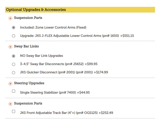

In addition to the springs and shocks, looks like the base kit has bump stops, rear track bar relo bracket, end links, t-case drop, and non-adjustable LCA's, probably to correct the caster and pinion angle.
There are also some optional upgrades:
There's definitely worse places to start for the money, but here are some thoughts I have:
-if you ever plan on an SYE, you'll want the adjustable control arms.
-if you go offroad at all, you'll want the sway bar disconnects.
-If you don't get the adjustable track bar, the directions will tell you to drill a new axle end front track bar hole. Your call, but I personally don't like it, and if you want to upgrade the track bar in the future, your new hole may not leave much meat left in the bracket between the holes, and that meat will get even smaller if you upgrade to a bar that has you drill out the hole to a larger size, which is a lot of them.
If its an on-road only daily driver or if your offroading style is mudbogging that needs ride height more than articulation, the $550 kit is probably fine, but it's got quite a few parts you'll end up replacing again later on if you want a more capable rig or you'll turn it into a $1450 kit with the upgrades.

The biggest thing that turns me off from kits like that are non-adjustable control arms.
For one, this assumes the manufacturer knows exactly where your pinion angles need to be (caster angles to).
In addition, forget about doing things right down the road and getting a SYE / double cardan driveshaft.
