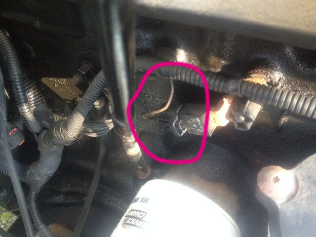

I messed with the coil rail and it didn’t seem to change BUT I unplugged something and it made the light indicator go off. No idea what this plug is but something happened because of it. It was the bottom one here:With everything plugged back in, try unplugging the coil rail and see if the fuse blows
You beat me to that suggestion..look at the harness where it wraps around the back of the valve cover. make sure it is not rubbed through and grounding out.
That is connector c102. if you leave that unplugged and plug the pcm back in does the fuse blow.look at the harness where it wraps around the back of the valve cover. make sure it is not rubbed through and grounding out.
That is connector c102. if you leave that unplugged and plug the pcm back in does the fuse blow. if the fuse doesnt blow, the short is on the gray connector side.
post up pics of what you findOk I think I might have found it by the valve cover
Ok I got that one unplugged and pcm is plugged in and it makes the light go off.That is connector c102. if you leave that unplugged and plug the pcm back in does the fuse blow.
