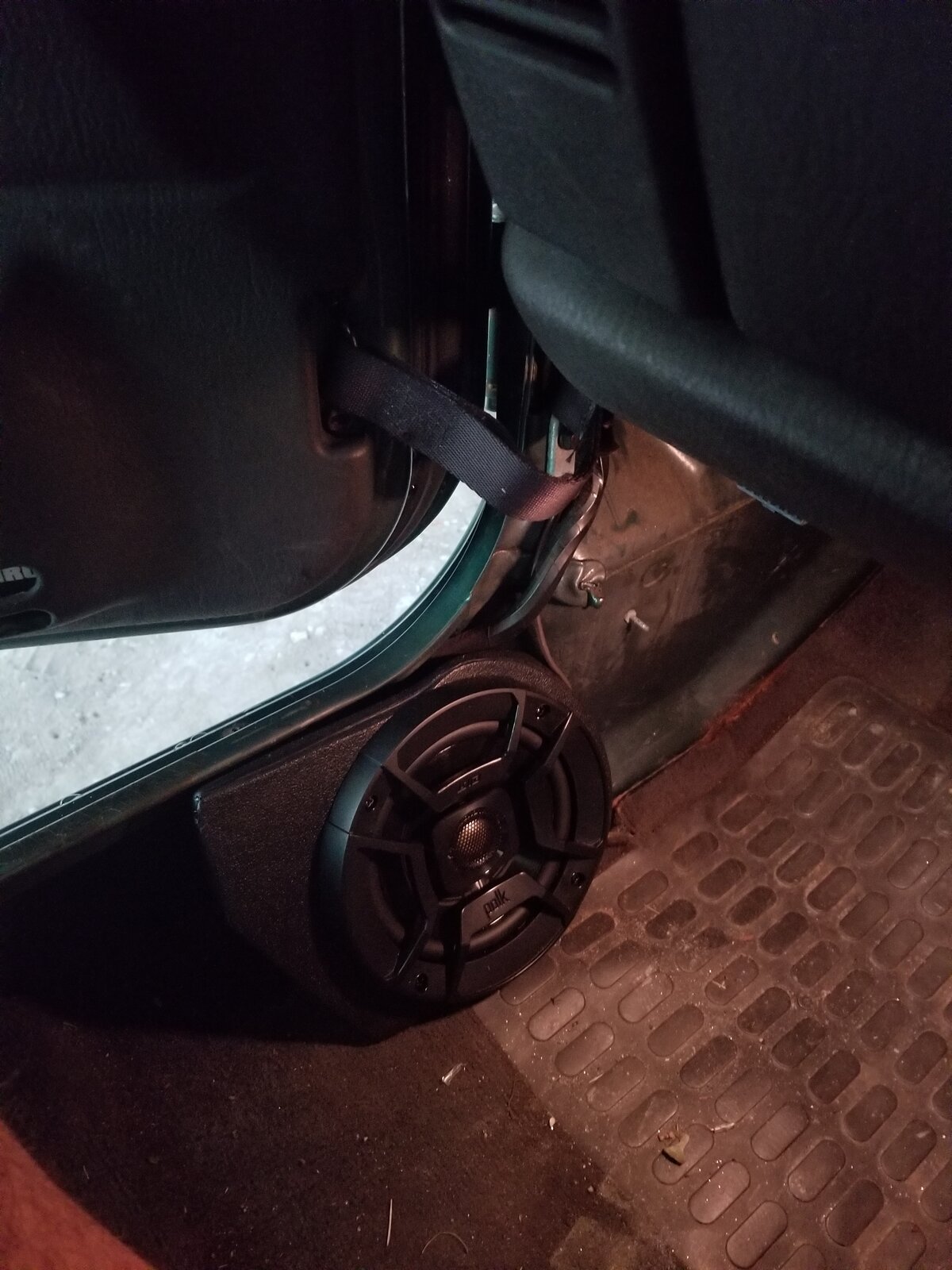

Put in some ModPods with 5 1/4 Polks. Way better than the 4x6. Also replaced the head unit with an Alpine.
I was getting close to putting these in my basket on Amazon, then I got to thinking. LOL Yah, that's a bad thing sometimes. LOL Rainy season is going to begin soon and I am wondering how much water is going to drip on them from my shoes while getting in? Do you feel you could move them along the side fairly easy or is where you have them the only spot they will fit?
I even thought about maybe trying to put some sort of plastic over the speakers while it is raining. Could work I guess? :D

Are you worried about getting water on the speaker itself? If so, get marine speakers.

They designed for that spot so they can be screwed in. Pretty sure you could move them around and screw from the back. I used Polk DX speakers so they can get wet, not submerged but they are classified as a marine speaker.
Thanks, I'll look the DX speakers up. :D
