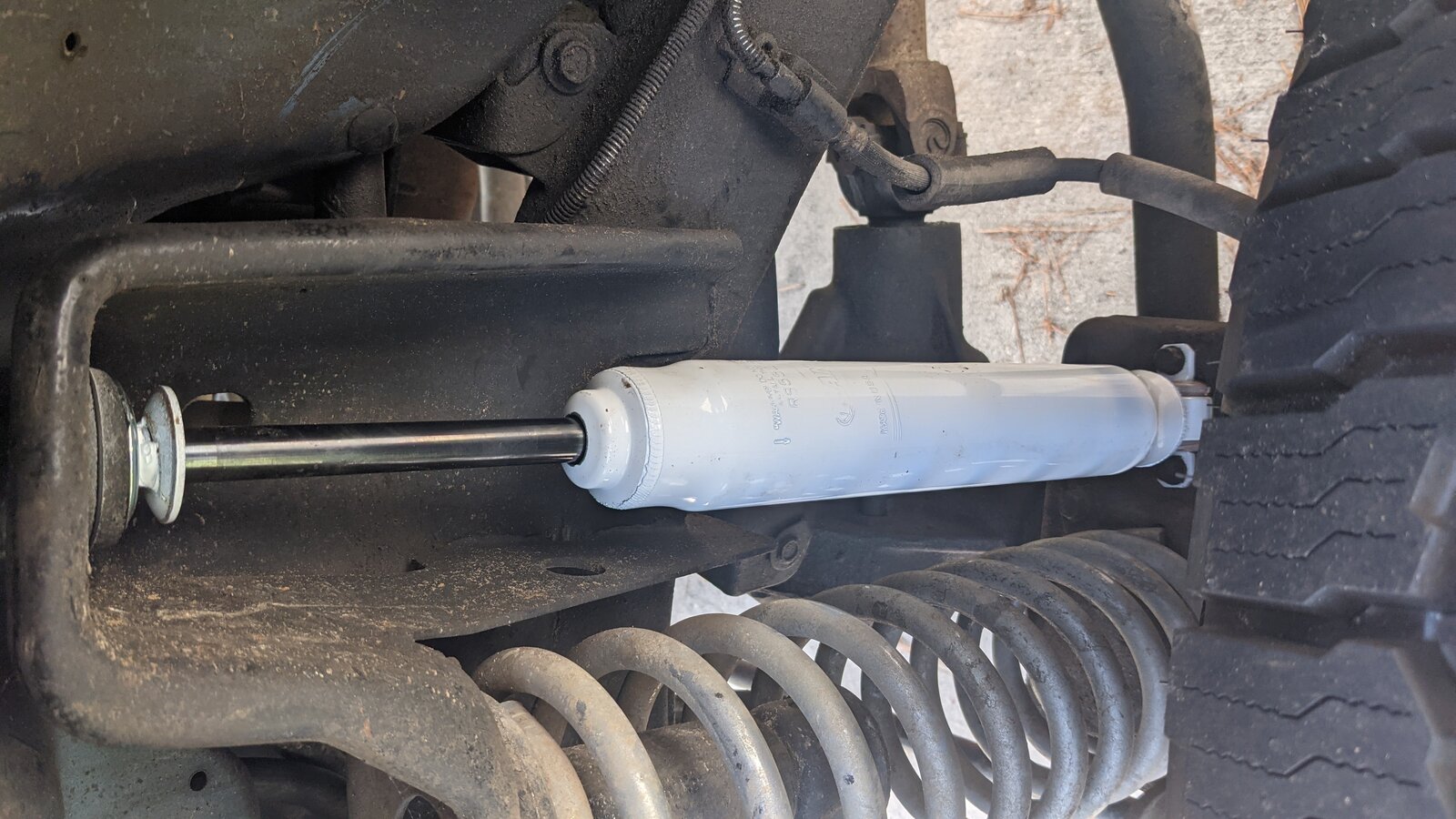

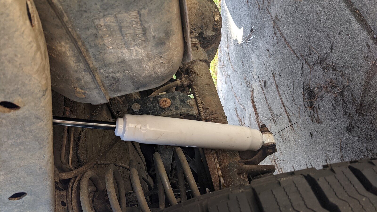

Got one of the rear shocks installed - the side with the broken bolts. I used the XJ flag nut, after I beat the bend out of it and got longer bolts as it sits on top of the remains of the original (welded in) nuts. Then it took a hydraulic jack to compress the shock so I could get it into the lower bracket - which was of course a bit too narrow, so I had to go Tony Beets on it with a BFH to open it up slightly. I'll do the other one tomorrow, I have to get cleaned up to go to dance class.
