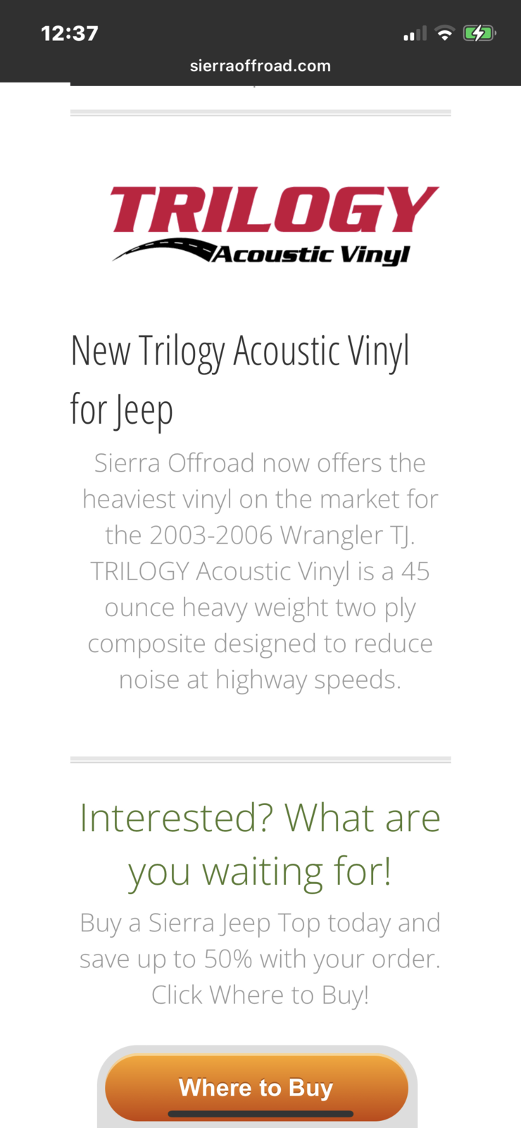

I did everything I'm not supposed to and installed my new soft top early this morning. Temp was 50 with 20-30 mph winds and no good sun to lay it out and let it stretch. Took it straight out of the box and installed it. All went good, fitment was better than I expected. I still have to let the windows sit in the sun to get the wrinkles out from being boxed up. Took it for a 30 mile highway high-wind drive. Very quiet, even compared to my Bestop sailcloth top. Windows had zero flapping issues either. 3 year warranty, so I will see how it holds up. I don't think I'll be buying anymore $800 Bestop sailcloth tops anytime soon, if this works out. Paid $269 shipped. Sierra Offroad black Trilogy acoustic top. 45oz heavy top. So far, so good. Only time will tell.

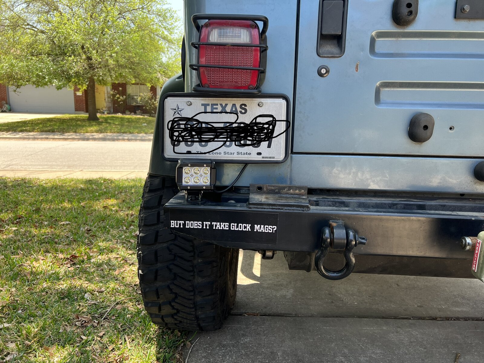

Nice top. I also really like those RC fender flares-even though I'm not supposed to like RC stuff :)
They strike a great balance between the 6-7" options which look odd and stock flares which don't give enough tire coverage.
Could live without the logo, but its a small complaint.

I was reading that too only fits 03-06?

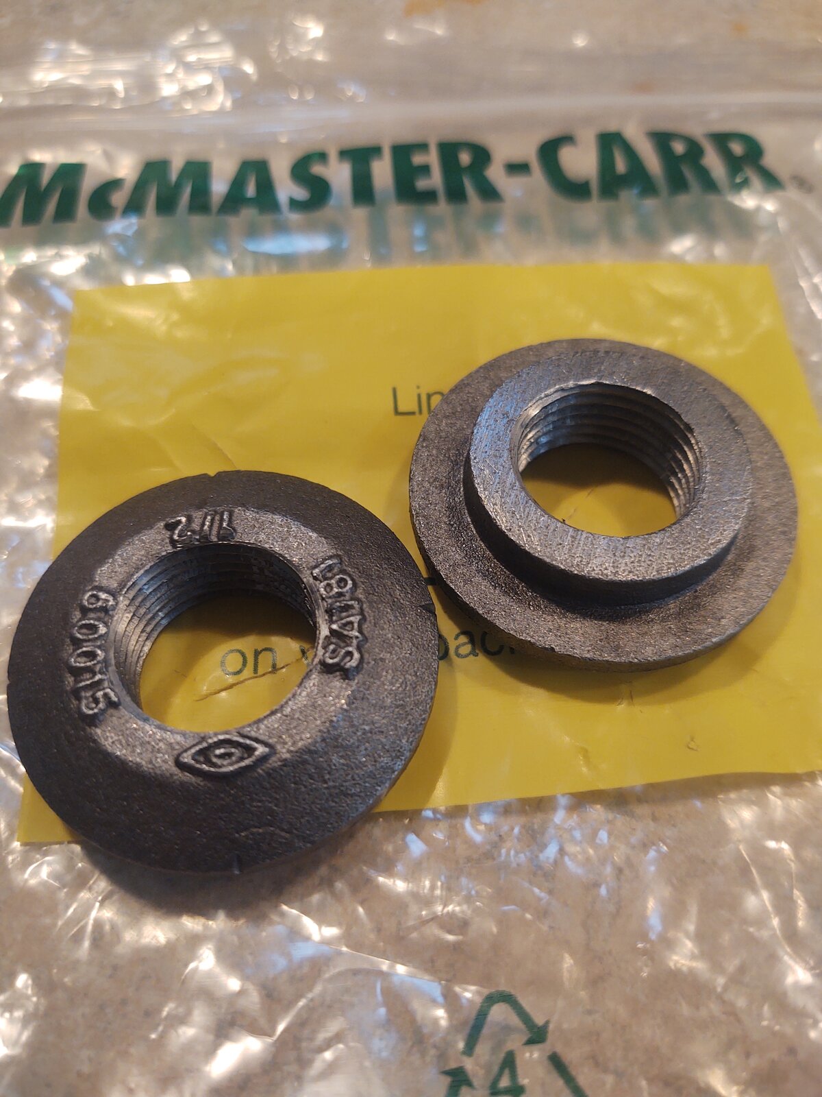

Got some parts in... planning on replacing the plastic plug on the rear diff cover with a higher metal bung...solves the pinion angle fluid level issue and potential interference with the plastic plug and my e-locker on my 35.

hmm... I think I need that for my Dana 35 with SYE and upcoming e-locker/super 35 transition. Where'd ya get those? How will you plug the old hole?

McMaster-Carr 12555K83
Planning on patching the existing hole with some scrap 11 gauge.
May duplicate the Barnett cover.
Also need to make sure the taper of the NPT thread stops the plug before it falls in or contacts anything in the diff. May need to rig a stop ring.

I'd like to see pics when you do that. I assume you'll bolt it onto a flat surface for welding to prevent warping the cover? I seem to recall @mrblaine commenting that replicating something like the Barnett cover was fairly tedious.

I've used newer (03-06) tops on older Jeeps (97-99) and older tops on newer Jeeps. They all fit fine.
p.s. I think the 03-06' roll bar padding is supposed to be thicker.

I remember that discussion, and I've also spoken to the guys at T&J about the Barnes covers they make. There are two different Dana 44 covers that were used by the OEMs (maybe more, but those are the two common designs). One was used on our TJs, and the other I think was used on Dodge/Ram trucks. The TJ cover has the lower fill hole and is made from thinner-gauge steel. I asked T&J if I could send my covers in for conversion and they won't work with them due to warpage.
