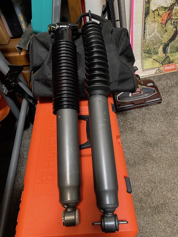

I painted mine because I didn't like the white and red. My adjustable control arms are gun metal gray so the shocks got that and black boots. So I'm all color coordinated . 🤣 🤣 🤣

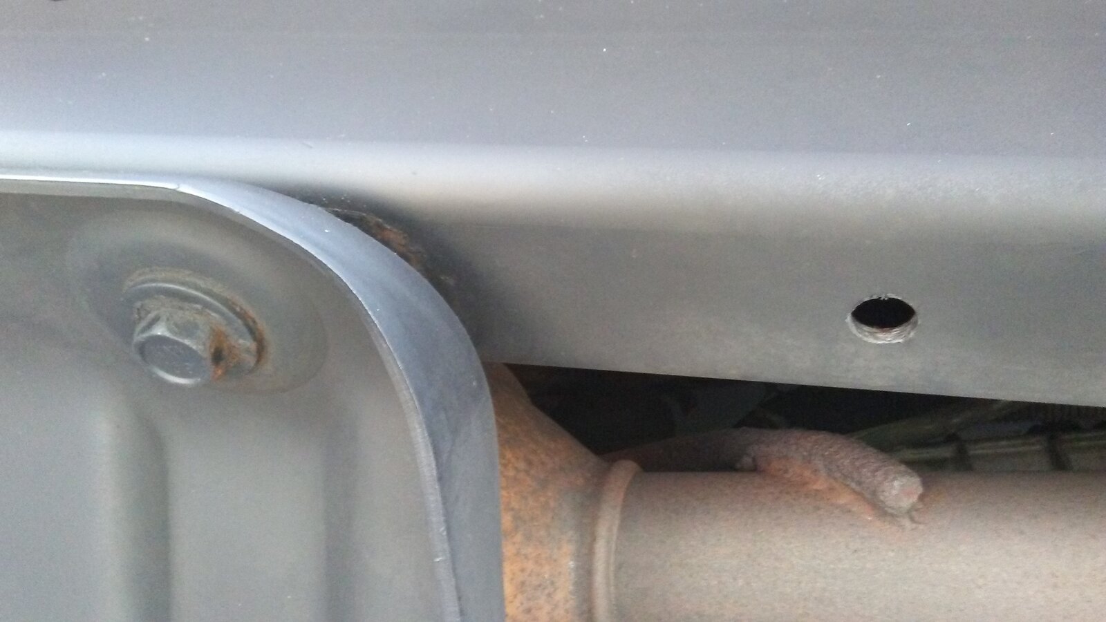

Somewhere somehow I saw a suggestion to drill through the holes already on the lower control arm mounts because those mounts will keep the frame strong. It wasn't too hard to drill but breaking off the sharp edges and priming/painting was a huge PIA. I'm not even sure if I succeeded at that so Fluid Film is a regular thing. Poking around to keep those holes from getting clogged is another reason I wish I drilled where SAWB and MikekiM drilled theirs.
Lived, Learned, and now Sharing what I'll avoid next time.
If you are not planning to pulverize the inside of the rails, you might want to explore making the holes a little bigger so larger chunks can be flushed out without clogging the hole. I use a a strong magnet to capture large moisture holding debris first, then a combination of compressed blown air in and simultaneous strong vacuum out, plus repeated power washing. Allow to dry, then Fluid Film.

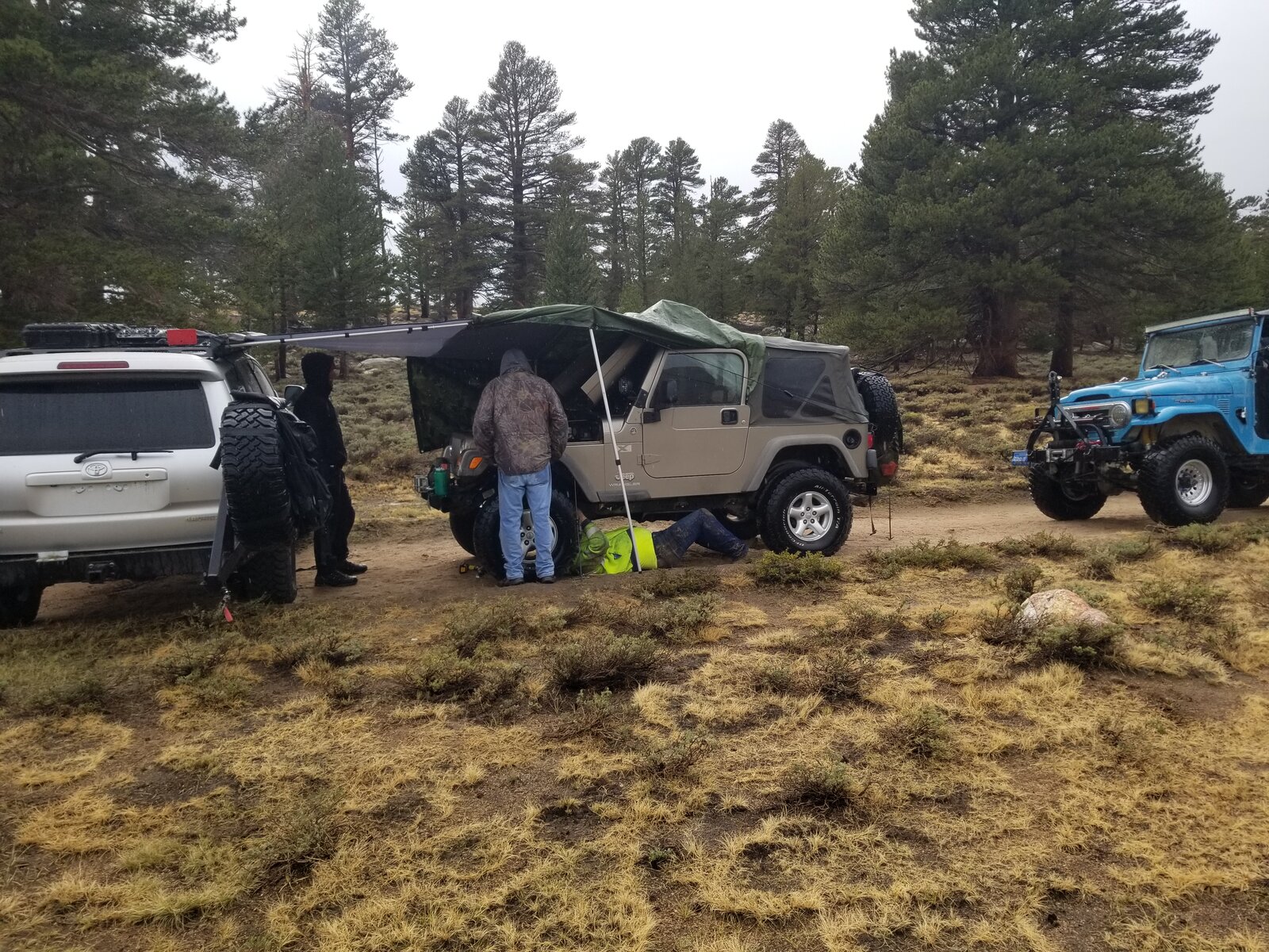

Worked on broken engine mounts 10k feet into the mountains, in rain.
2x deer where within bow shot at this location!
Too bad we were holding wrenches.
Don't kill deer unless you plan on eating EVERY part of them. 😬

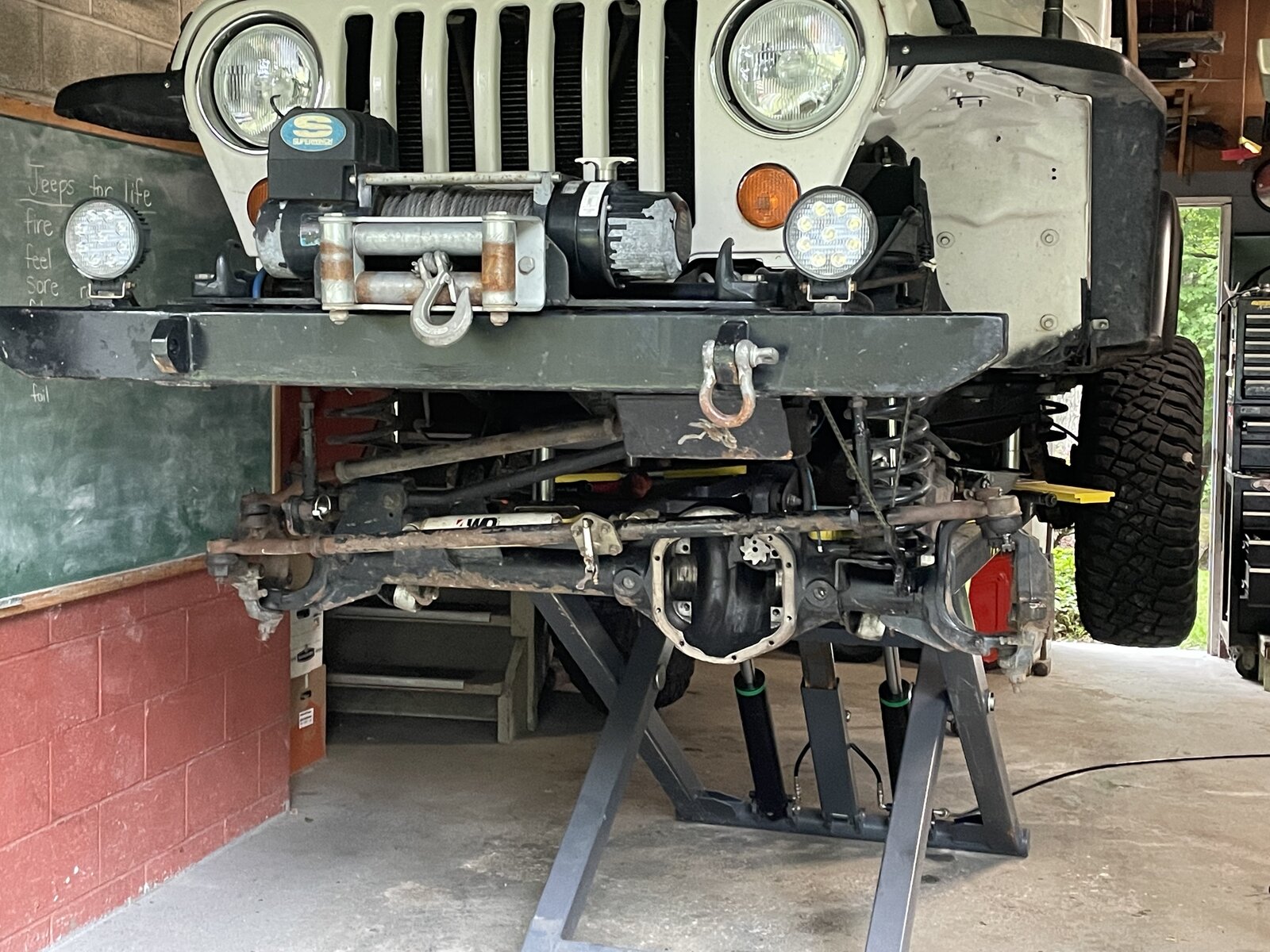

Nice lift. Pros and Cons?
Great for suspension, axles, brakes, etc. Not good for dropping T-case or tranny, doing exhaust. It's small and I park over it when not in use. My garage is tall enough for a 2 post lift but not wide to have it and two cars parking so this was a compromise. It certainly saves my back on a lot of things. I can also put a piece of plywood on it and put anything on it to work at a good height like a lawn mower or ATV.
