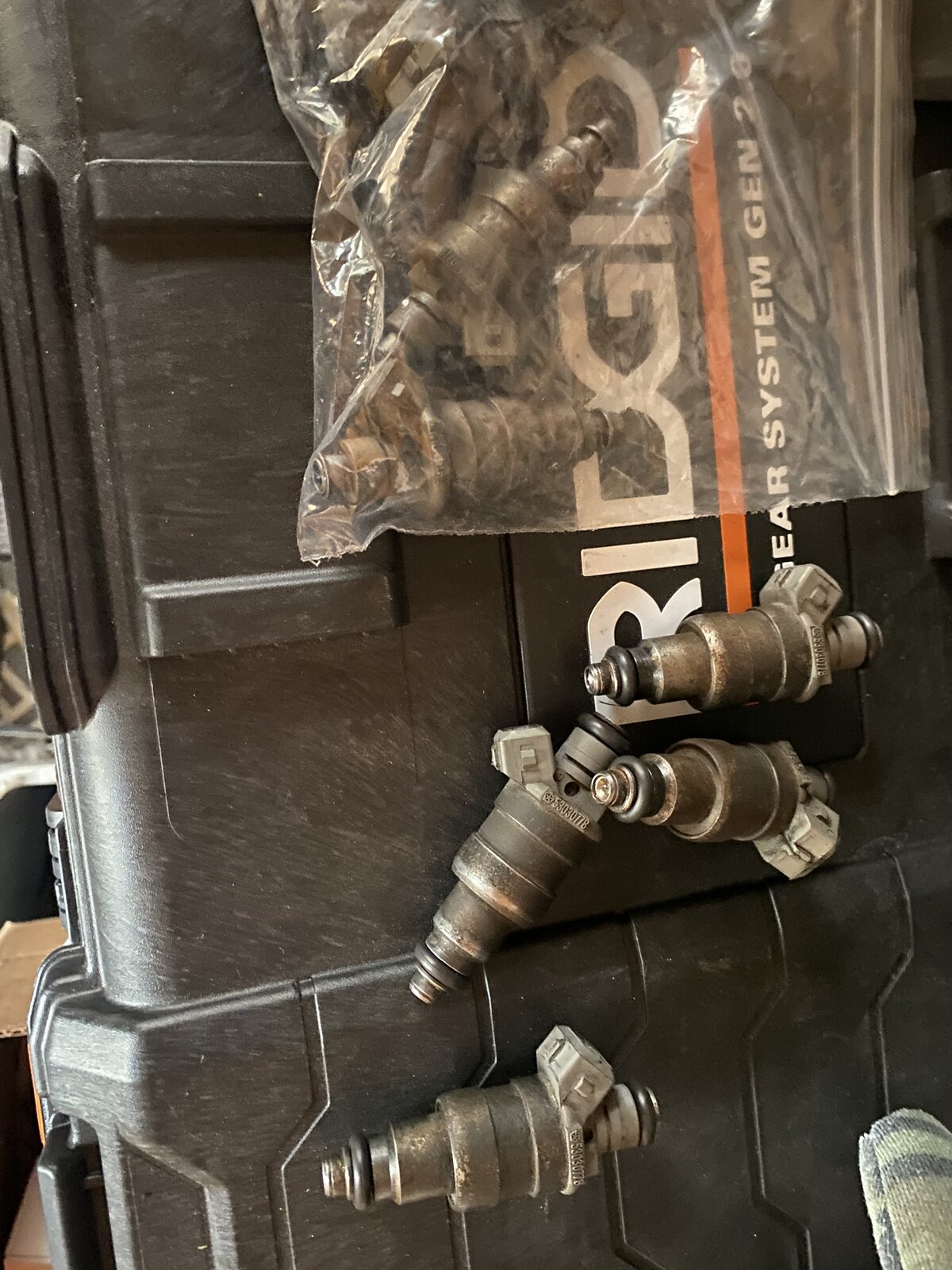

I went through a couple sets of injectors that I had sitting around to find 4 that will make a good set for my new engine build. I have about 16 different injectors so I’m pretty confident that I’ll have a few good ones. They all shifted and would open and close on demand with a 9V battery setup I have for testing injectors. I put some new o rings on 4 of them and got them ready to be installed in the intake.

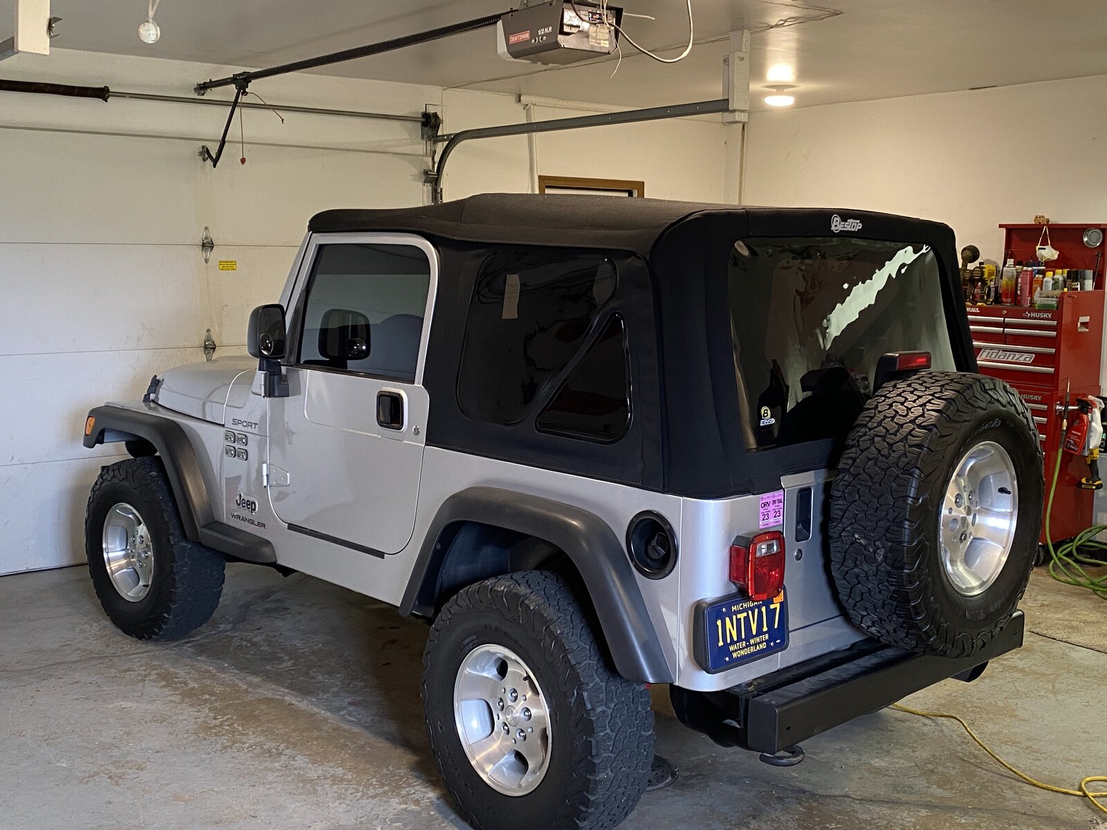

Found a brand spanking new bestop twill replace-a-top for the low low price of $600 on eBay a over this past weekend. arrived Tuesday and I popped it on tonight. short of the shitty bestop logo, im pretty happy & will take extensive care for the shitty aluminum zipper pulls from this point on now that I understand how they fail internally and are stupid easy to replace when they start wearing.
It's been a bit of a roller coaster ride for me with tops over the past few weeks. from stitching a twill top and not working out, to purchasing a cheap tan top off marketplace and not loving the color, to purchasing a super cheap open box but new top which had been in storage somewhere off of eBay that ended up having mouse damage (honest mistake and the seller was a man of his word for the refund), to stumbling across a twill top which is what I really wanted but didnt want to spend 1k.
to date I think I have 5 soft tops floating around now. 4 problematic ones and this new one :ROFLMAO: oh, and a hardtop I get to push around the garage all summer.

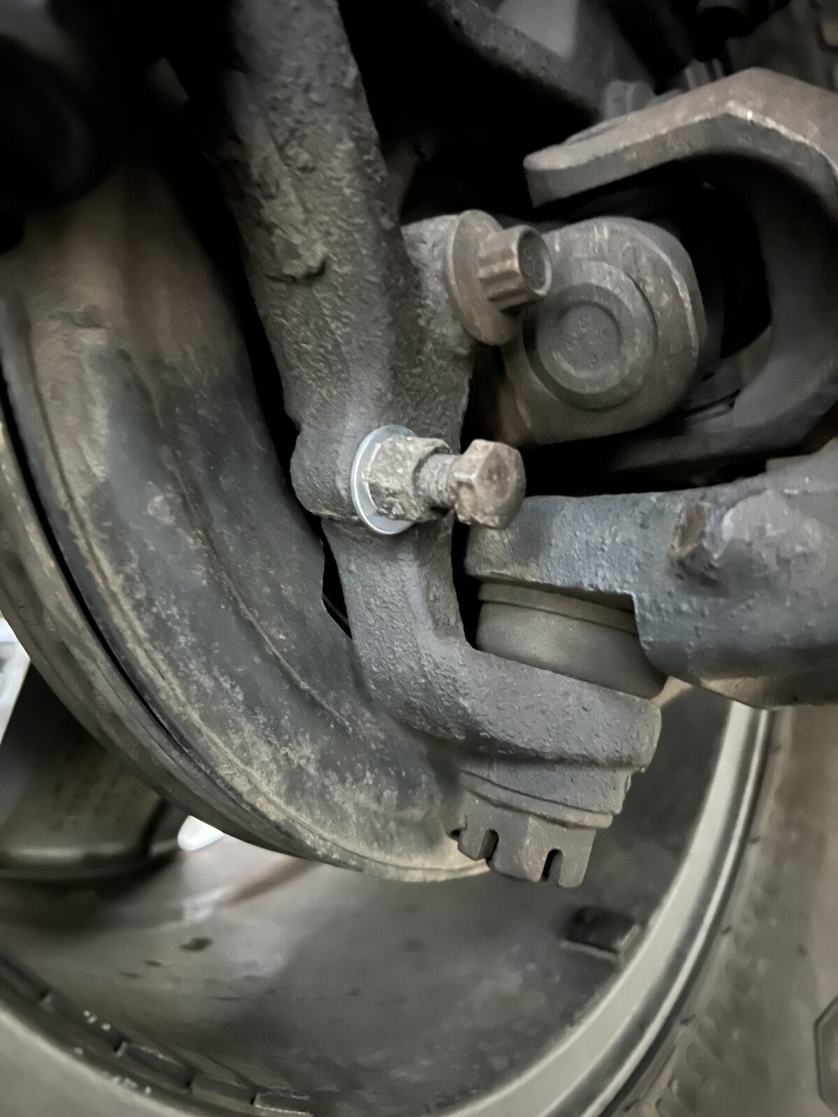

When I swapped out my CAs last week I noticed rubbing on the arms so I added a washer on the steering stop.

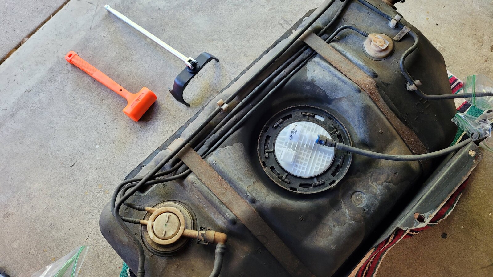

I replaced my fuel pump and some other underside maintenance.
I honestly think that part of the hesitation during acceleration and occasional flashing CEL I was experiencing may have been due to an aged/failing pump. Once I was done reassembling and went for gas, the Jeep felt quite different. I'm still planning on replacing the three catalytic converters (they're in a box, hopefully it will done next weekend).

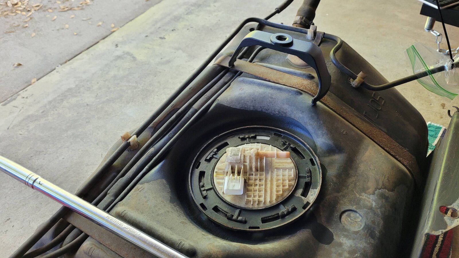

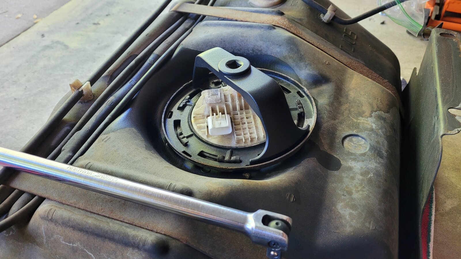

Just for this job, I splurged and bought a lock ring tool from Amazon. It was $20.00 shipped but it was so worth it.
(Link: https://www.amazon.com/dp/B07FJWM8TM/?tag=wranglerorg-20)
I blew all the debris off the top of the tank with a compressor and gave the ring a quick Kroil soak. Keeping turning tension on the ring tool with a breaker bar and hitting its elbows popped the ring in about 5-10 wacks.

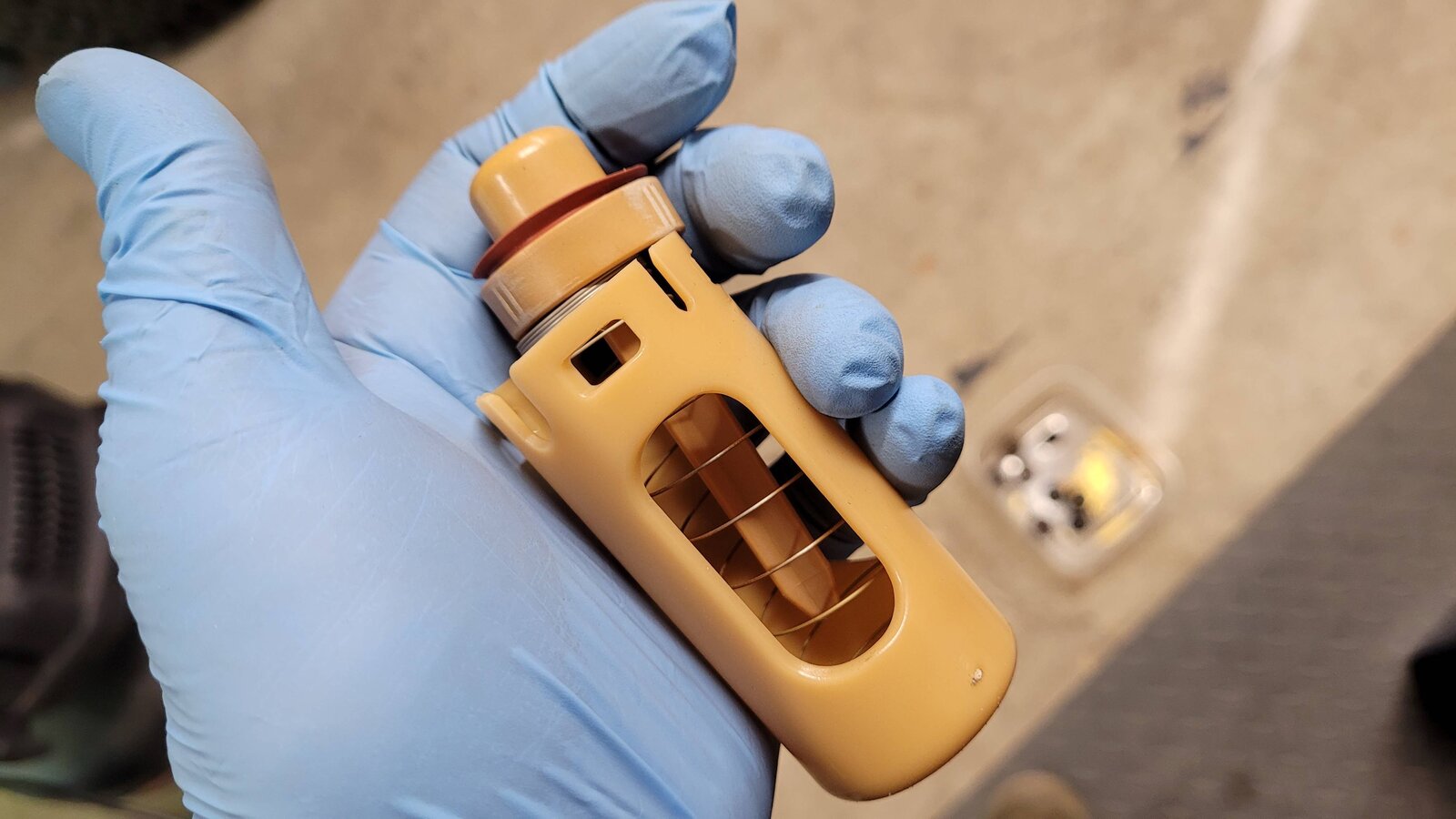

While I had the tank open I also took care of this little chore.

New Bosch pump installed and all ready for remounting. This lock ring tool made this all very easy. I applied steady turning pressure with the breaker bar and hit the tool's elbows with the mallet and the lock ring was on in 5-10 light hits.

There's a tool for everything... :LOL: Had no idea that existed. Been using a cold chisel and hammer to knock the ring around on and off.
