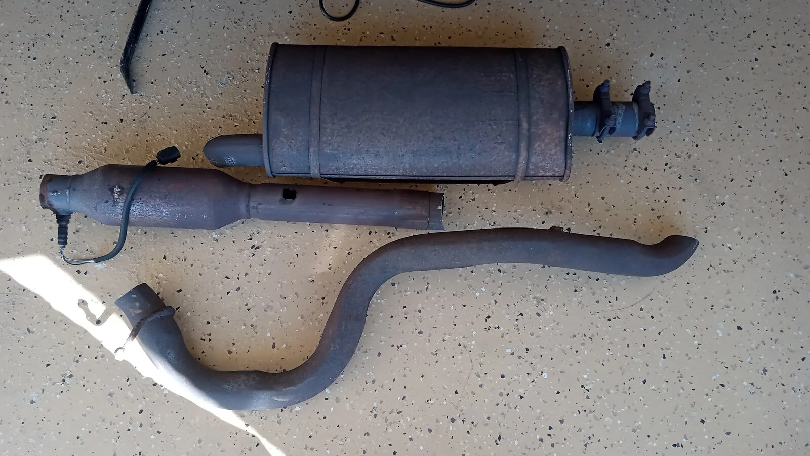

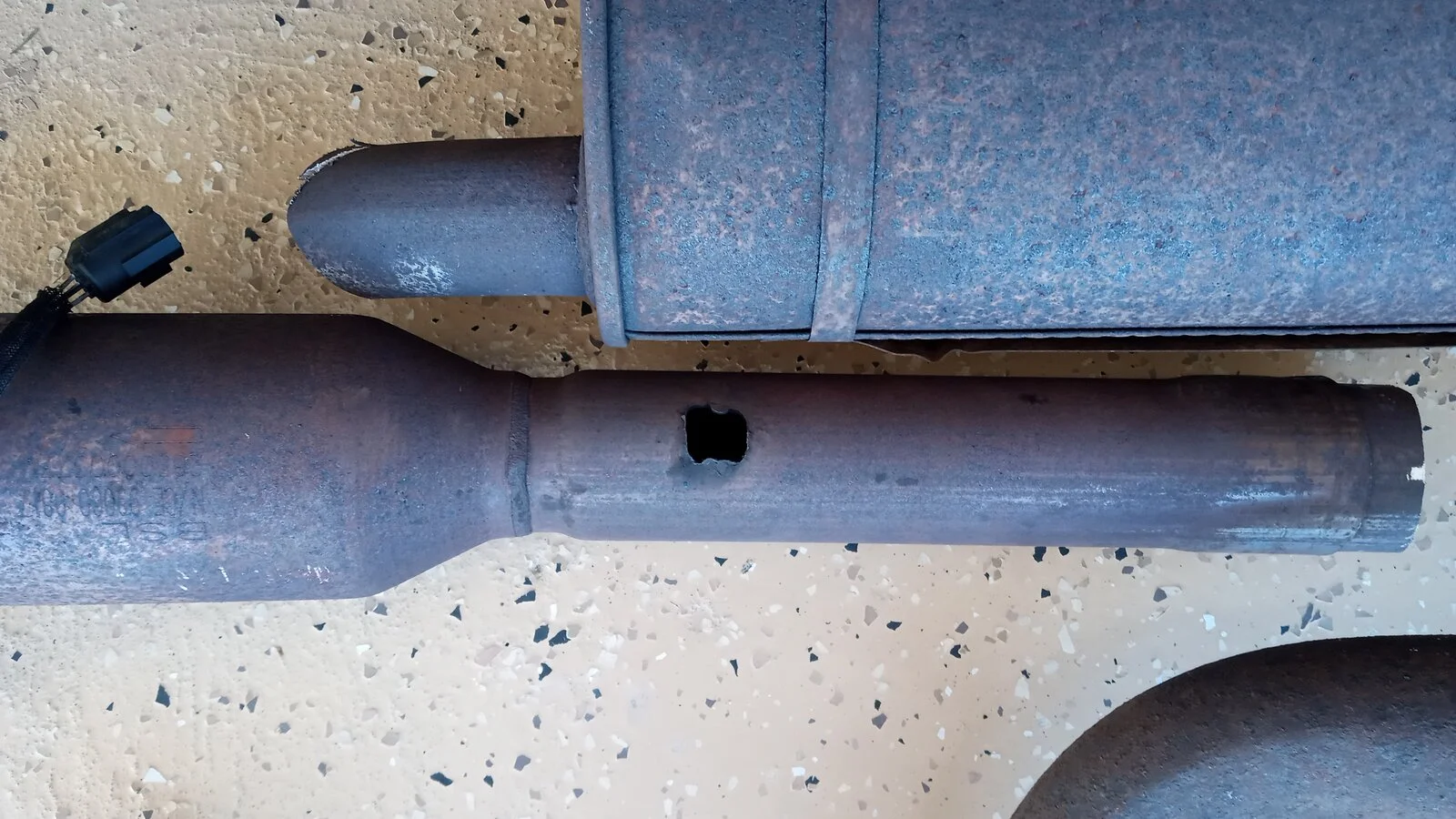

Had to bite the bullet and just rip it all out after blowing a hole through my exhaust pipe in front of the catalytic converter. Everything was more rusty than I thought. Money I hadn't planned to spend right now
Sure would be tempting to go to a Larger 2.5 pipe system …if I had the money 😁

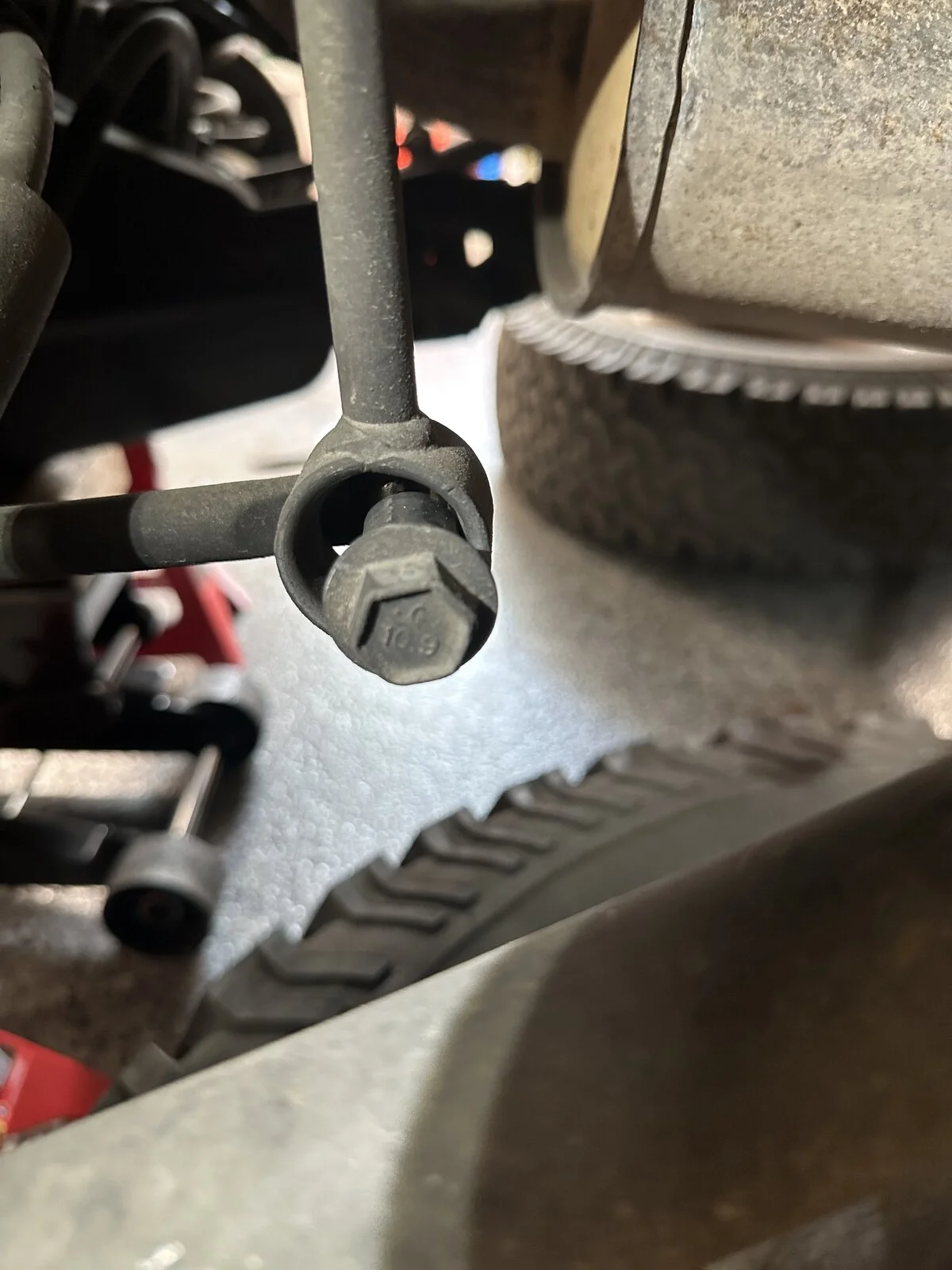

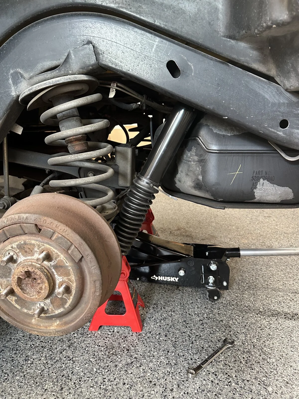

I got new rear shocks on. I went with Skyjacker Black MAX. If you remember, the passenger upper bar pin was ripped out from the bolts. It was a minor ordeal to get the old bolts out. I found out today that I couldn't reuse them so I get replacements (m8-1.25 x 30mm flange bolt grade 10.9) from Ace. Only thing now is the lower bolt. I'm using a torque wrench and I need to go to the store and get a deep 18mm socket.

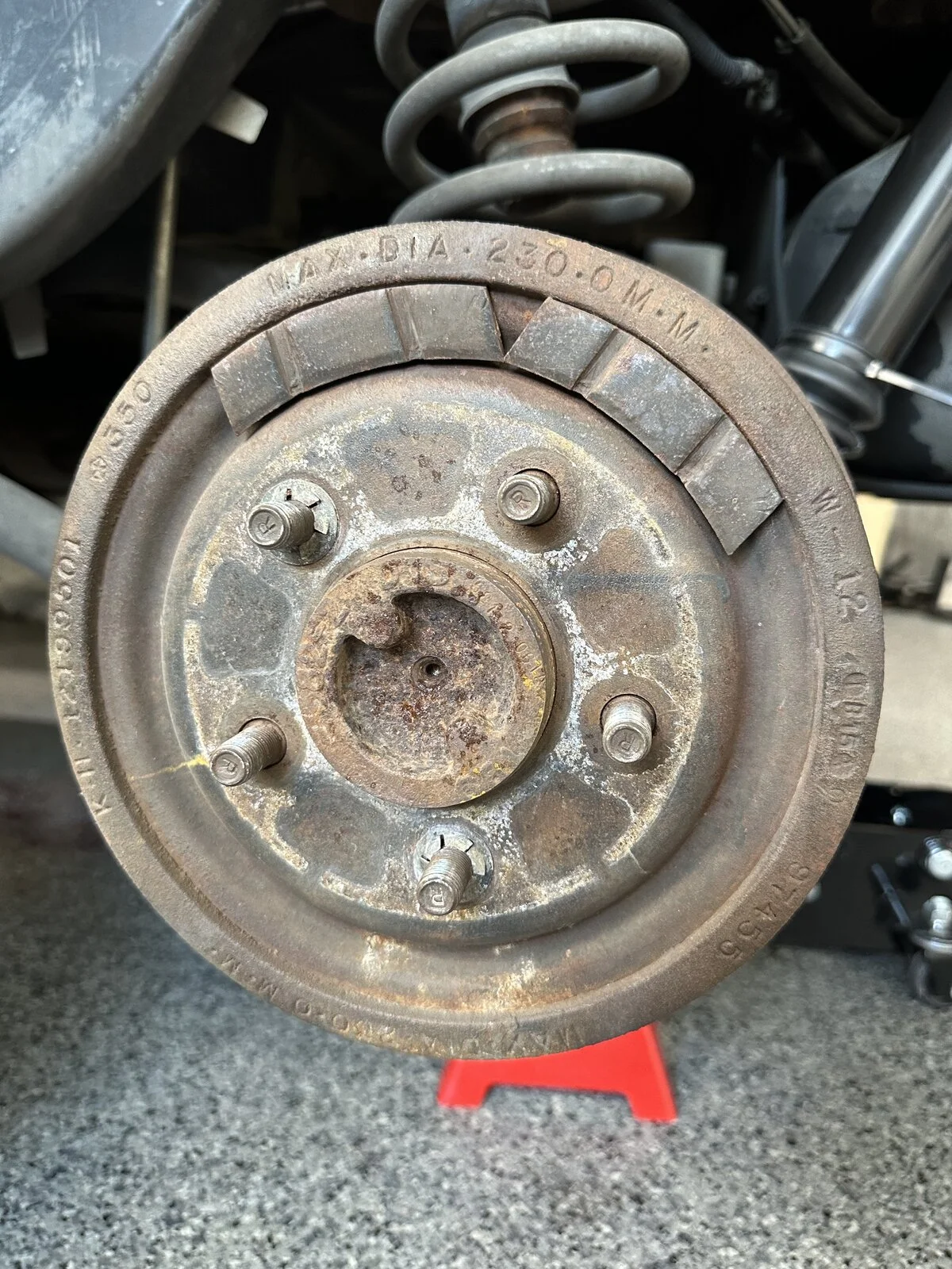

Now, on to the drum brakes. At the 11 o'clock and 6 o'clock position lug nuts, there are these washer type things. It looks like the are on those 2 lug nuts to better hold the drum to the lug nuts. I cannot get the drums off. Should I cut off these washer things to get the drums off?
Yes. They're just there to hold the drum in place when taking the wheel on and off. You can buy new ones at any auto shop. They aren't a must-install part so you can get them after the wheels are back on and put them back on when the wheel is off next time (if you want them).
