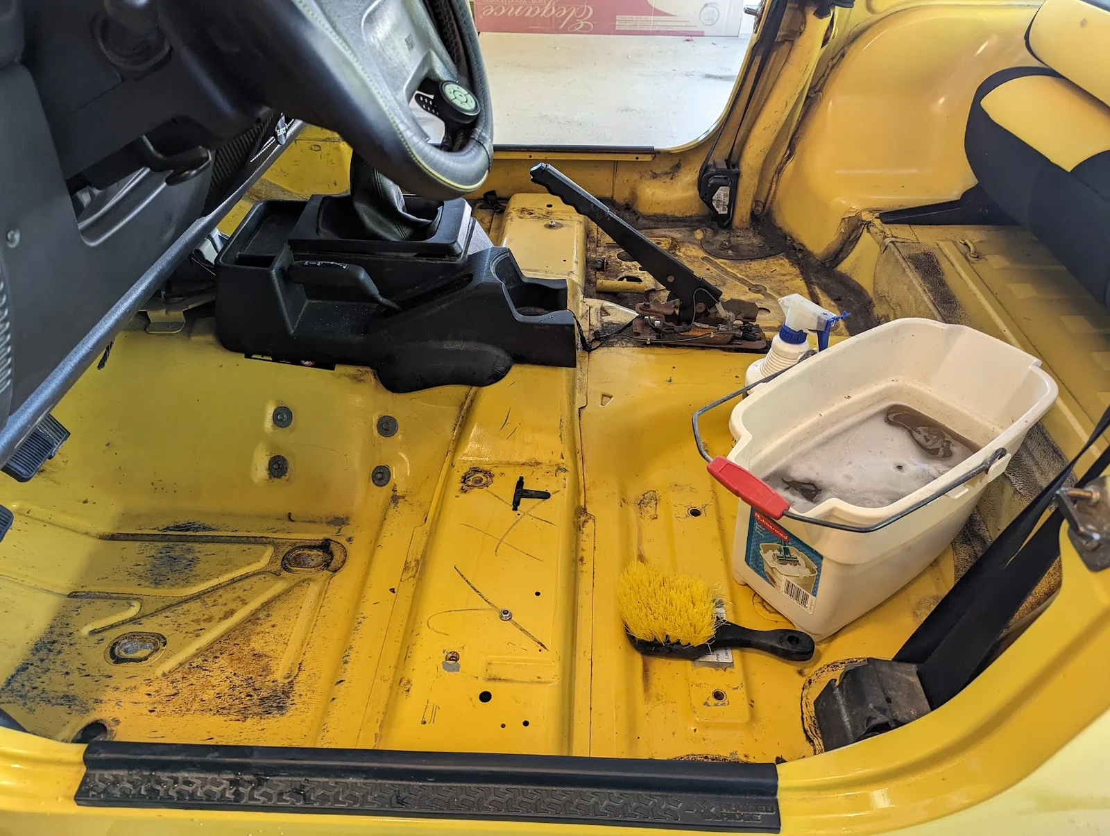

After replacing the rear drum brakes yesterday, I got the tires on and took it out for a test drive. The parking brake works, but it is weak. When it is in gear, I can pull up on the parking brake and the Jeep won't move, but if I give it gas, it'll move.
Any suggestions on how to make the parking brake stronger?

first thing is making sure you have the rear shoes adjusted correctly- video to reference.
After that is adjusting any slack out in the emergency brake cable. Which is in the assembly that looks something like this

It is supposed to move when you press the gas. It is supposed to not move when the car is stationary and the parking brake is on. It especially helps when parked on an incline. It is supposed to move when you press the gas. Mine did when I got it from the factory. Ever heard the saying, "driving with the parking brake on?" It is not a good idea, but it happens. The reason being that you can wear out your rear brakes. If you try to make it too strong, you could probably damage your axle. If you notice that your Jeep seems to be dragging, check to make sure that your parking brake isn't on.
