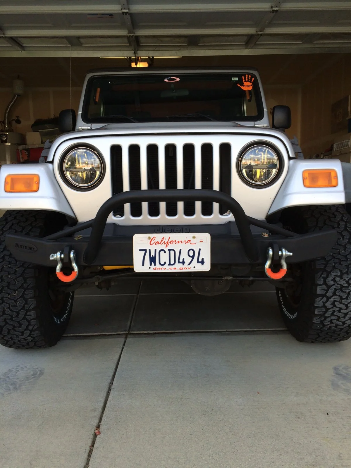

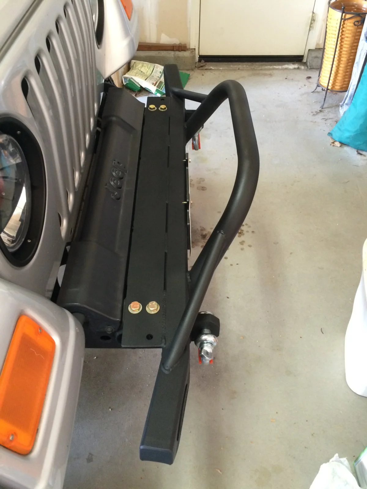

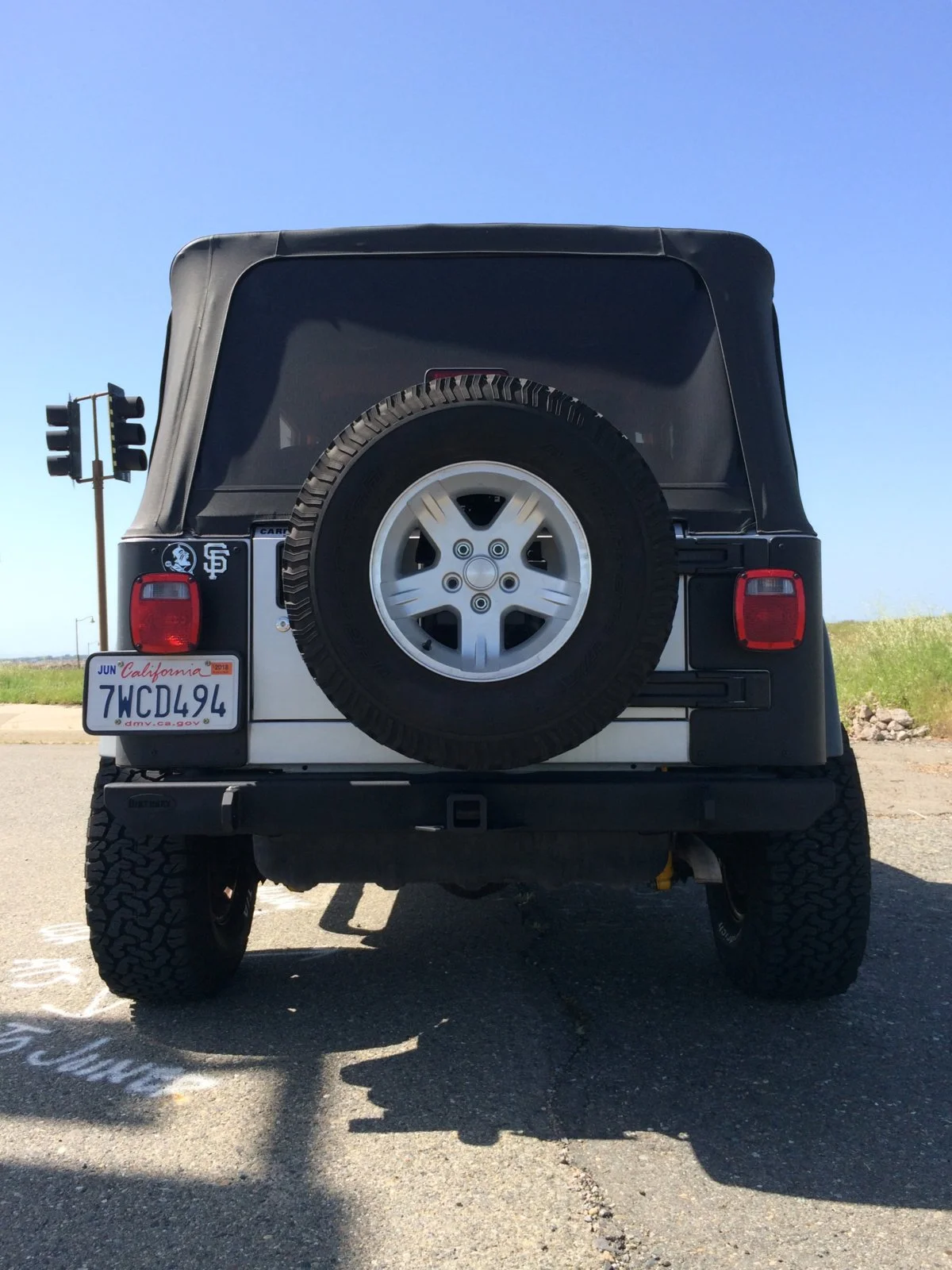

Not today, but over the weekend, I finally installed the Dirtworx front and rear bumpers I bought in February. Shout out to @glwood...I pretty much followed your bumper finish thread to a tee. Had a few fitment issues...two holes on the front bumper were just slightly too narrow, so had to bore them out a bit. Also had to bore out the holes on my Poison Spyder tie-in brackets, because the bolts (supplied by Poison Spyder with the bracket mind you) didn't fit through the darn holes.:rolleyes: That was a fun surprise.:BangHead: Just glad I did a test fit and resolved these issues prior to painting. Actual install went fairly smooth. I LOVE these bumpers...especially with the low cost and made in the US.

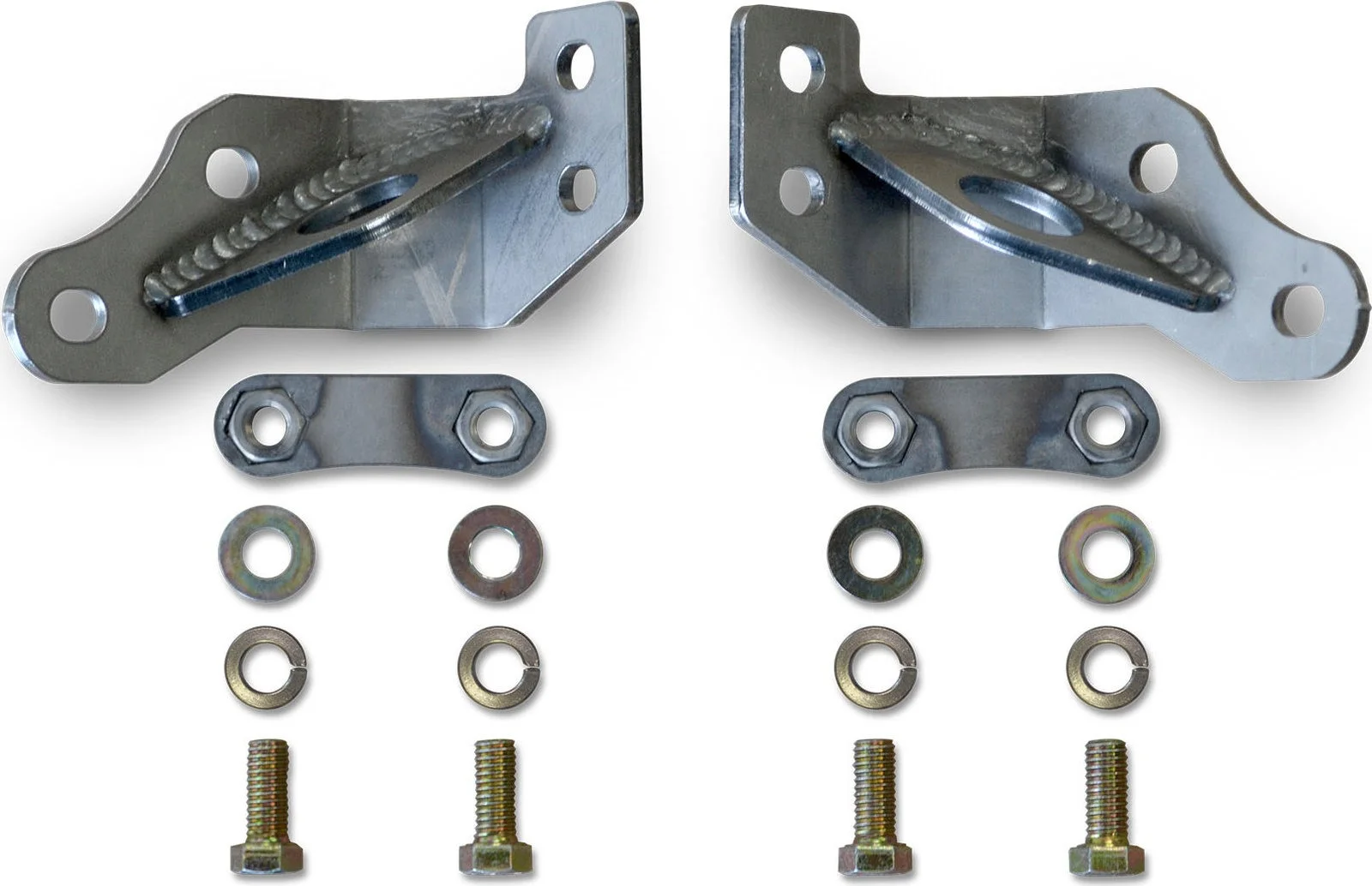

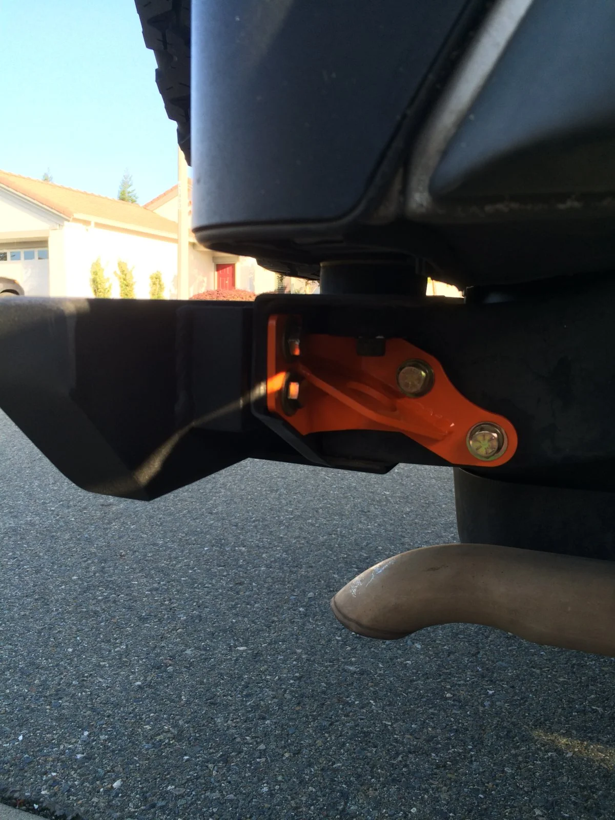

Added some color to the frame tie-in brackets...
Very nice! I like the color of the frame brackets. What do the frame side bolts thread into? I really like my bumpers, also, and you cannot beat them for the price. Great job.
Thanks @glwood ! They come with brackets with nuts welded into them...pretty nifty design, IMO. Worked well, see below....
Looks fantastic! Great work. Nice attention to detail

Yes, the frame tie ins add significant strength for safety and peace of mind pulling trailers and being extracted on the trail. Not they the latter ever happened to me. :D I have a set of the Poison Spyder tie ins
Where did you get the tie- frame brackets...especially in the orange? I installed my bumper but the lower frame tie in spots the bolts from oem sheared off and already snapped a bolt remover in one trying to remove it.
