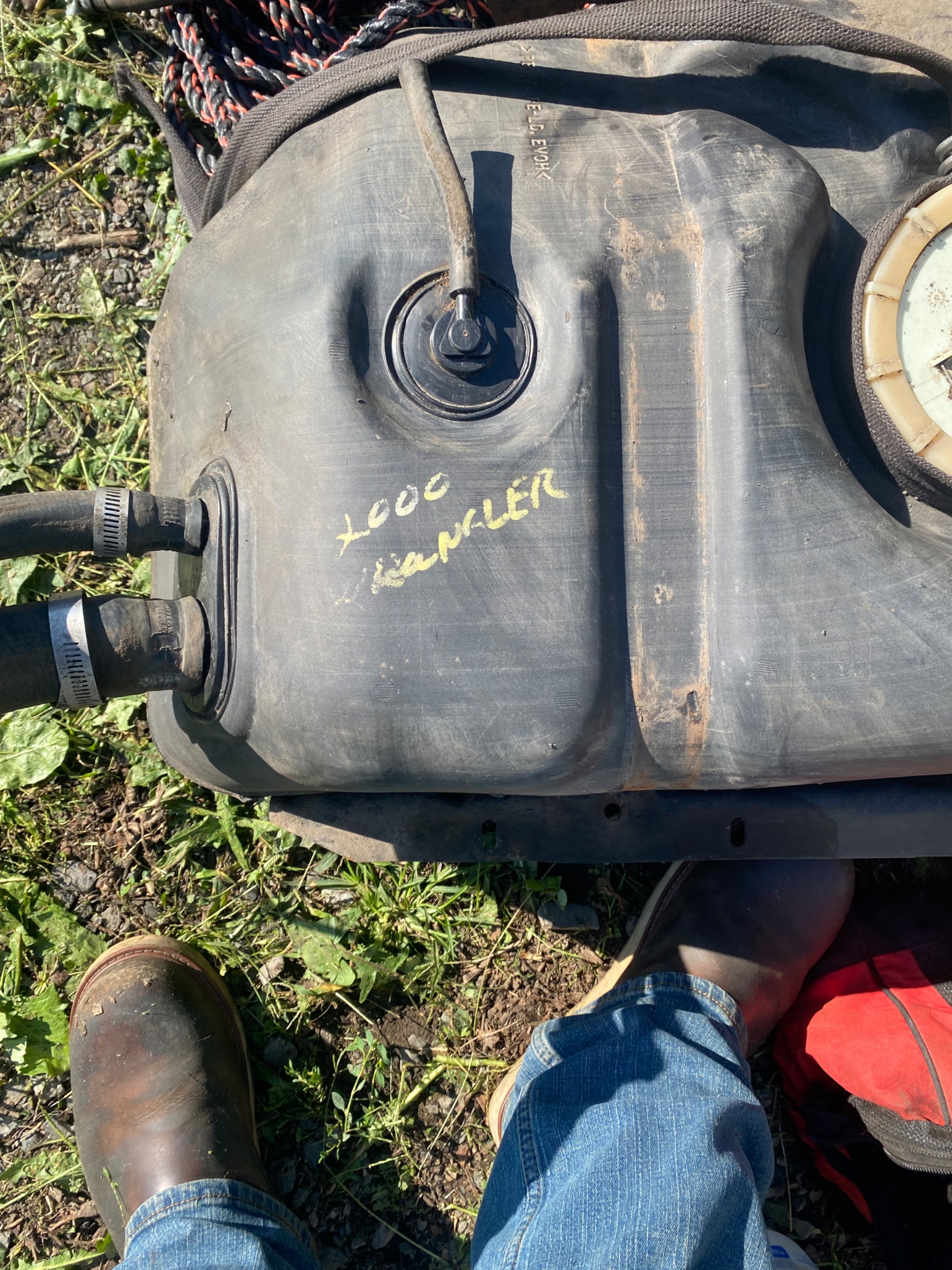

Anyone know how the two rollover valves are plumbed up? The one on the driver side was connected to a hardline on the frame rail but the passenger side just has a broken Y fitting but wasn’t connected to anything. The FSM doesn’t have a diagram that I’ve found yet.
Mine were like yours when I did my fuel pump. I got a tee and connected the two lines together and to the steel line. It's worked since 2011 , who knows if it's correct ....;)

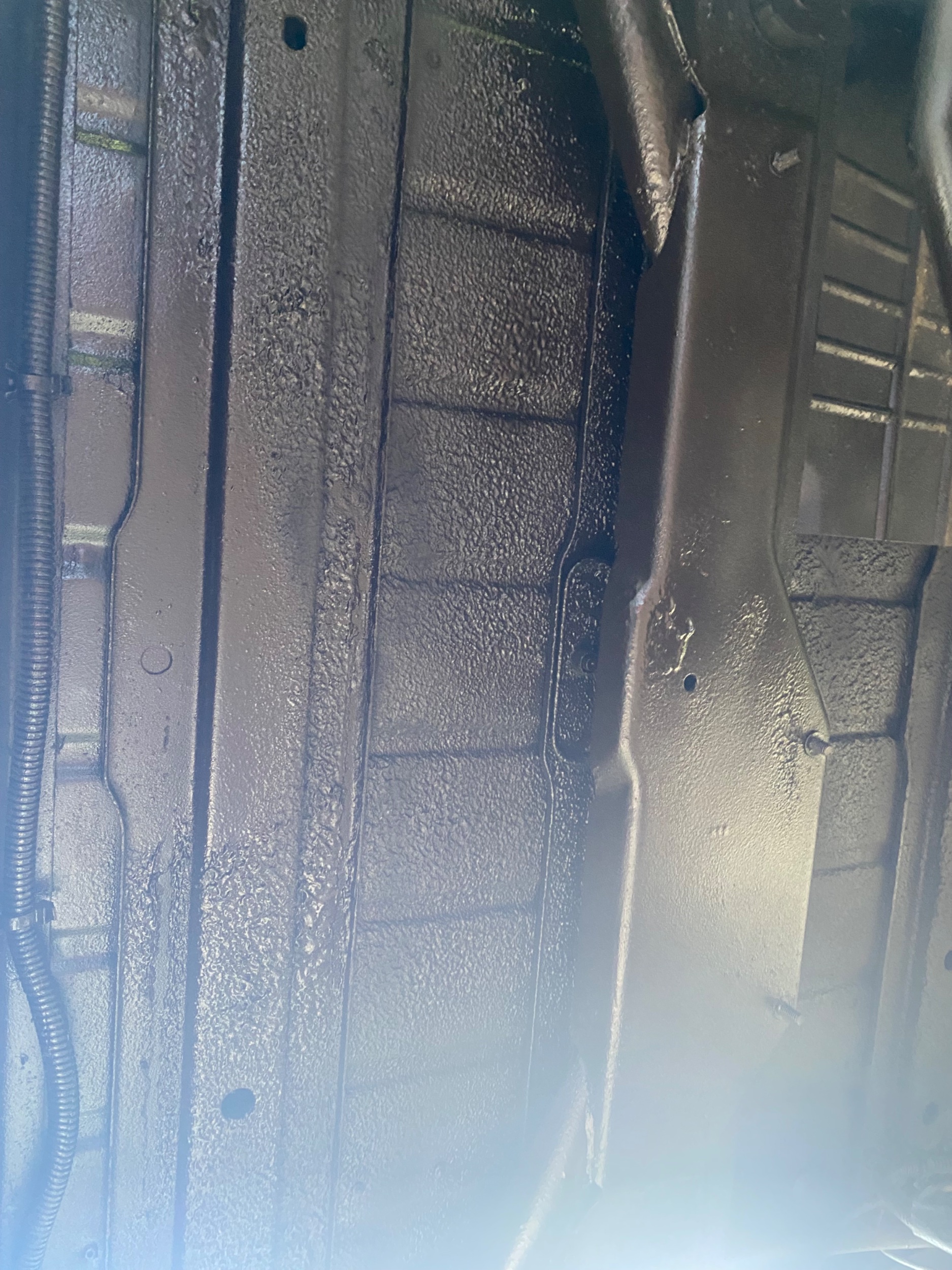

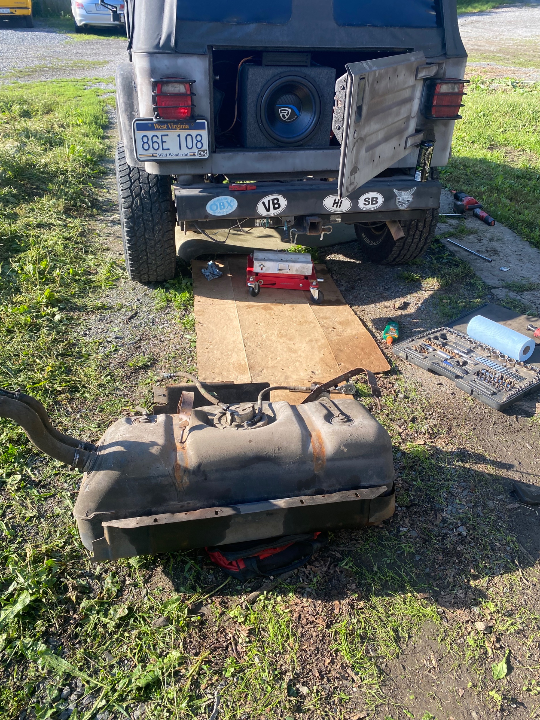

Got an early start on some much needed maintenance. Dropped the tank to swap the pump and skid. Cleaned up some rust and put some rubberized undercoating above the tank. So far so good. Hopefully this Napa pump will work for another 27 years. I found an open short on the ground wire that I guess was causing my sending unit to act weird at times. The vent hose is broken at the T on the passenger side so I guess I’ll get into the schematic and see how to fix that. I need a few new bolts as I snapped a few off while hitting them with the impact. Also it looks like the tank has been swapped out before because it says 2000 wrangler in yellow paint pen while mine is a 97. Hard to tell how many miles were actually on it but my odometer says 149k.
Please tell me about that jack
