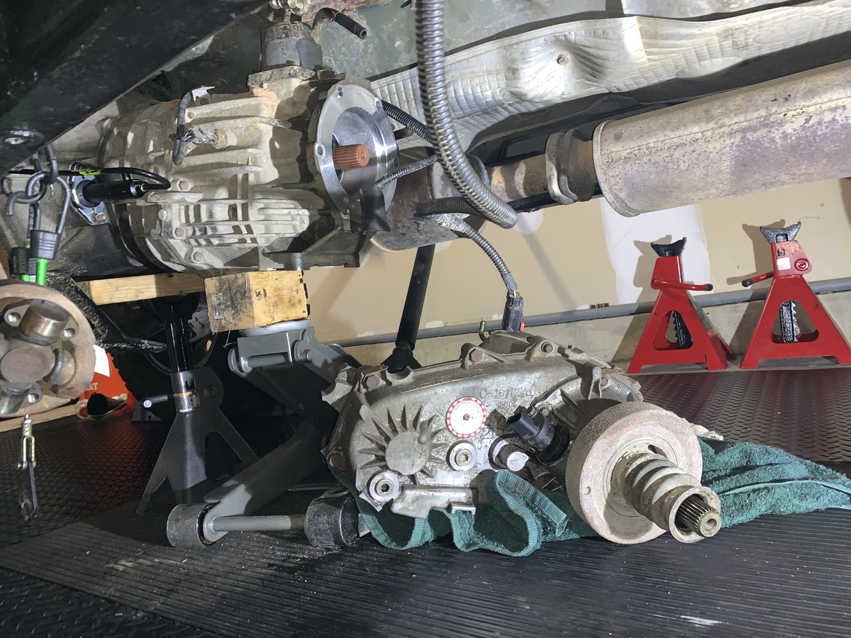

I used a hammer and a drift on the backside of the harmonic balancer close to the shaft turning it a bit every few wacks. Starts slow but it will come off.Pulled the transfer case out. Need to buy the 3 bolts needed to remove the harmonic balancer thing and a 1 1/8” socket to remove the nut from front drive shaft yoke.

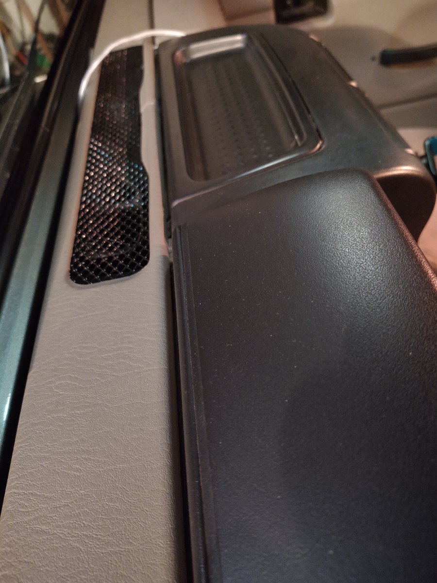

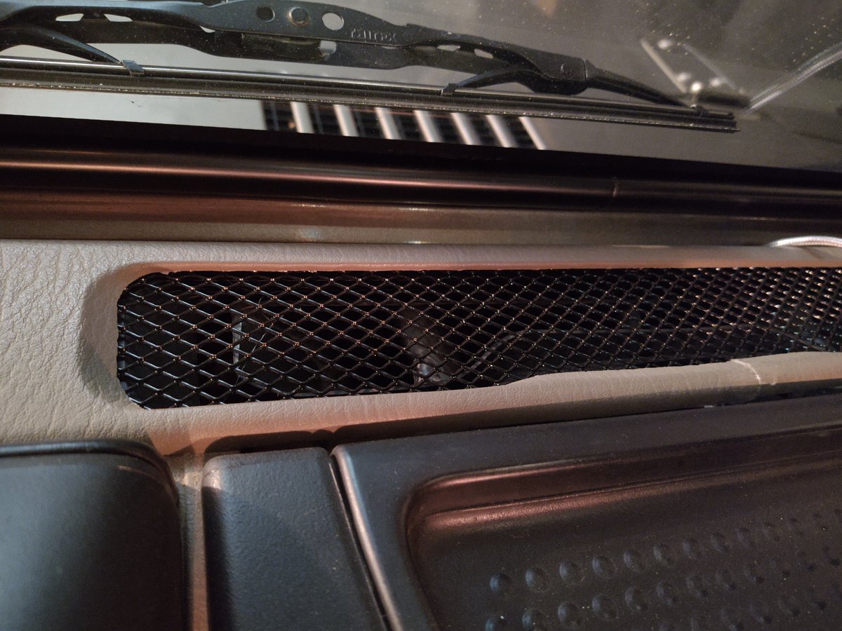

I had the same issue, so I bought a section of metal gutter cover, cut out a piece and hot glued it to the under/back side. Not only were the fragile vent sections broken but the thin solid part in the middle of the vent area was also broke.
I think it looks good and seems to work very well.

Uh why?Going backwards in life. Began disassembling my '99. Started with removing the bumper and winch combination. The front Dana 44 was also removed and replaced with a Dana 30.

Was it 1-1/8"? Shoot, i was just a hair off..Pulled the transfer case out. Need to buy the 3 bolts needed to remove the harmonic balancer thing and a 1 1/8” socket to remove the nut from front drive shaft yoke.

Yea 1 1/8”. But I had a slightly larger metric impact socket that worked fine.Was it 1-1/8"? Shoot, i was just a hair off..
