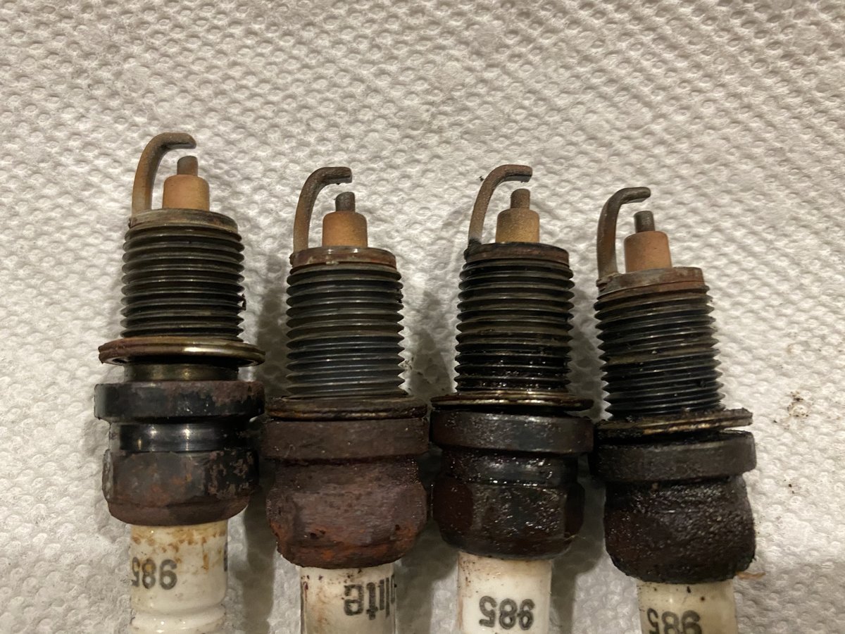

I’ve been lurking on this thread for over 2 years now. I even joined the forum in December of 2018 with the intention of posting, but I never actually got around to doing it. So this is my very first post, and I just want to thank everyone for sharing their wealth of knowledge, and their awesome Jeep pics/mods. I’ve lurked on the other forums, but those seem to mostly be filled with grandstanding and temper tantrums. On this forum, however, people will actually take the time to explain the technical aspects of Jeep mods, and no one shames anyone else for their lack of Jeep knowledge. For those reasons, among others, this is my go-to site for when I’m searching for Jeep advice on Google (I deadass conduct my Google searches with “WranglerTJForum” as a search parameter). I’m also fairly certain that @Kiwi TJ is my humour doppelgänger from down-under 😂 I am so happy that I stumbled across this site while researching seat covers one night when I was bored at work, and so grateful for all of the awesome people on it with their fantastic advice/Jeep mods. However, my bank account hates all of you 😡😂
Alright, enough with the sappy sh*t. These posts are nothing without pics, so here goes nothing:

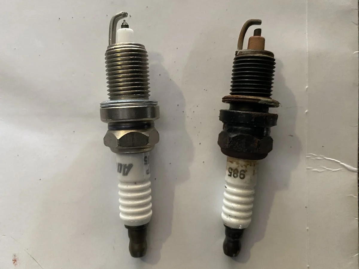

Again thanks to this forum and it’s excellent advice/parts recommendations, I changed my spark plugs, which hadn’t been touched in a while. The gaps ranged from .045 to .060 😳😳 3 of the 4 came out easily, the 4th was finessed out with some gently added leverage. All were replaced with Autolite XP985s (all gapped at .035), and Bandit the Jeep now seems to have a bit more pep in his step.

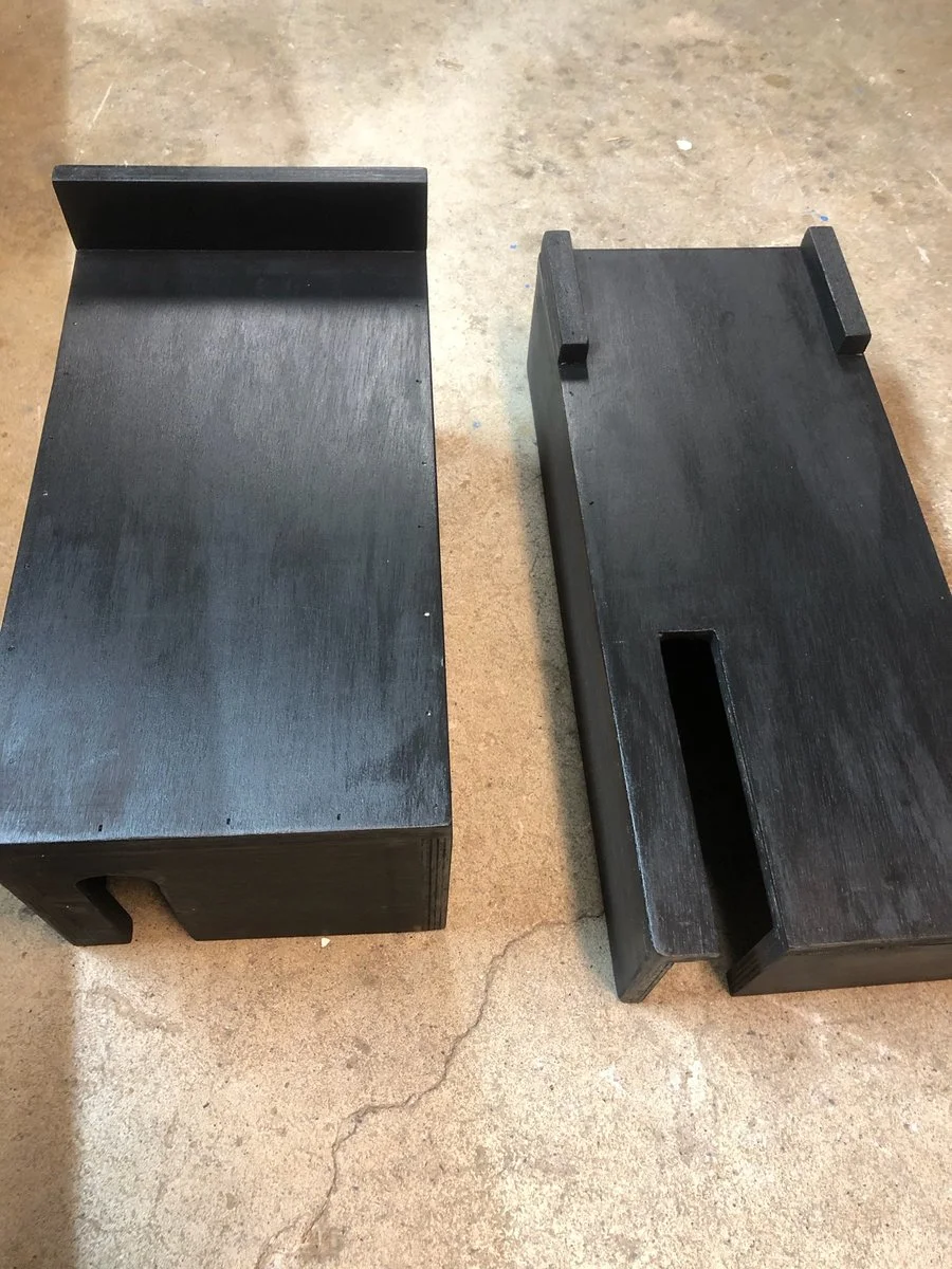

Picked up full soft doors, figured out the striker pin for closing the door and gave it a few coats of fabric paint. Speaker wire makes a great window zipper handle
Those look great! Did you clear coat the fabric after, or just black? I have a Set of 1/2 soft that could use a fresh look. I don’t ever use them but might throw em on.
Thanks. No clear coat just used fabric paint. I bought 2 cans and used one for both doors. I use the second can for touch ups or an extra coat if you wish.
