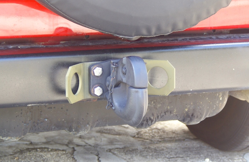

I bolted a pintle hook onto my rear bumper a few weeks back, but decided it just had to have the gen-u-WINE M-151 "G.I." chain plate to go with it. Standard parts aren't. Interchangeable parts won't. Chain plate's horizontal hole spacing off by 1/4", or 1/8" per side. Maybe tolerance stackup, maybe just a different spec between it and the civilian sourced pintle hook. Spent about an hour elongating the holes in the chain plate so it would bolt up. Too dark by the time I was finished to snap a picture.

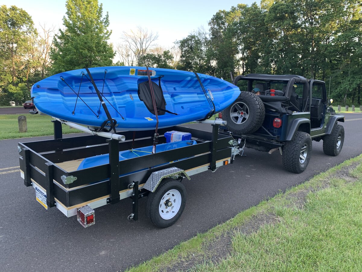

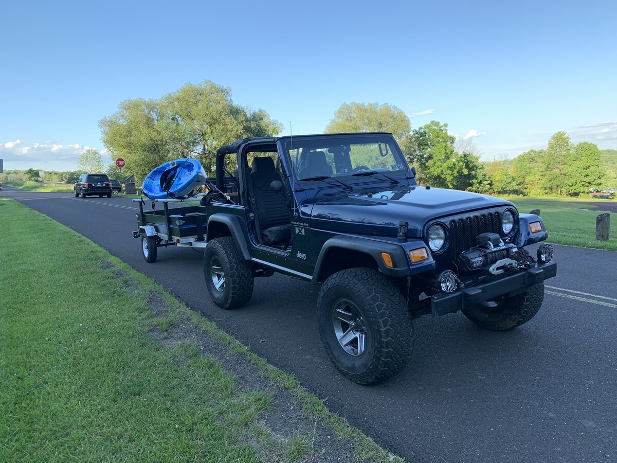

Not today but over the weekend, the TJ towed for the first time. My freshly built kayak/camp gear hauler (not as cool as these off road campers but works for me....and can be used for other household chores). I’m a noob to towing anything so all the bangs and loud noises and potholes make me nervous lol. Don’t want to see my kayak rolling down the road in my rear view mirror
Quadratec wheels?
The trailer looks good. (y)
Reactions: jazngab
What brand of trailer did you buy and how much did you pay? Great looking rig !
Reactions: jazngab
That's a nice looking trailer. It's similar to my folding trailer based on the roller wheels behind the tires. I take the back and sides off of mine, flip the back over and tilt it up, then push it against the wall in my shop.
It started as a used harbor freight trailer I got off cragslist for $100 and ended up like this after making the sides and adding the flooring. A spare I mounted under the back, a jack on the front, and bearing buddies rounded it out. I used old door hinges and nails as pins to hold the wood sides together at the corners
Here's the current version of mine, https://www.harborfreight.com/autom...x-96-in-super-duty-folding-trailer-62647.html but the guy I bought mine from towed a 3 wheel car to shows on it so he added twice the number of metal cross member supports and the manual winch to get it on the trailer. You can order extra parts directly from the factory. So my beefed up version will easily hold more than 1,700 lbs. You can see the spare I mounted under the rear license plate. I never travel without a spare and extra wheel bearings. The 12 inch tires and bearing buddies help with bearings.
The whole setup rides so nice I forget it's back there if I don't have something sticking up to remind me there's a trailer there. I have a Reese Outfitter Adventure System bike rack that holds four bikes and has a pass through hitch for the trailer.

Wow, I was today years old when I realized it was "pintle" and not "pindle" because I've only ever heard Arkansans say it. 🤣 🤣 🤣
I was today years old when I learned that people who live in Arkansas are called Arkansans 😂😂
