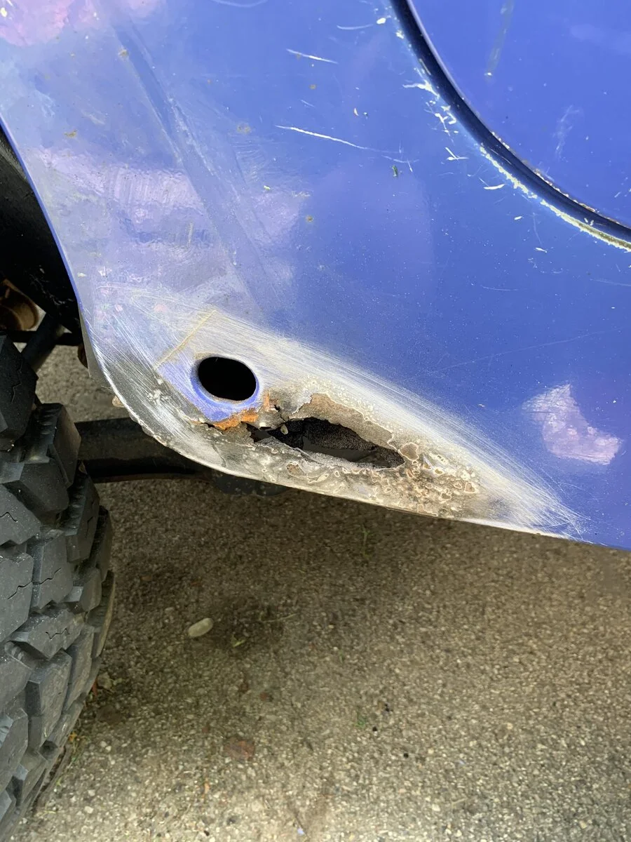

Today was rust hell...I mean hole... repair day. Came out pretty good for this being my very first attempt at body work and the touch up paint I got from Touch Up Express was a really good match. Their customer service was on point too after my first shipment got destroyed by the USPS.
View attachment 178542View attachment 178543View attachment 178544View attachment 178545View attachment 178546
Be sure to paint it well from the other side too so the bondo does not absorb water and so everything is nice and sealed.

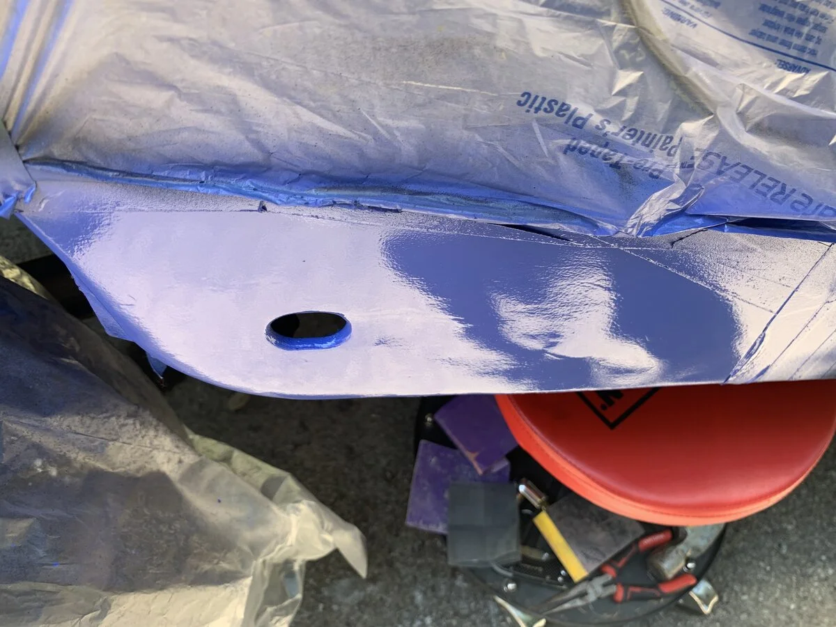

Did my own body work for the first time ever. I’ll eventually get the whole tub repainted, but I found some rust holes after taking my fender flares off. I had the first one I found welded with a patch, but even though it was going to be covered by the new flares, but then I found another one and decided to go the Bondo route instead. I also had some spots where the paint was bubbling. I cleaned them up as best I could to expose the god metal and grind away the rust, and then I patched them with Bondo. It was.... messy lol. But the job got done. I then primed and painted the areas, and added clear coat. I still have to wet sand and polish, and I have a few areas where I was a bit heavy handed with the clear coat, but I don’t think it was too shabby for my first time doing it! Hopefully I can finish up today before work, and then wax it, add on the rocker guards and flares, and a set of matte black American flags that I have been waiting to put on for a while now.

You have possibly already discovered this, but you should not wax new paint for at least two weeks. Before that, it is still soft and the wax it likely to goober it up and, if not, you would be sealing it which would not allow the paint to continue to cure...for a really long time.

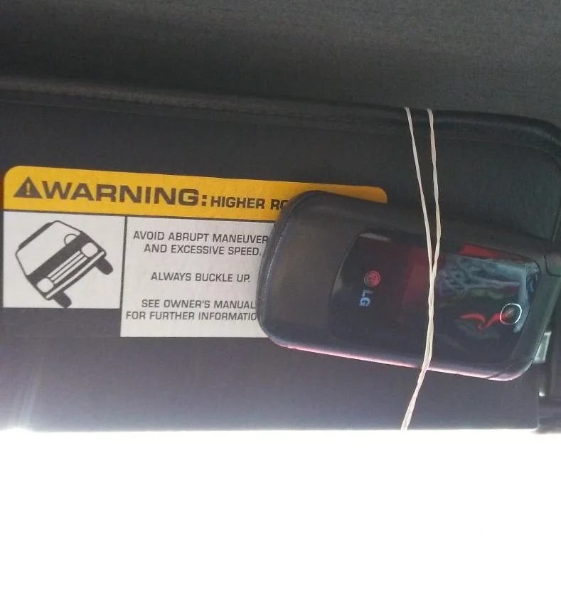

Got a new "old school" cell phone holder. Works better than the old stretched out one.:)

@TJ Hunnicutt where were you 2 days ago? 😂😂 I appreciate the advice, and I’ll keep it in mind if there’s a next time (hopefully there won’t be). I’m not too concerned about it though, it’s a temp fix until I have enough money to pay to have the whole Jeep repainted by a legit auto body shop, but this will do in the meantime. Also it rained buckets right after I waxed it (gotta love hurricane season 😂😭) so all of the wax probably washed away anyway.

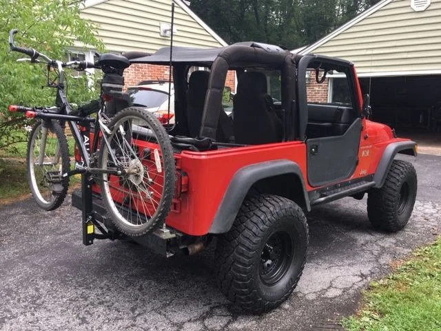

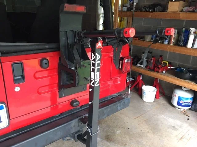

we've been riding bikes a lot more this summer & a few weeks ago I borrowed my son's bike rack for a day out with the girlfriend & had a blast. Last weekend we crammed both of our bikes into the hatchback which worked but sucked in a big way, so I ordered a two bike rack version of the 4 banger my son has on Wednesday for $99, the brown truck dropped it off yesterday.
popped it on the TJ last night
celebrated with an olive oil tomato pie & some coldies :LOL:
just went outside & put the bike on, heading to the girlfriend's for a ride around her hood
man I really need to bang my bumper back into shape & get a new cap on the end, damn rocks always popping up out of the trail
