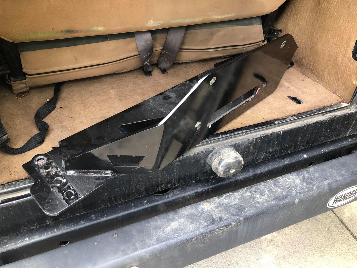

The other day, I found the exact Warn winch mount for my 8274 that Warn made specific to the TJ. The only problem was that it was about 300 miles away in SC. What a man won't do to save a buck. LOL!!
ROAD TRIP. Even though I peeled out at 4am, my daughter wanted to tag along, so of course I was stoked to have her go.
A 16 hour day, with a side excursion to hike at Tallulah Gorge in Georgia, I now have what I need to mount up my winch.

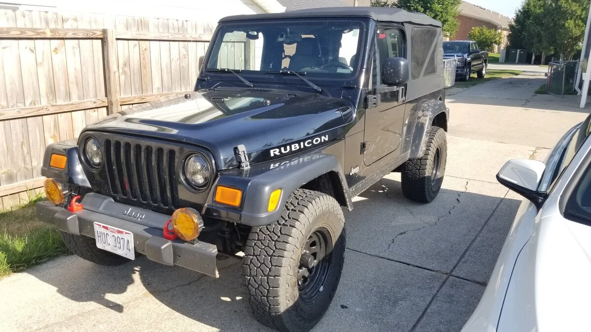

About a hour into my 3 hour drive home, rocking out to some AC/DC and the cruise control kicked off. When I looked at the dash I noticed the dreaded check engine light was on. I pulled over and tried that code reader trick and I got the P0016 code. That's surprising to me seeing as how I had that problem like 6 months ago and it was supposed to be fixed😑 So off to the shop tomorrow for the LJ
But for some positive news is the PCM from Wranglerfix has almost 1200 miles on it without a hiccup and the Falken AT3W tires were great! Now its time for a good cleaning.

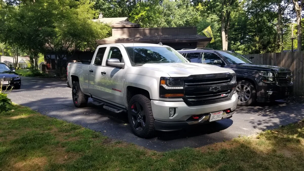

My other vehicle problem is with my 2017 Silverado. Let my brother drive it to Houghton since we had to haul a lot of stuff up there. Nobody drove it for a few days but when I went to start it I got nothing. Tried jumping it and it fired right up. This has happened once before after having the dealer replace the injectors and they claimed they fixed whatever caused it the one time. Looks like the truck will be going back to dealer soon🤬

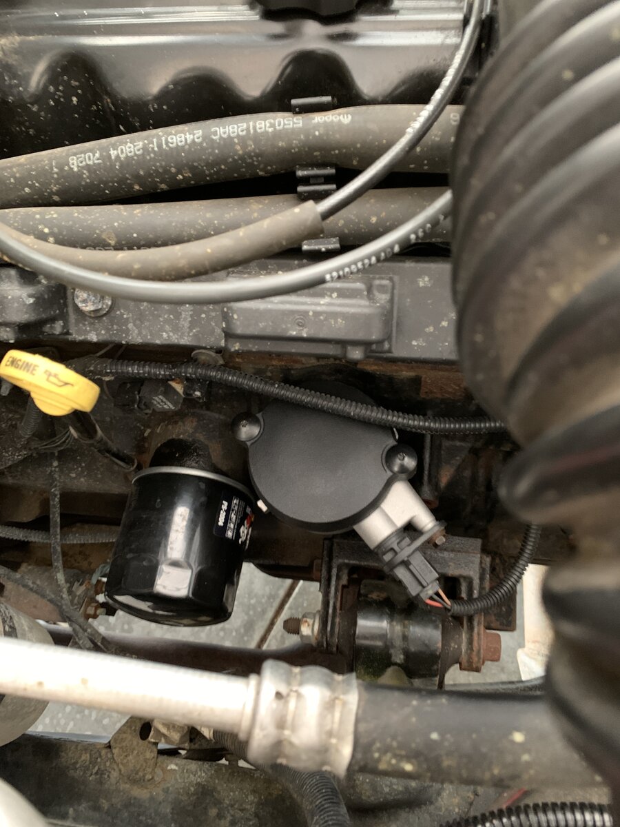

The saga of the misfire p0203 continues. Insulated the 3rd fuel injector with the recommended product and wrapped the rest of the injectors + fuel rail with the whole DEI Heat Shield kit for the heat issue. Pulled the throttle body again and clean up the IAC (3rd time throttle body has been pulled and inspected/cleaned). Also did a PCM reset but problem persists. New Mopar IAC ordered.
Summary of whats been done - spark plugs 2x, coil pack, all o2 sensors, Mopar TPS, 3rd injector swapped around and insulated along with rest of injectors + fuel rail + shield above manifold, throttle body pulled and cleaned multiple times + new gasket, PCM reset.....and still a p0203, misfire on braking, idle seems inconsistent and a bit unstable. All this started after new 02s, cats, and exhaust were bolted up. If I had to put money down I would say vacuum leak, but IAC is the dark horse fix, Im hoping!
