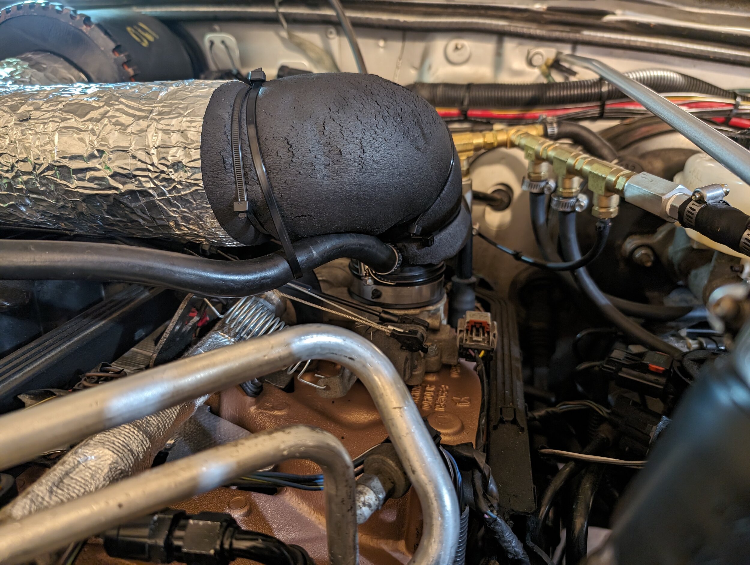

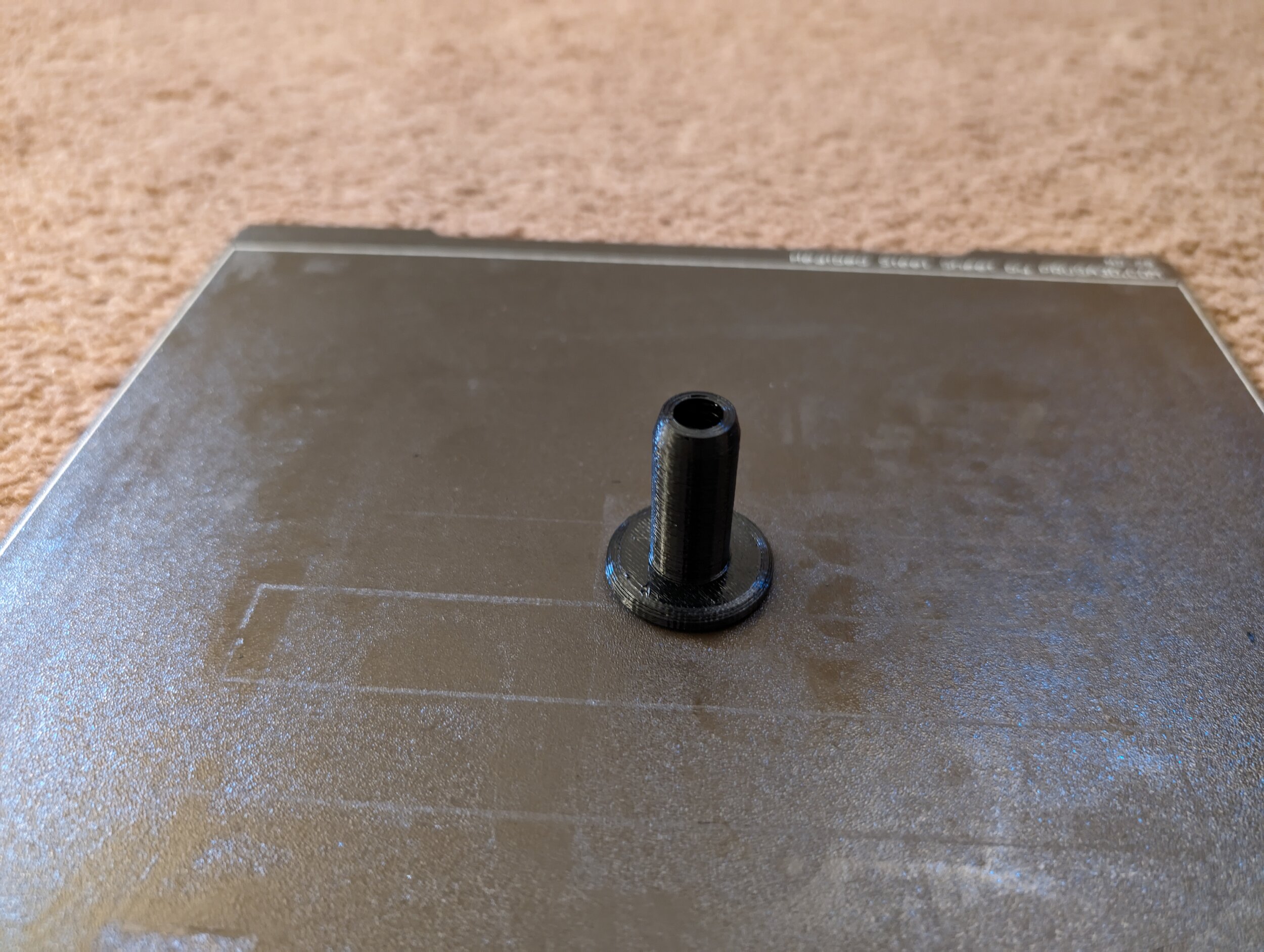

Intake adapter nipple for the crankcase ventilation intake.
Quick and dirty solution until I can print the entire intake tube.
Printed in Lexan filament (unblended polycarbonate) on a hot rodded Prusa like most of my other stuff.
Nice. Do you have a file you'd care to share (or sell) over on this thread?
I’ll see if I can upload an STL later.
Literally just three circular extrusions and three chamfers. 32mm OD base 4mm high, 14mm OD stem about 32mm long, 8mm center hole, 1mm chamfers on the base, 0.5mm on the transition, and 1mm 75-degree chamfer on the tip.
