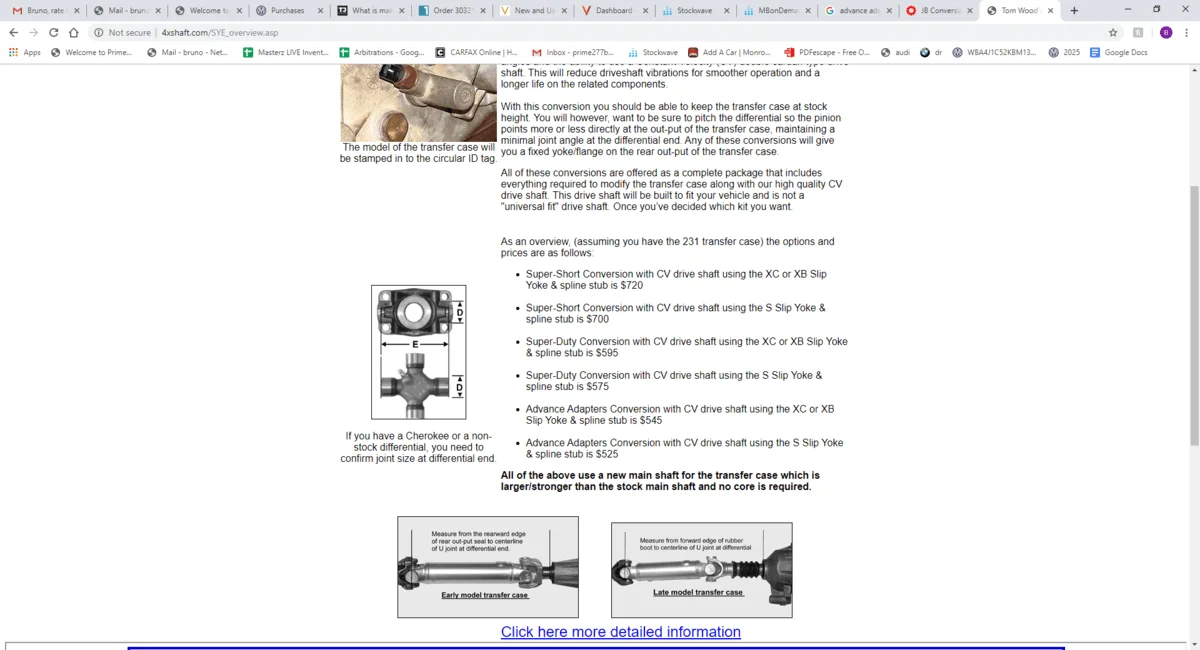

This is what I am looking at, and I have no idea which one to get
Call up Tom Wood's, they will happily recommend everything you need and probably set up your order over the phone.
Reactions: JMT
I recommend JB Conversions super short SYE Part #16-1201-1945
https://www.jbconversions.com/products/sye/np231j_short_sye.php
You will have to measure the length for the correct driveshaft. Plenty of directions here and Tom has been doing this long enough that he would help you easily.
http://www.4xshaft.com/TJWrangler.asp
This setup would change your gear driven speedo to a tone ring/hall sensor. You will need a speedo healer to correct it. Luckily this writeup just happened a week or so ago and details exactly how to make one.
https://wranglertjforum.com/threads/how-to-make-a-speedohealer-harness.27169/page-2#post-444092
The folks at Tom Woods can talk it through with you - just give them a call, they were really helpful when I was ordering my rear shaft.
